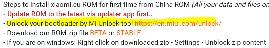

Hi! I read the guide and I don't see anywhere any information that you have to unlock bootloader - why? Is it necessary or not?
Thanks. Still it should be in guide, because in some they write about it and it can be slightly confusing :)
Its in the guide...
36951
Reading and understanding is hard ;)
Its in the guide...
Exactly, maybe that's why you should learn to read and understand :)
I posted here for a reason, I wanted to install TWRP and ROM and here is all the instructions EXCEPT the info that you have to unlock the phone. Especially as it was mentioned in the "old method". Which means for any thinking person that in the new method it is not necessary!
Installing Twrp Recovery
1. Before starting the process, the bootloader must be unlocked.
So in the old method it is necessary to unlock the bootloader, in the new method since it is not mentioned anymore - it is not, right? Maybe something was invented to bypass this, maybe Xiaomi made something easier? How would I know this if I don't sit on the forum day in and day out?
So maybe without pinching, because the question was right from my side and reasonable, and I do not see the need to read other guides, if in theory this one says everything.
