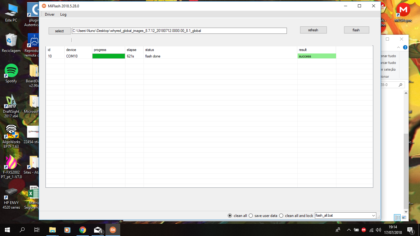

It worked :D After 10min flashing, the phone is back to life :p @ingbrzy

yeaaaaaaaah THANK YOU VERRY VERRY MUCH Nuno Rocha you saved my phone and my life!!!!!!!!! the rusian forum are on the top thanks too:p;);)
just a question ,could i flash coustum recovery and root as befor?

Of course you can install twrp and root. Anti roleback is only for older ROMs. Nothing to do with custom recovery and root. :) Shame English (or Indian...) Forum has no thread like the Russian forum has. That thread was a miracle.
