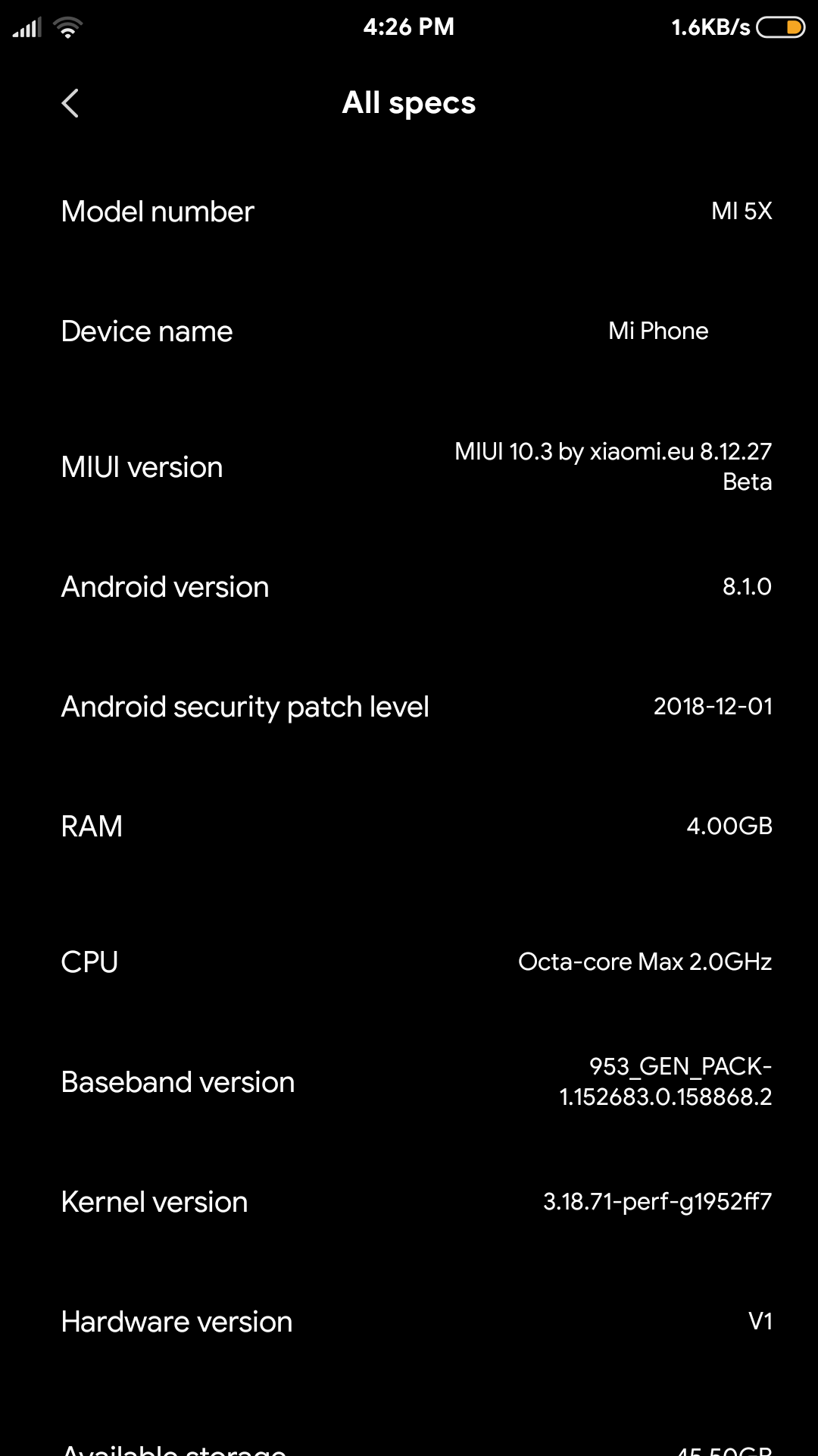

I was just going to flash the newest version. I'm on 8.11.1, how can I update to 8.12.27 avoiding any problems? Can I get the black screen even if I make a clean install?
If u have problems check my post - https://xiaomi.eu/community/threads/last-8-11-15.47670/post-461006
You need update Twrp 3.2.3 Tremble - https://drive.google.com/file/d/1xggD0fntmpniyIrjPfizE4D6D2AdwJJX/view
This version is the only one who supports Oreo rom's.
And after that u can install the new one, i recommend a clean install, and yes u can get black screen.
This worked. I was able to update from 11.1 to 12.27 with no black screen. Thank you.
