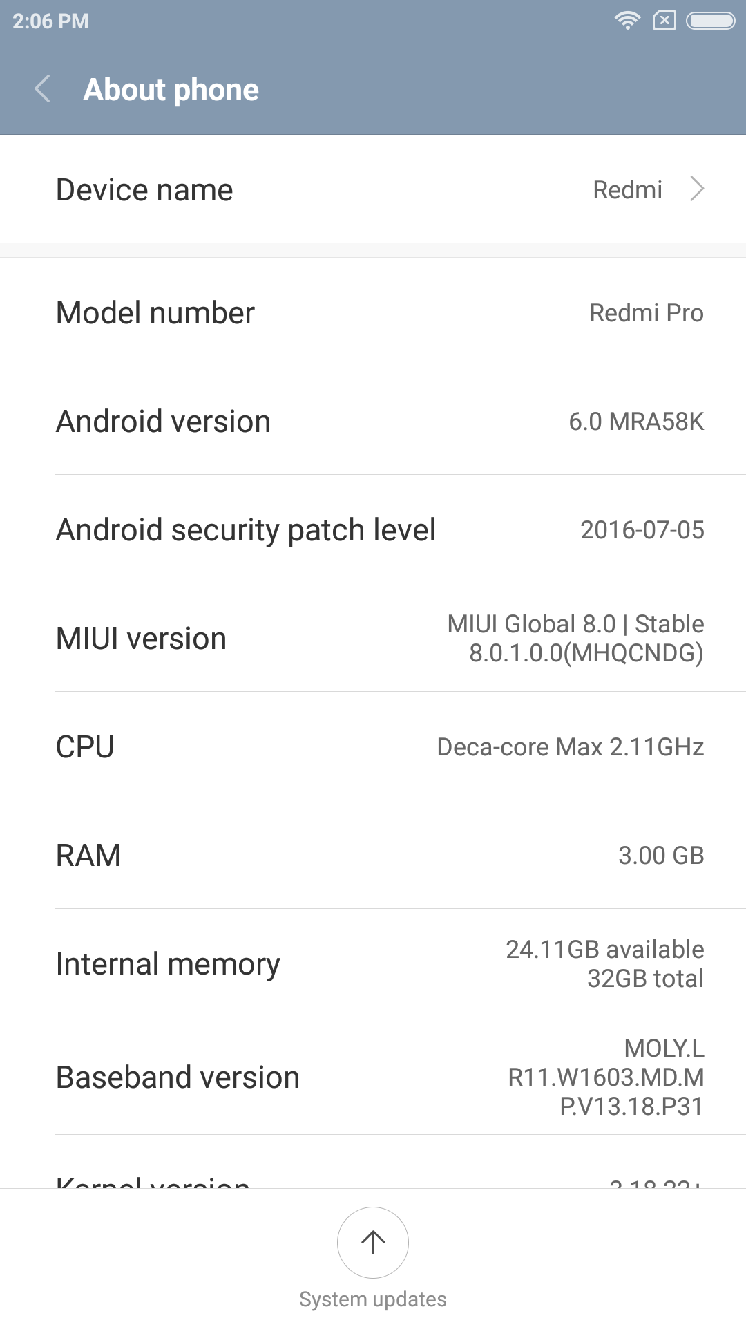

Hi, i have a new redmi pro, trying to install the eu ROM unsuccessfully till now.
My phone arrived with a custom ROM (a screenshot attached).
It seems like the phone arrived with the bootloader unlocked (and correct me if i wrong) as when i execute "fastboot flashing get_unlock_ability" i get "true".
Therefore, i thought it would suffice to flash TWRP and install the ROM.
I flashed TWRP, but As people told me the phone may get bricked, I decided to "do it right" (install the chinese dev ROM, request for an approval and unlock bootloader, and install the new ROM).
Iv'e got the approval to unlock the bootloader, but now i have the following problem:
When i try to update to the chinese dev ROM with the updater, i get the error "can't verify update".
I thought to try flashing with SP flash tool, but didn't find a fastboot ROM for redmi pro.
How should i continue from here?

You DO NOT NEED a dev rom for unlocking. And also You Cannot flash a official package with recovery...you will always get that msg. Simply just install neded drivers (use windows 7 64bit machine or win xp) go to fastboot, download the mi unlock tool and hook up ur phone and it should work. Then just follow the instructions on how to install TWRP and it should work.
Personal Advise: Use stable xiaomi.eu rom for Redmi Pro. The other weekly roms have a real battery drainage problem and until it is fixed..stay away from weekly
