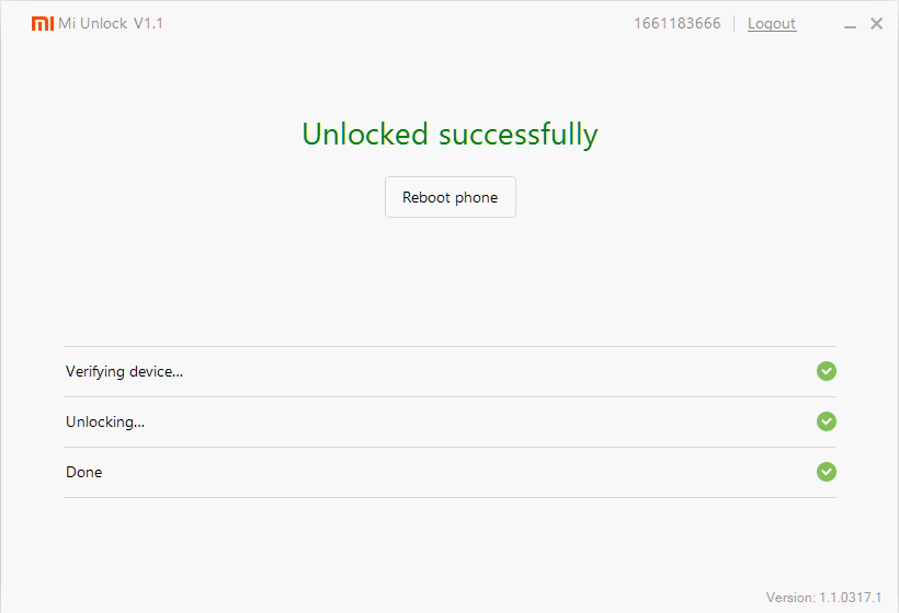

I really want to unlock my bootloader so I can install a custom recovery then to try different custom rooms.
I already apply for unlock 10 day ago but didn't receive no sms or whatever, can anyone here guide me step by step for what to do and how an I prepare my phone for this?
i thik i unlocked my bootloader, what now?
You had vendor rom and you just got bootloader unlocked :) now use adb commands and flash twrp. After that use twrp, clear necessary data (Dont clear Sd card!!!!!!!) And then via twrp flash xiaomi.eu :)
