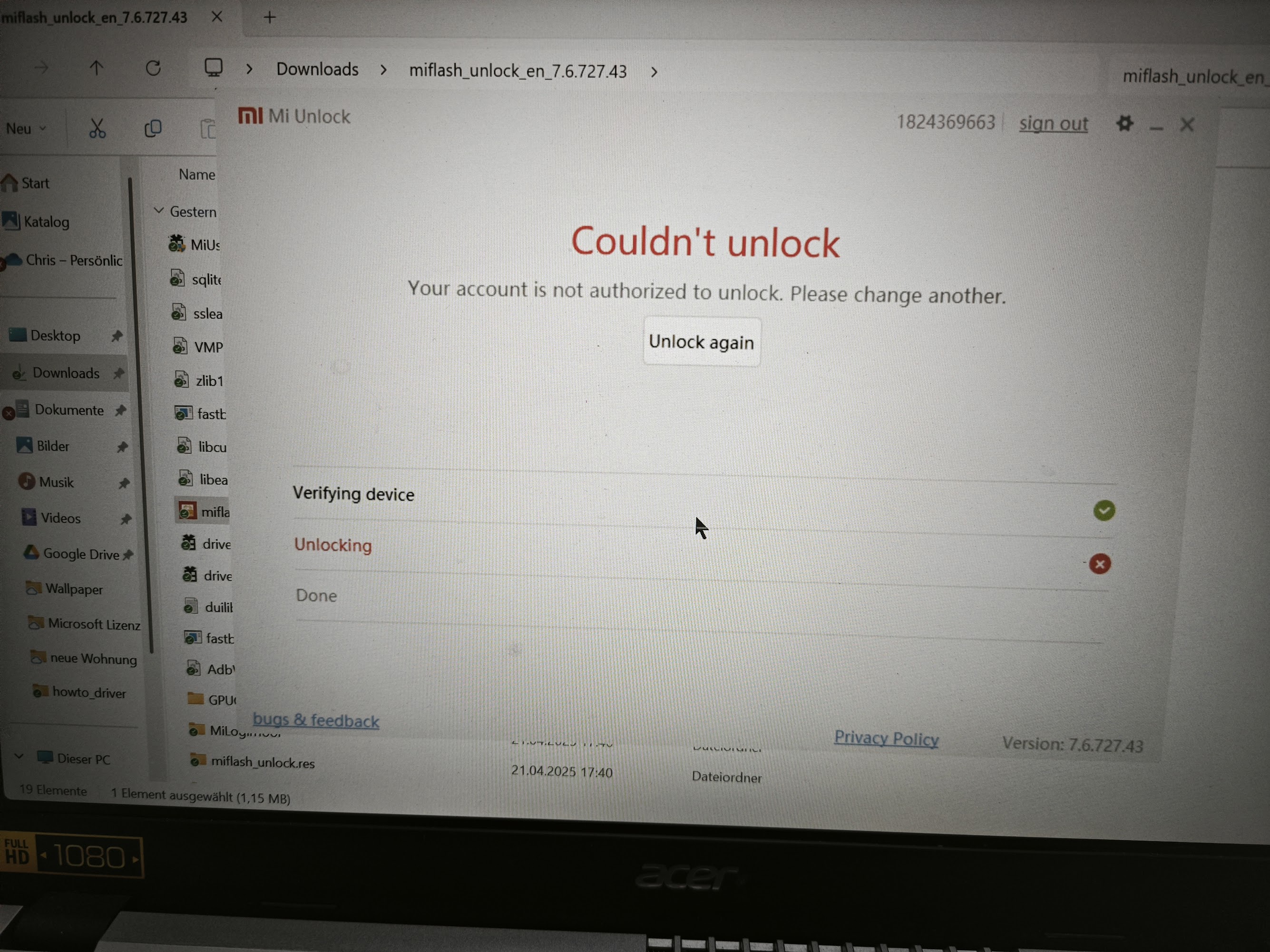

Hi! Unfortunately, the unlock didn't work! I logged into the unlock app using a QR code because I didn't receive a confirmation SMS. Then I put the phone into fastboot mode and then pressed unlock.
Hi! At the moment, due to this type of error, you can't unlock the bootloader from this (your) account. But you can create a new one (even with the current phone number), wait 30 days and repeat the procedure.

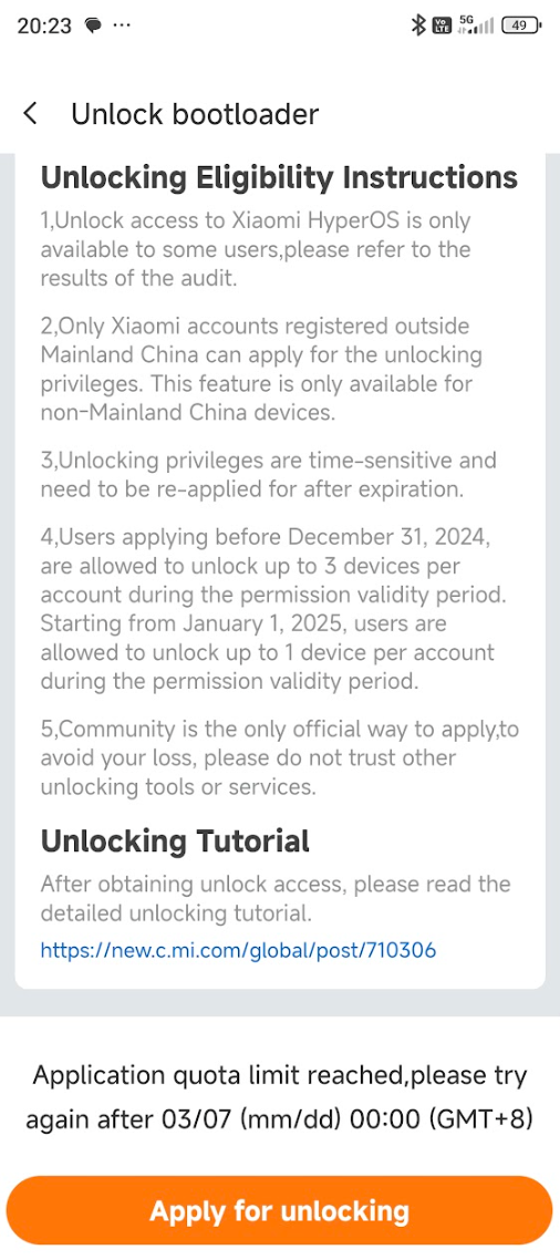

Unfortunetly I have same issue. Today I received my Xiaomi 15 Global and when I try to request for aprove via community app I receive information "quota limit reached"
I even tried exactly around 1min after midnight china time. :/

But you have permission in mi community? Otherwise, it'll never work. Your Xiaomi account must have an unlock permit. That account is checked on the phone and in the Mi Unlock. If that account doesn't have permission it won't let you unlock it.

It's just that it doesn't have to work. What he's tellini you doesn't make sense. Whenever you try your luck with mi community, you have to link the device and try my unlock. But it doesn't just unlock itself. It unlocks because your account has permission and isn't correctly indicating it in mi community. If you click the button in my community and get permission, but it's not reflected correctly in the app, my unlock will work. If you click the button and don't have real permission in your account, my unlock won't work.If you can't get permission like many other people, talk to me privately and I'll help you with a free script... but the more people use this, the fewer people will get permission because it's limited, but oh well.

I am also trying my Xiaomi 15 european model... Tried with old account which still unlocks fine my Xiaomi 13 but the 15 cannot be added in developer menu. Tried community request but every day it says to try the next day 00:00 gmt+8...

Yes i am trying more than once per day.. i get always the message that i have to get authorization from Mi Community... Maybe except the account age, phone device should get some days old.. Mine is just a couple of days active... I'll keep trying... But even if i unlock i am not sure what to do anymore.. :( no way probably to have payments & call recording active...

Try to link account, the message is coming if u have unlock permission or not
There are scripts which presses at the right moment for you for application, is working for most people
