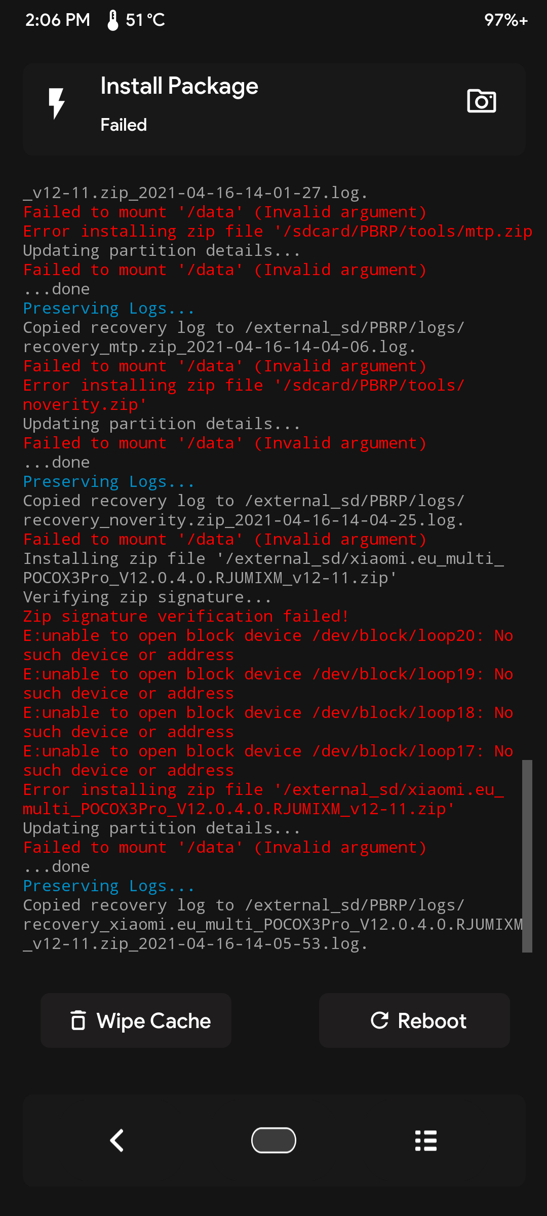

I need some help please installing xiaomi.eu rom on poco x3 pro.
I unlocked bootloader, installed pbrb_test3 from here:
But everytime I try to install the zip I get this errors attached.View attachment 36060
You see those errors because this recovery isn't capable of mounting the data partition (and AFAIK, right now, there's no such recovery yet). I don't know about these mtp.zip and noverity.zip files, but as far as xiaomi.eu goes, you can ignore the errors. Just remember to *format* data (not wipe) before booting up into the new ROM.

The Problem is, that xiaomi.eu file has not been installed. As Screenshot shows: error installing zip file...
TheReduxPL
Sep 14, 2013
44
30
Flash only the xiaomi.eu ZIP file and nothing else, and do not change any of the checkboxes that show up before flashing.
If you still get the error, I would try downloading the ROM again, it may have downloaded improperly.
