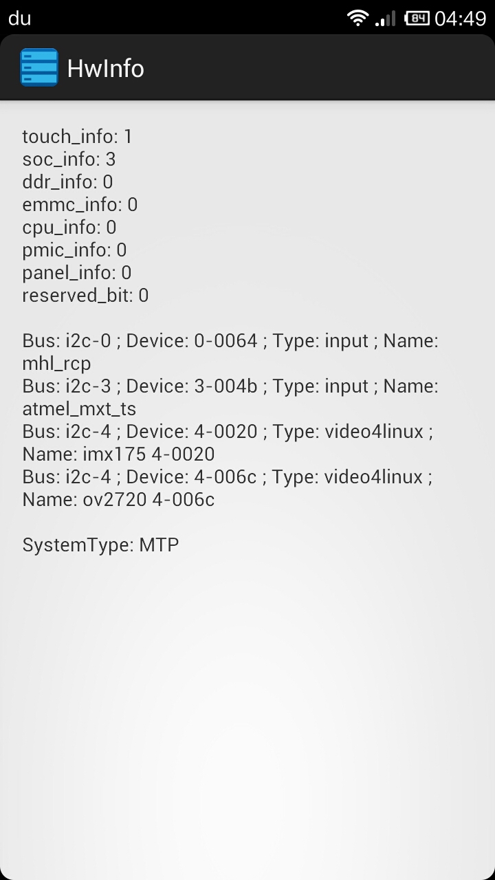

post: 168295 said:Can u please dump info with this app?
http://miuiandroid.com/community/threads/app-2013-06-12-hwinfo.20825/
I want to know if there are more differences than just modem.

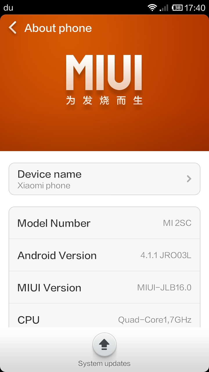

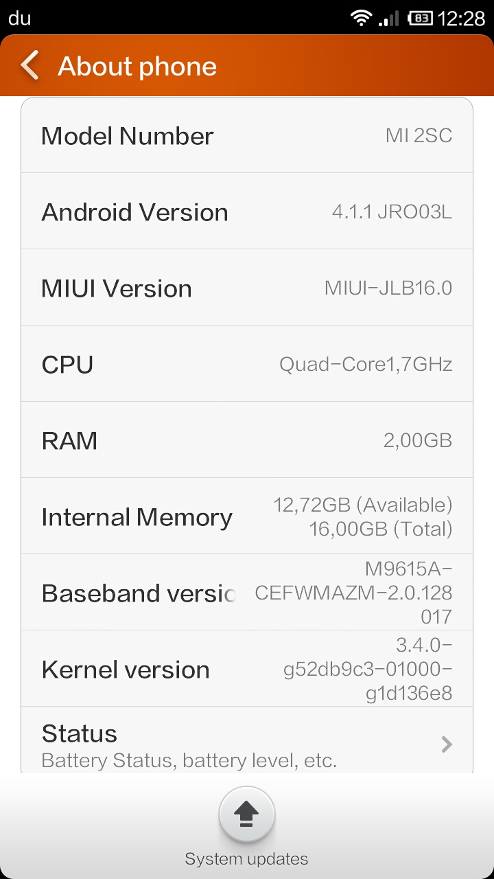

Hey Nemo,
I just received my second phone. I ordered the Mi2S but received an Mi2SC.
Did you noticed some problems or differences between the "regular" Mi2S and SC?
