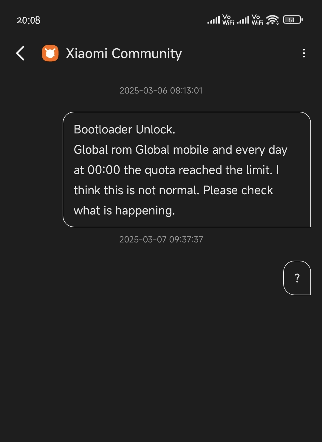

i have had the phone since march 5th, i have tried every day at 00h gmt8, super punctual, to apply for permission in the community, i have level 3 user, and i can't unlock the phone, with the xiaomi 14 it was much easier. i am starting to think about returning the phone, i have had 8 xiaomis in a row and i have unblocked them ALL when i get home to use ONLY xiaomi.eu.

another day, applying for permission to unlock in the xiaomi community app, at 00h00m00s and limit quota....
i only have 4 more days to return it if they don't let me unlock it,

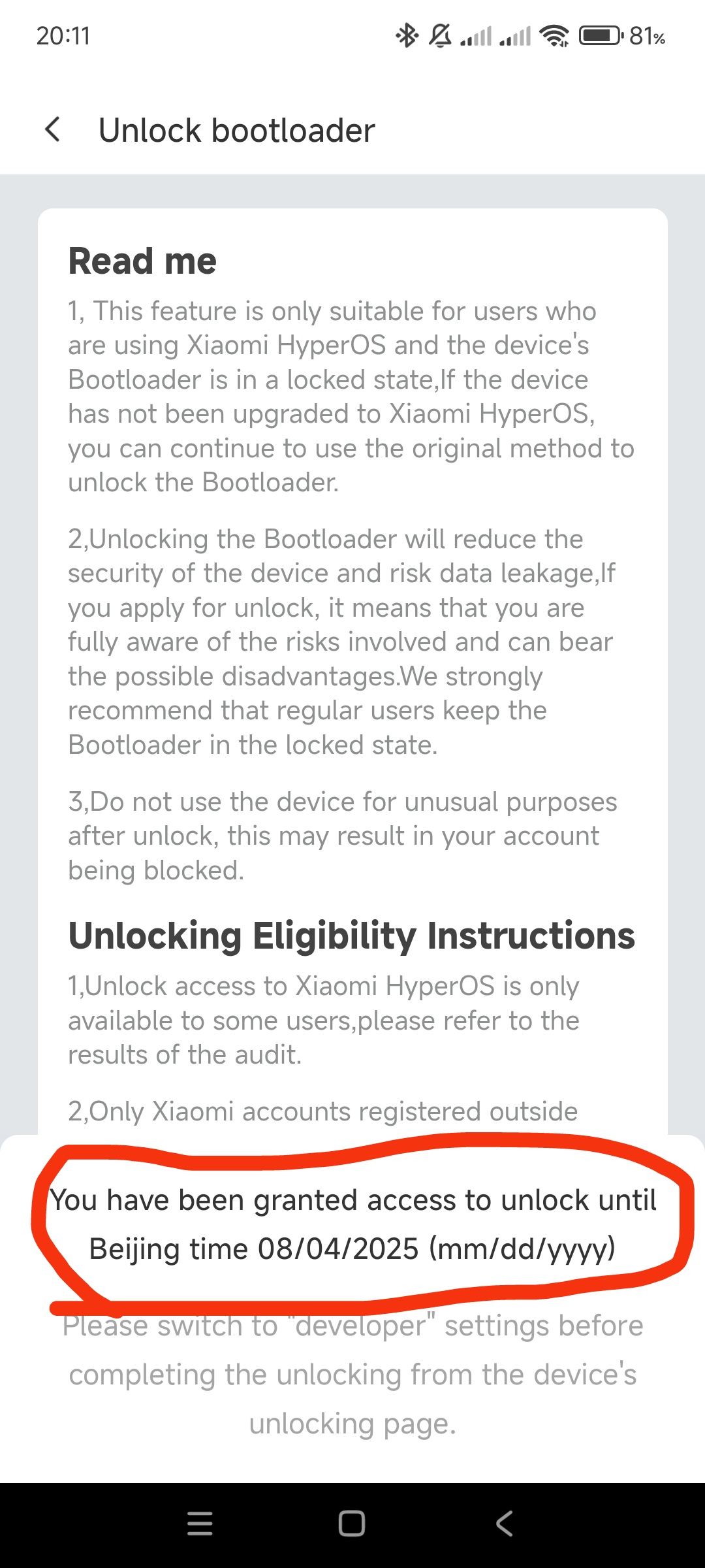

I just realized I have this in my Community App. It says I am granted to do unlock untill 4th August 2025. Does that mean I can go now, buy Xiaomi 15 Global and do bootloader unlock straight forward without any waiting? Thanks
Just in case someone wants to try as well. I could unlock the bootloader in 2025 even though the access was granted in 2024. I am sending this because someone on XDA forum was saying it is not possible. So it is possible

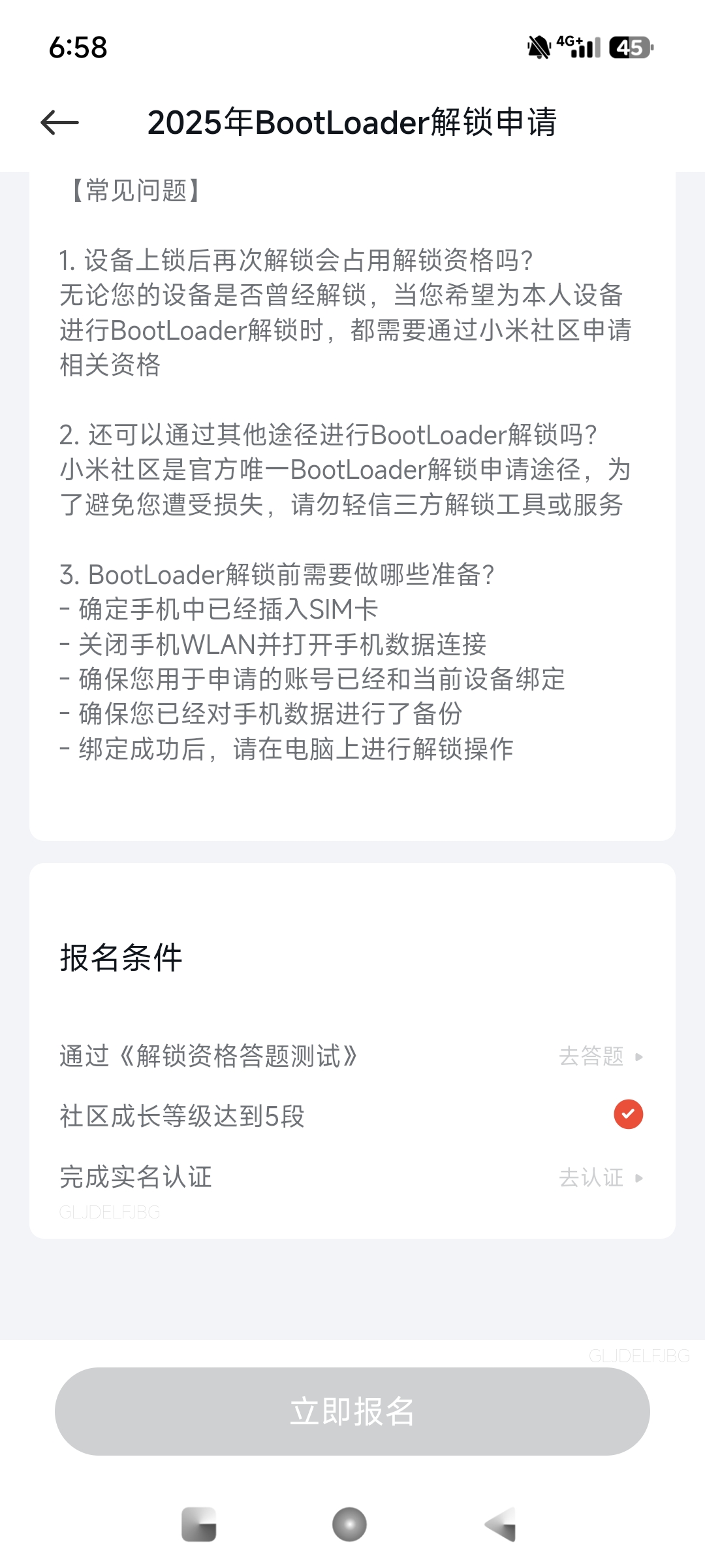

I have a level 6 xiaomi account for the Chinese version xiaomi 15 pro.. I don't have any documentation or id though because I'm not from there any advice or help from someone that wouldn't mind.. I won't be using the level 6 account after it's unlocked anyway so..
