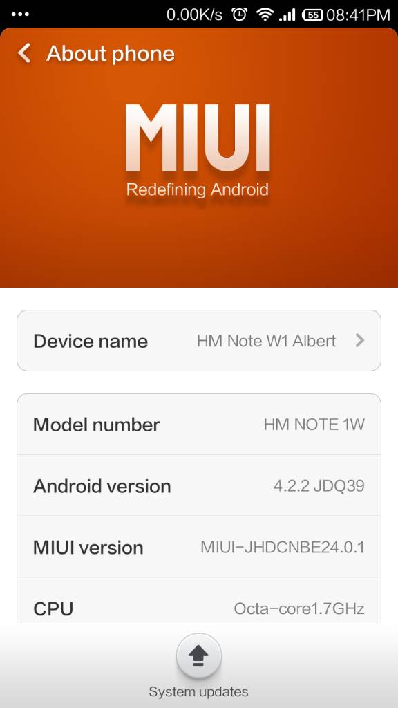

Goto setting, about and it will shown:
Sim card 1 will have wcdma marking.
