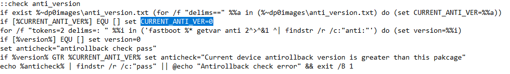

I tried to install a global Xiaomi rom site, but I had problems with the TWRP.
I wanted to install an official version with miflash, but I have a rollback problem.
My phone is in version 1, and the official roms are in version 0.
I don't know what to do anymore, would anyone have a solution?
Version of my phone:
32604
Version of the latest rom found:
32605
sorry for my English

What is the problem?
The line you marked means if the variable is not defined set it to 0. also there is a check for it just 4 lines after that.
For example the following:
Code:
echo setting variable to 0
set CUR=0
if [%CUR%] EQU [] set CUR=2
echo %CUR%
echo removing the variable
set CUR=
echo %CUR%
produces the following result:
Code:
0
2

i believe i had the same.
I am pretty sure you dont have the file extracted to the root off your c drive.
I mean, when its extracted to a subfolder , miflash can give this problem.
So extract to root off c drive and try again

Thank you for his feedback! I finally solved my problem thanks to this trick:
For me it has to work, after being careful, because one is close to the manipulations that can brick the phone

This is actually not a good idea if you are really flashing a firmware with anti roleback protection! Those lines basically ensure that you don't flash such firmware if it's number is lower than the current one. They do the following:
1. Check firmware files for an anti roleback version and set it to "CURRENT_ANTI_VER" ( set it to 0 IF not found)
2.Check phone for anti roleback and set it to "version" ( set it to zero IF not found)
3.At the end check and prevent flashing if the new firmware has a lesser ARP version
So if you really had a roleback problem in the first place your phone would have been a brick now :D But luckily they decided not to use that feature as far as I know. Meaning they do not enforce it by incrementing the number with each update. To make sure of this I checked the lasted fastboot firmware available and found out that it's ARP version is 1 just like my device that still has the ARP version it was launched with (also 1).
