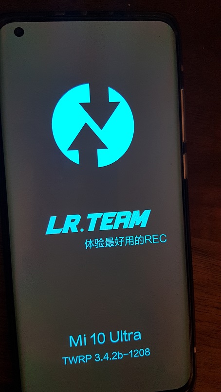

MI 10 Ultra unofficial TWRP
I couldn't get the earlier TWRP to see the .img file to flash it, so I used the .bat and did it in fastboot. Needed to translate the Chinese on the fly, where Google really was my friend :)
It works well, although the only visible change for now is the mentioning of the Mi 10 Ultra. That's nice enough though :D

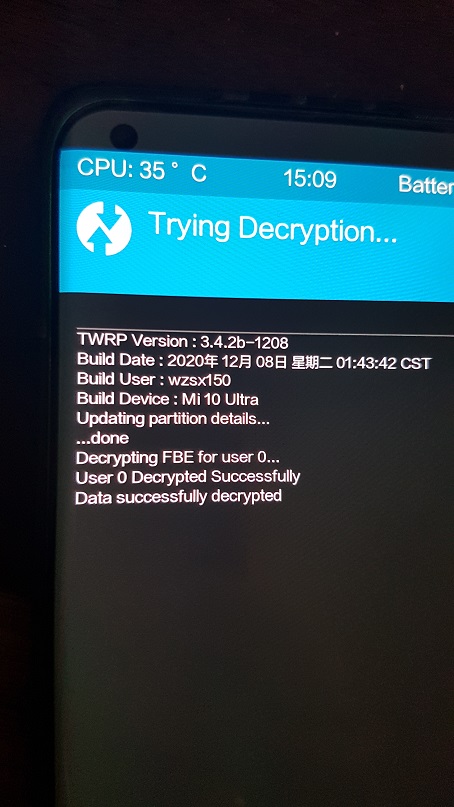

First, I installed TWRP via Fastboot (when you unzip TWRP you will get 10 files, and the last one is in Chinese partly: 打开CMD命令行 - it is a windows batch file) by doubleclicking on that file mentioned before and typing fastboot flash recovery recovery.img . It will install TWRP quite quickly (it will be in Chinese when you first install but you will easily find a button to change that to English), and then you reboot in TWRP by typing fastboot reboot recovery.
Once in TWRP, you have to do format. After that, restart from TWRP and choose restart to recovery mode. Your computer will recognize your phone and there will be TWRP folder there. Upload zipped ROM there, and then click install in TWRP and choose that zip file. When it is installed go back and click wipe dalvik/art, cache and data (choose nothing else), and then reboot to system. Wait for a few minutes, and that is it.

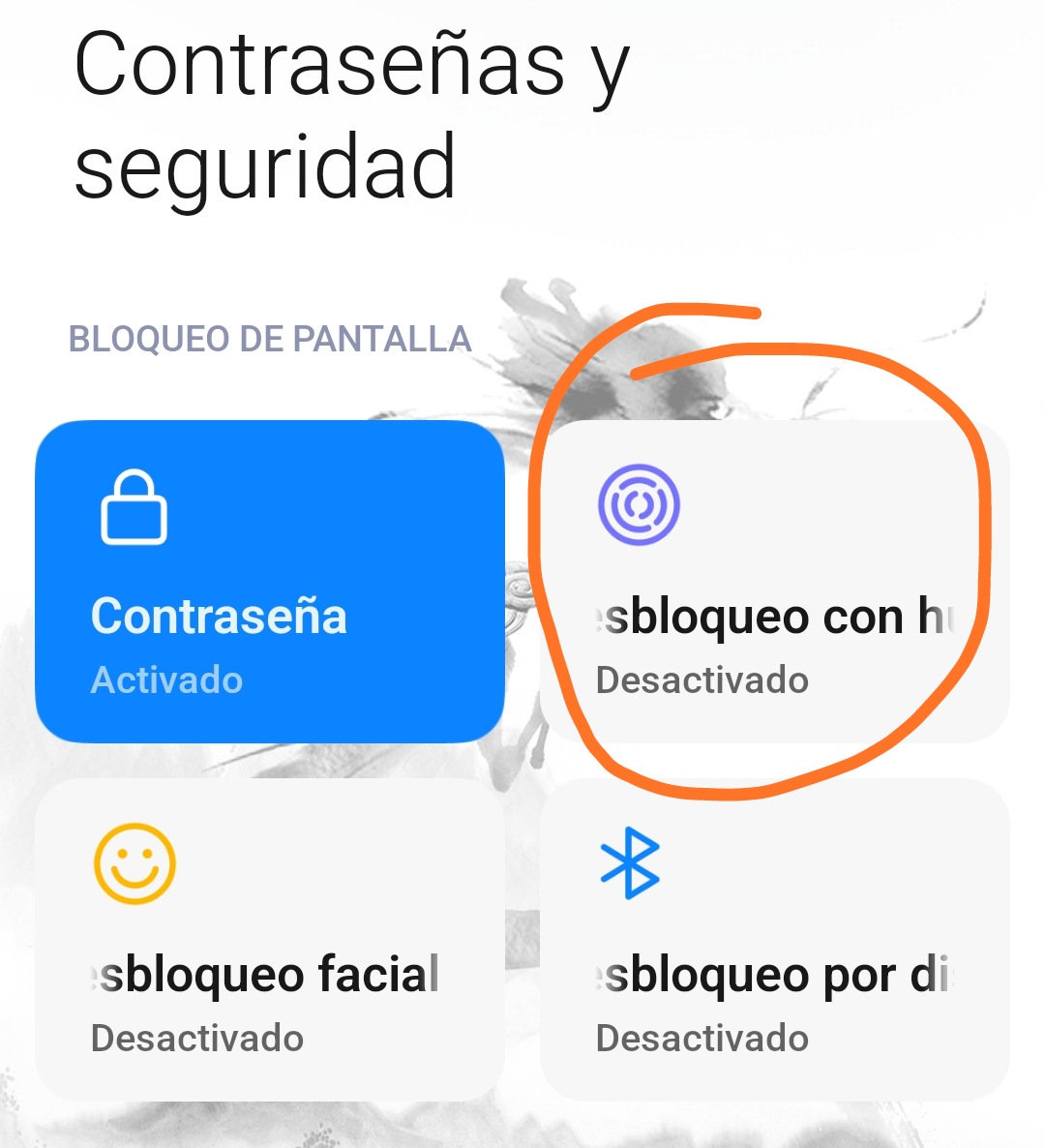

5. one thing to point out, is that after the problem with my account i changed the sim card and change the email in order to recover the unlocked status, it doesn't mean that i had to wait for the 168 hrs. as the beginning but there was a mess with my account where in some actions the bootloader said its was unlocked and in the MiFlashool said the bootloader was locked, until i decided to change the sim card and the email and then everything normalized without having to wait for the permission from xiaomi.
I installed the persist.img for the china stable rom 12.0.15 on the china beta 21.1.6 the problem of rebooting in twrp
disappeared (maybe this could be the problem)
pdta: you can see in the circle the option
thanks for you time Mark, best regard

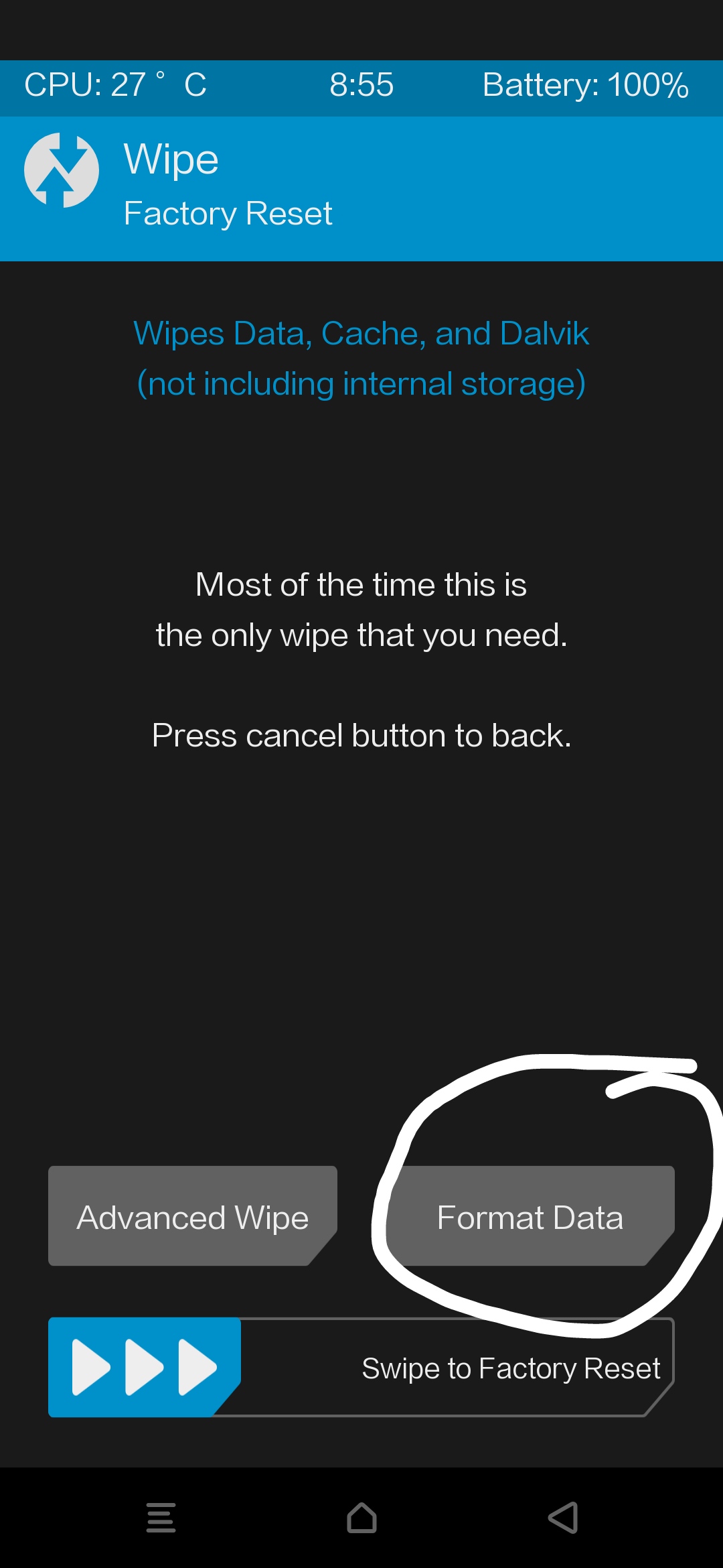

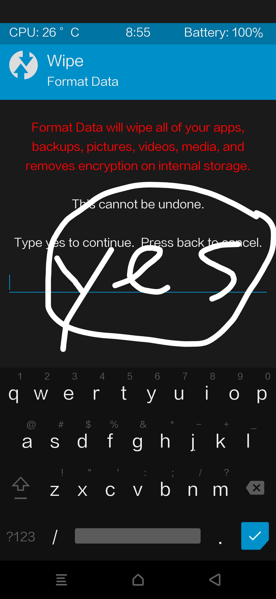

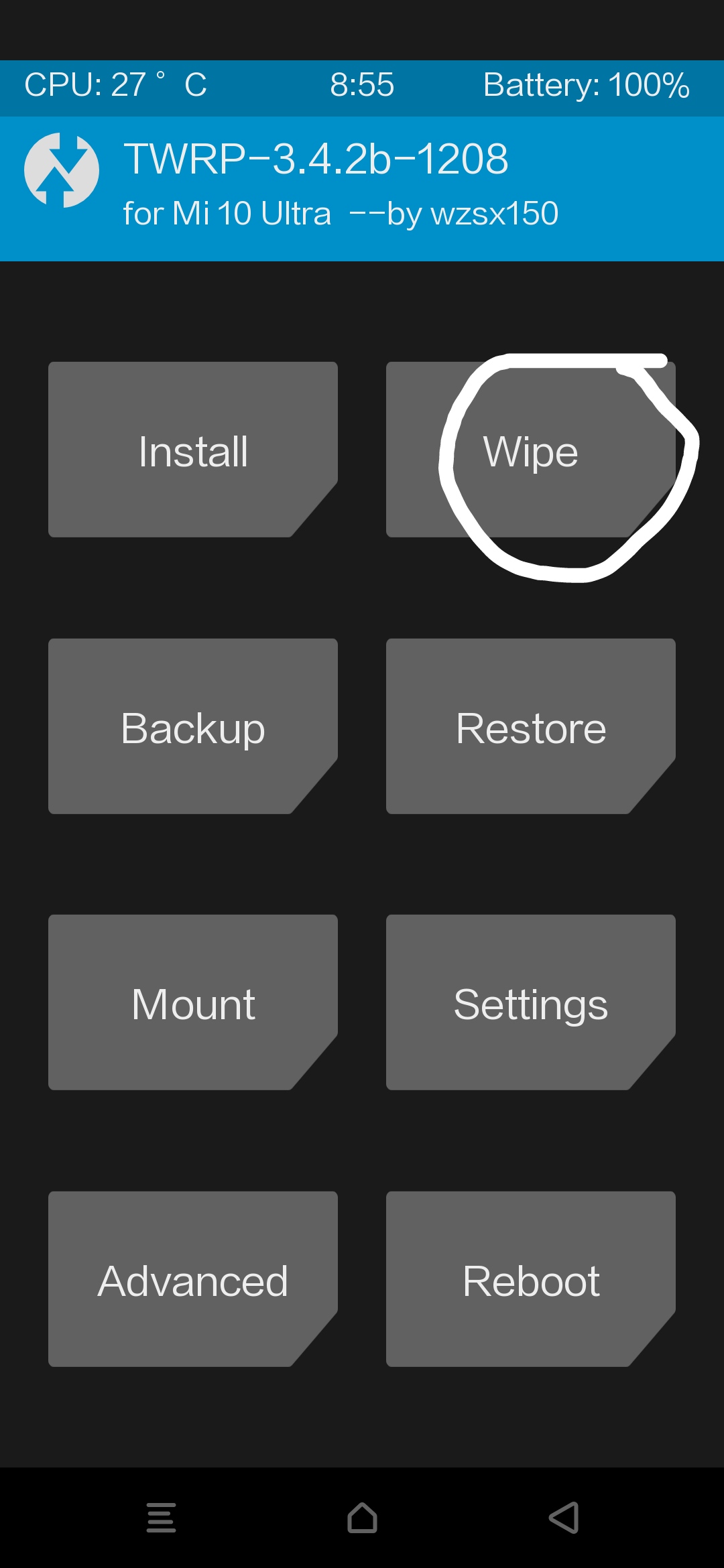

Hi, I will go through your reply later but I really need confirmation of your wipe. I need to know if it was a wipe or format before and after installing the EU ROM.
Did you format by going in to the wipe menu in twrp and select format and confirmed by pressing yes? This is the format that is needed to format data on ROM branch changes and would have cleared any wrongdoing that happened before. If you just wiped using twrp and not done the format, it will leave issues.
I have attached screenshots below of the path to the format. If you could confirm you did it this way or not ? It would help.
Hey Mark yes of course i did the wipe action as you said and as in the pics definetely i did that way
