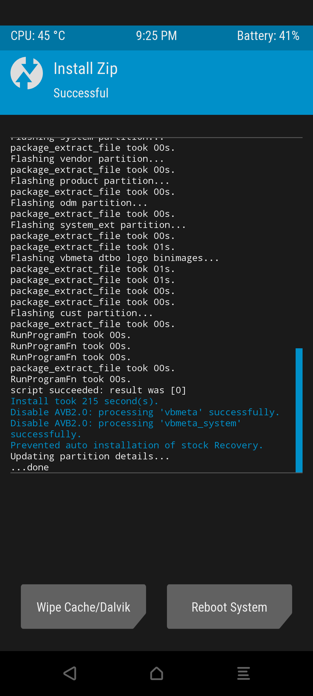

Hello guys
This is complete guide for the latest update 22.6.22
First of all U must have bootloader unlocked
1. enable USB debugging from developer option
2. Download the latest TWRP from here https://androidfilehost.com/?w=files&flid=318203
(Download the version in the photos below )
3. Download ADB Tools on Your PC install it and copy the download TWRP file into the same ADB folder destination on PC
4. reboot ur phone into FASTBOOT MOOD (remove all lock screen before reboot "MANDATORY")
5. Open ADB tools on pc while connecting the phone into PC with USB cable (make sure all needed drivers are installed and up to date )
***On adb shel write these commands***
A.. fastboot devices ( just to make sure ur phone is recognized by ADB
B.. fastboot flash recovery TWRP.img
(rename the downloaded TWRP file - TWRP.img)
--(Wait for the procces to complete)
**Then write
** Fastboot reboot recovery
#You must be now in twrp recovery,, Change the language to EN "explained before"
***THEN***
Reboot the recovery to make sure it's not replaced with stock recovery
**Copy the ROM file to the root of internal storage on phone
***From TWRP recovery choose install , navigate to the ROM file ,then swipe to confirm flash.
***The installation procces will take some time (must end successfully)
***Wipe dalvic/cash (optional)
***Reboot to system (first boot might take some time , don't be worry)
That's it , ENJOY
This works for me without any errors
