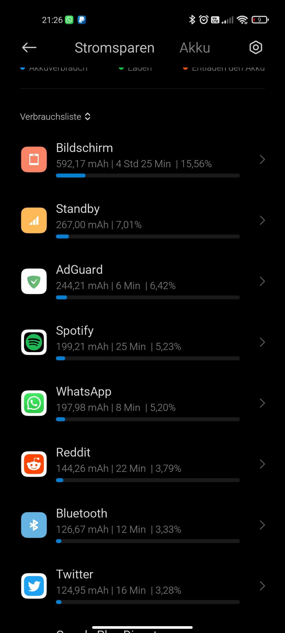

Hi guys,
I flashed Xiaomi EU rom a week ago coming from chinese rom in hope of better battery life, but it's even worse. I get max 5h of SOT with minimal graphic settings (FHD+ and 60Hz, no 5G) all I do is reddit / news apps / messengers. Battery health says "good"
What can I even do? Im so disappointed by Xiaomi and the Mi 11 in general...
