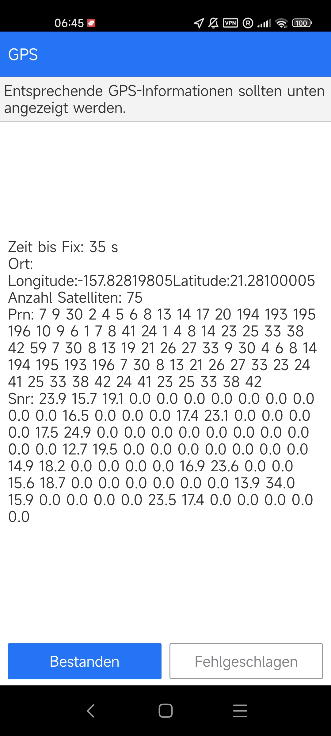

Is it only Google? Have you checked to ensure it is on the use GPS list? Check GPS from a test app or go settings, all specs and tap on kernel may times to get to the test page. Scroll down to 40, GPS test and look there.
Thank you for your reply. The screenshot is after round about 15 seconds. There are many zeros or is it okay?
You are seeing 75 GPS satellites but a lot have low signal. Are you actually outside testing them?
