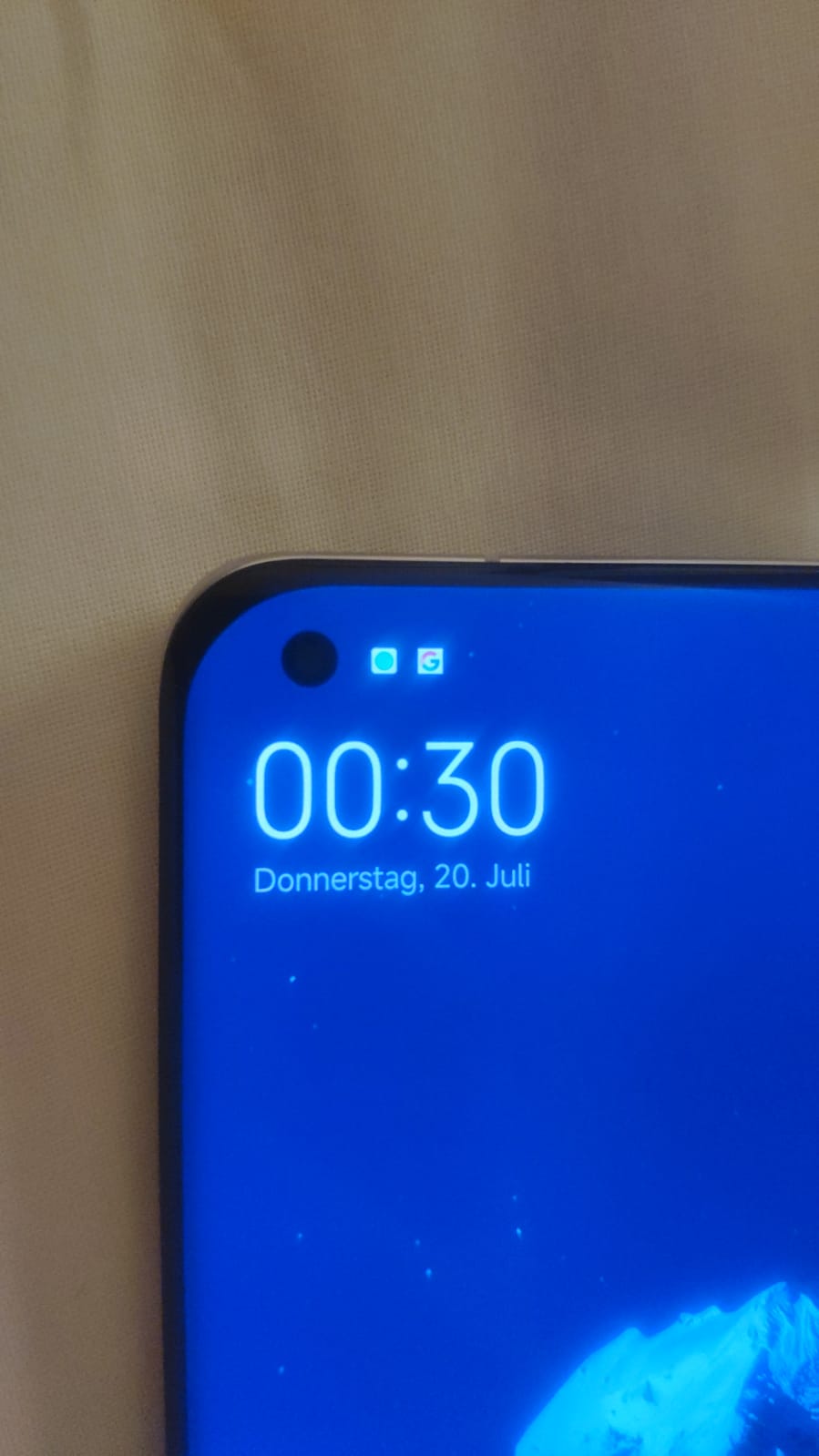

sorry for the size : handy worked FINE for many hours today, then there was a sound (like notification, but little different), and then it had this in the upper left and all bugs came again (it seems to be the icon for "find my phone" or whatever it is called).

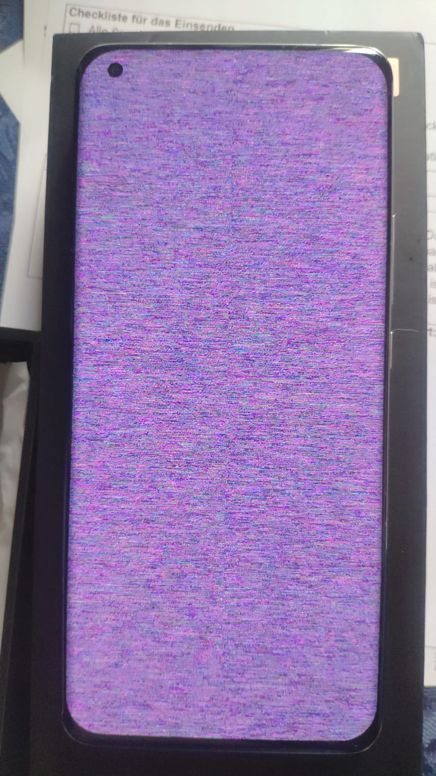

below an older screen "while booting" (basically directly after restart)
