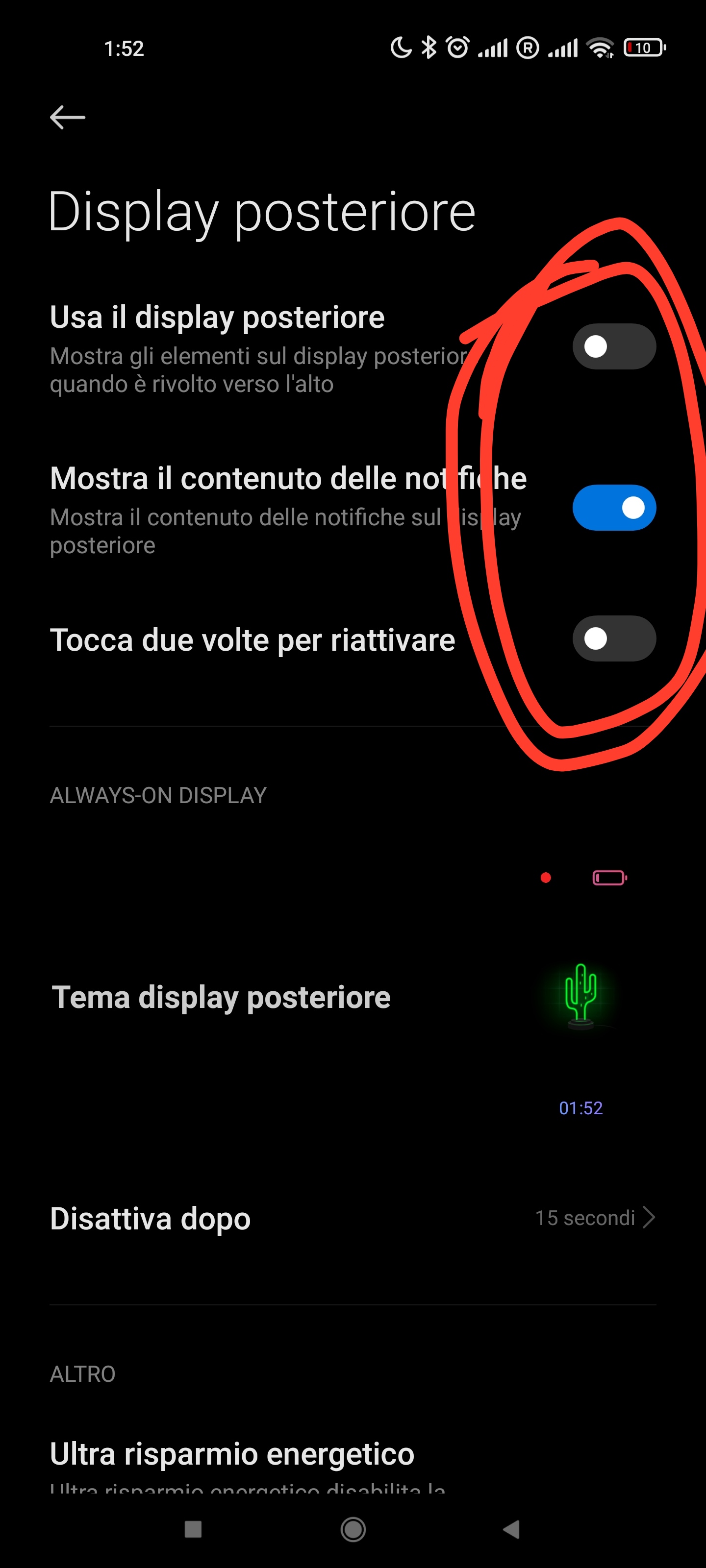

Hi, the rear display has been automatically deactivating without my consent for several days, it is very irritating to have to activate it all the time.I wonder if it's something that turns it off automatically, for example when the battery is low.If it happens to you too and you have found a solution I would be happy to clarify everything, thank you very much!
MIUI Global: 12.5.6
Rear Display version: 1.3.6 (Recent update downloaded APK online).
MIUI Global: 12.5.6

Thanks for your advice, no until 2 days ago without this update I did not receive notifications in the rear display, not even the mobile phone charge icon. The update fixed a lot of the problems I had, except for this one.Let me explain, the rear display works perfectly, the only problem is that at any moment it turns off, and I don't understand why.After I go to check the settings of the rear display m I realize that it is off again and I have to activate it again!I understand it can be a comical situation, but it's not normal!

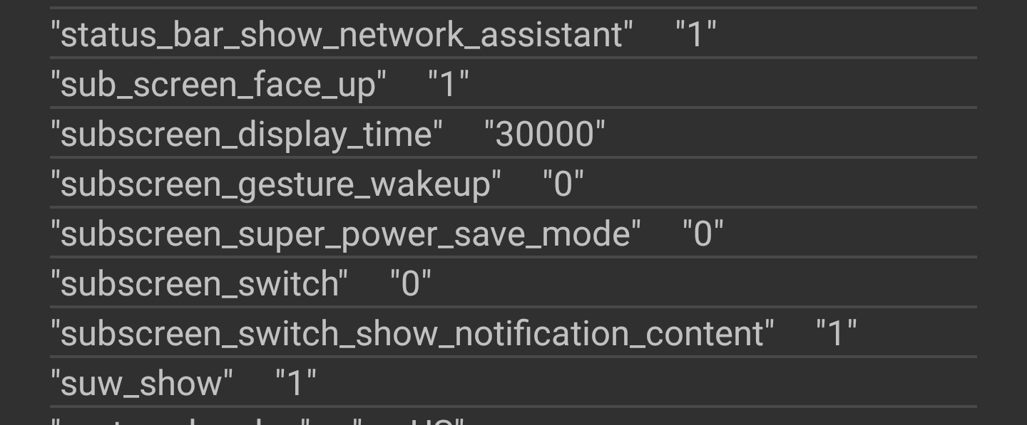

I just realized I needed to download an app to do this, I'm trying like this right now, I'll be in touch by the end of this day, thank you so much for pointing this out to me again!
I have the same problem the rear display keeps disabling itself. What app did you have to download to modify these settings, or where can I modify them? Please help
setedit from playstore i have described it in this topic
# use setedit to edit the time of the rear screen from 3000 (30s) to what number you want its like AOD
# System Table
# subscreen_display_time=[display time in ms]
# subscreen_switch=[0 - dont go off]
# System Table
Sorry I didn't realize it is an app untill now. I downloaded it and the settings are already as you described. And still the display disables itself after like 1-3 hours. It doesn't react to any of tapping or turning, I have to manually turn the settings back just as the topic creator shown on the screenshot
