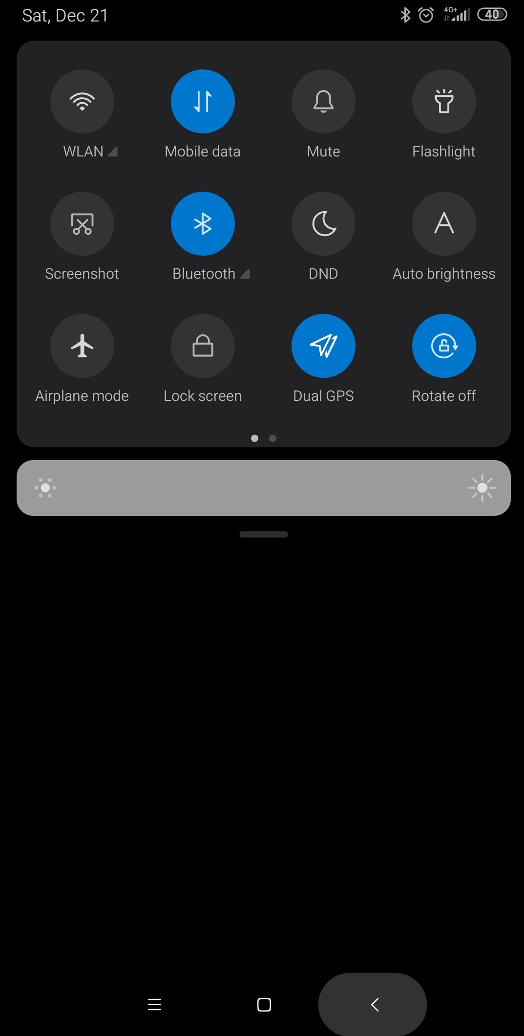

Hi everyone,
I just installed miui 11 from this link https://xiaomi.eu/community/threads/miui-11-0-stable-release.52628/
everything seems perfect except 2 thing :
1- The 5g icon is not showing ( 4g and 3g are OK )

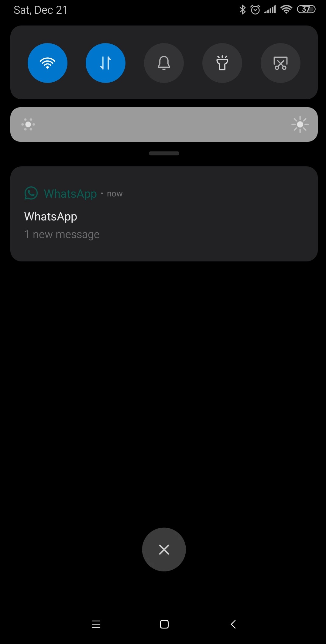

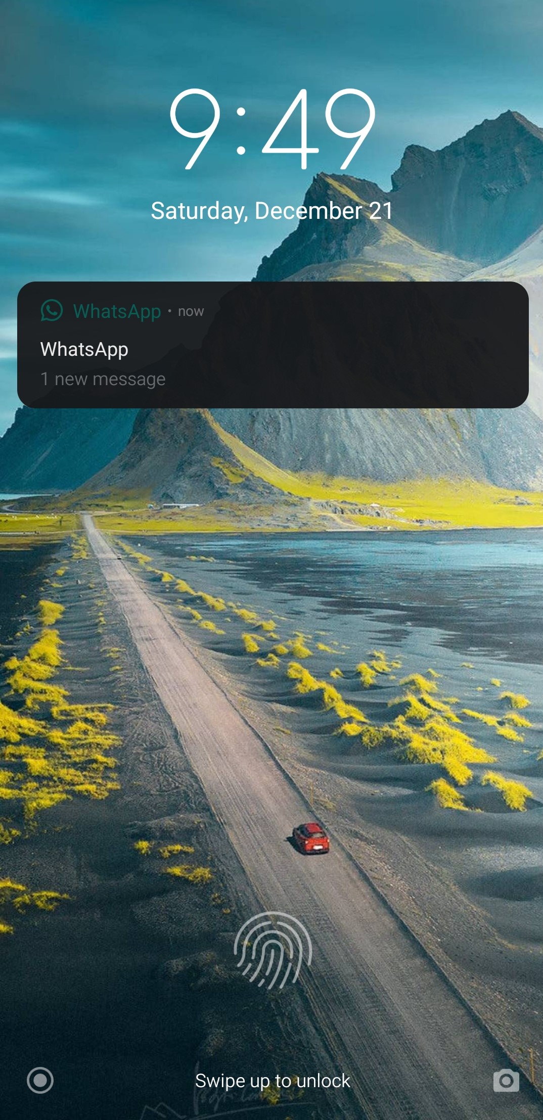

2- i cant see whats-app notification

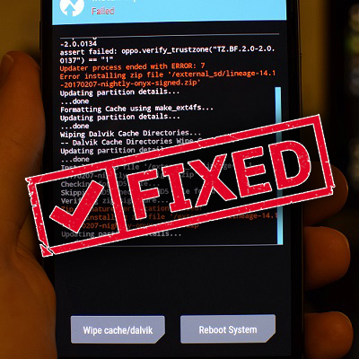

the file showed in the TWRP , but when install , it says : updater process ended with error: 7
error installing zip file
i tried the below , but the word assert does not exist .
Reactions: charlien09
Did you mount System partition before trying to flash?...
sorry forget to do . the file installed successfully, however the 5g icon still not showing .
Note: the whats-app notification issue has been solved after formatting the phone.

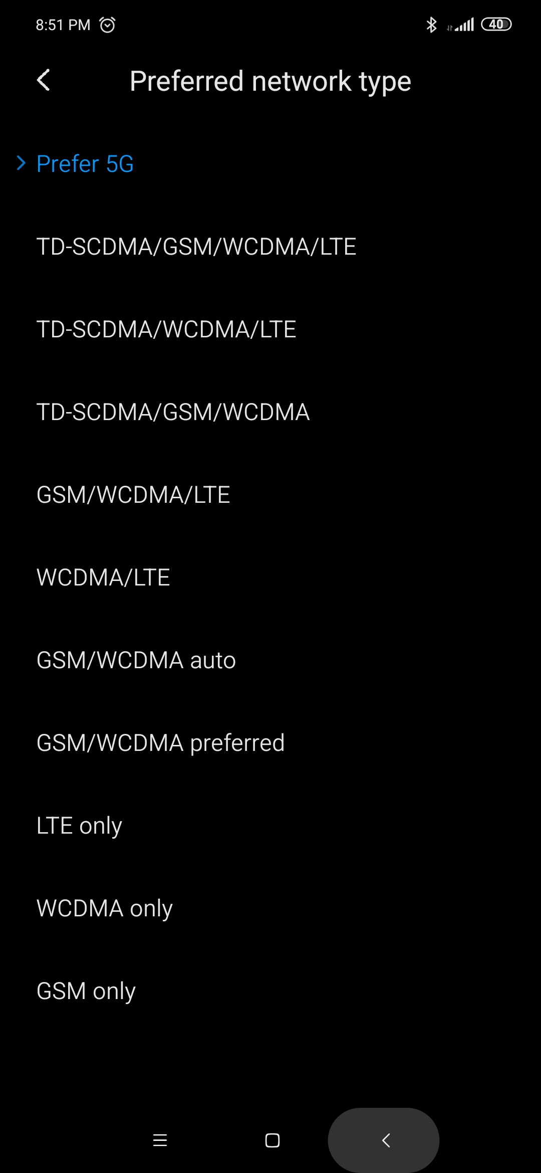

Just to be clear. Does your sim or network provider supports 5G techonology yet? Does it have the same band the Mi 9 Pro 5G has?

yes. my network support 5g and they work wonderfully with the original chines Rom . the 5g still work with the EU rom , my concern only is the 5g icon is not showing .
I think I know where the issue is. Will take care of it.
Then replace MiuiSystemUI.apk with the one in the ZIP manually.
how do i find MiuiSystemUI.apk in the phone to replace it with the ZIP . When i try to install it manually , it says ( Cant install system applications from unofficial channels.
You use TWRP's File Manager. The APK is in /system/system/priv-app/MiuiSystemUI
