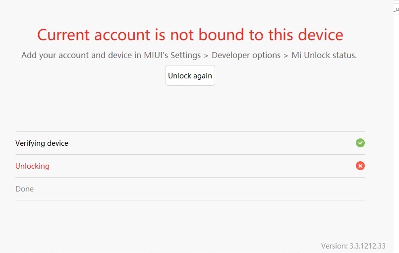

Hello community, :emoji_wave:
if I want to unlock my bootloader, the message "Current account is not bound to this device" will appear. A time indication that I should wait, you can not find either, where is the "Developer Mode?", To query the MI Unlock status? at MI PAD4
I'm grateful for any help

Settings > About device > tap several times on "MIUI version" until will you have monit "You are already a developer", then Developer options > Mi Unlock Status.

Thanks, have it! However, it is a little bit different. You have to follow the order of MIUI 10 in the following order
My device> All specs> Miui version...tap several times.
