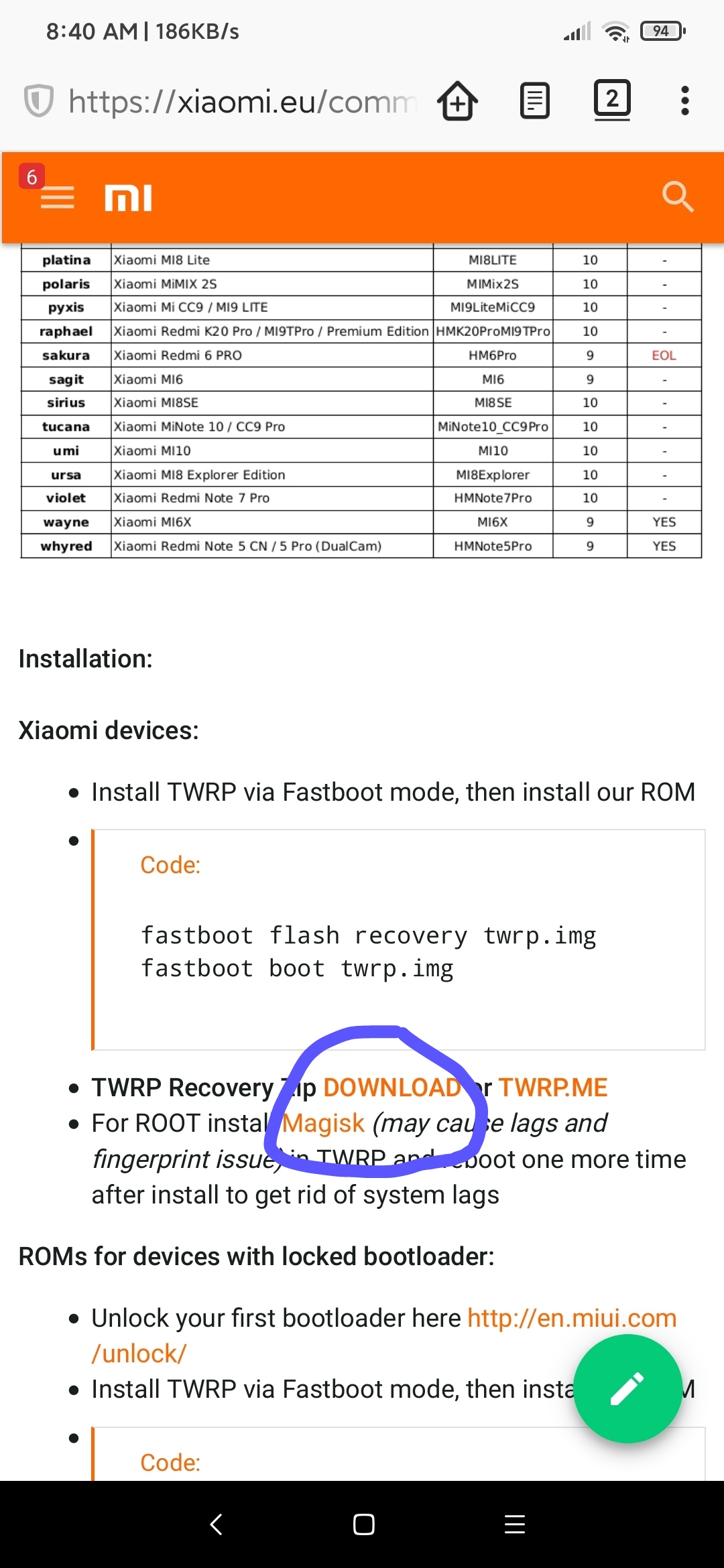

Maybe try the latest twrp from L.R. team
I'm using it now without problems. It's 3.3.2b-0219
