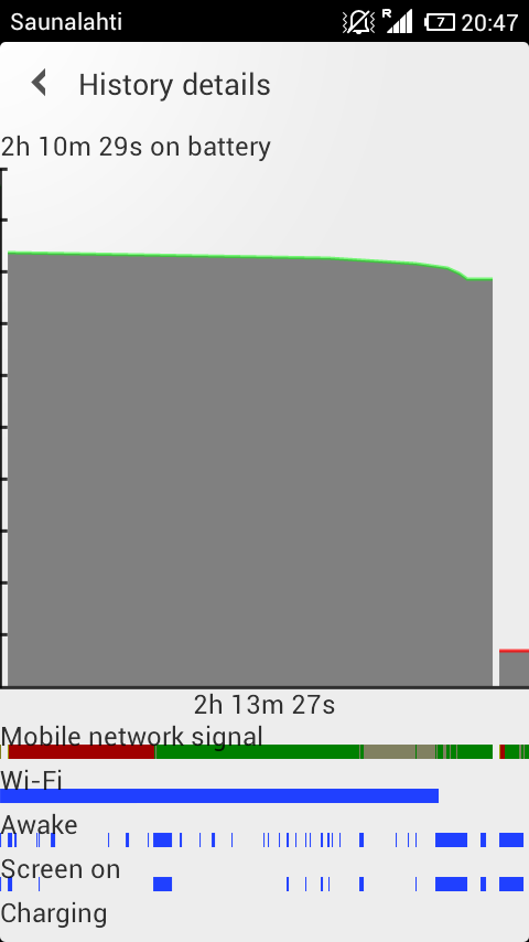

I don't know about other users here having M1 but my phone has something seriously wrong with the battery. Many times a day my phone keeps restarting without any warning (esp. when calling) and after the phone boots again the battery is almost empty.
Anyone else experienced same? Here is a screenshot attached! 2012-06-03 20.47.23.png

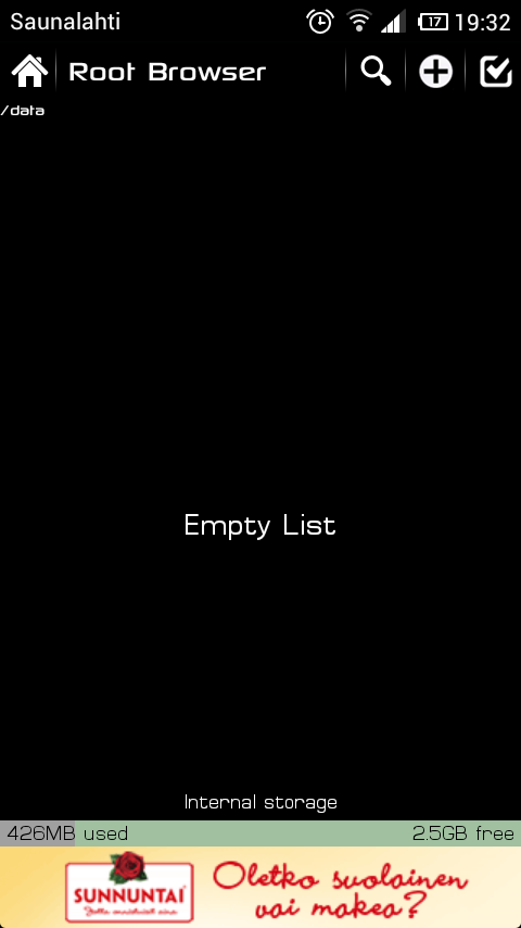

I am starting to think this problem is caused by hardware problem since I am currently running newest MIUI 2.6.1. The crashes are random. It can happen anytime anywhere even if the phone is in my pocket. (It happened in GB ROM as well as in all ICS ROMS)
Is there anyway to get debug log or something out of the device?
omg no!
U have root permission? I hope yes....
btw data/system is not empy!
