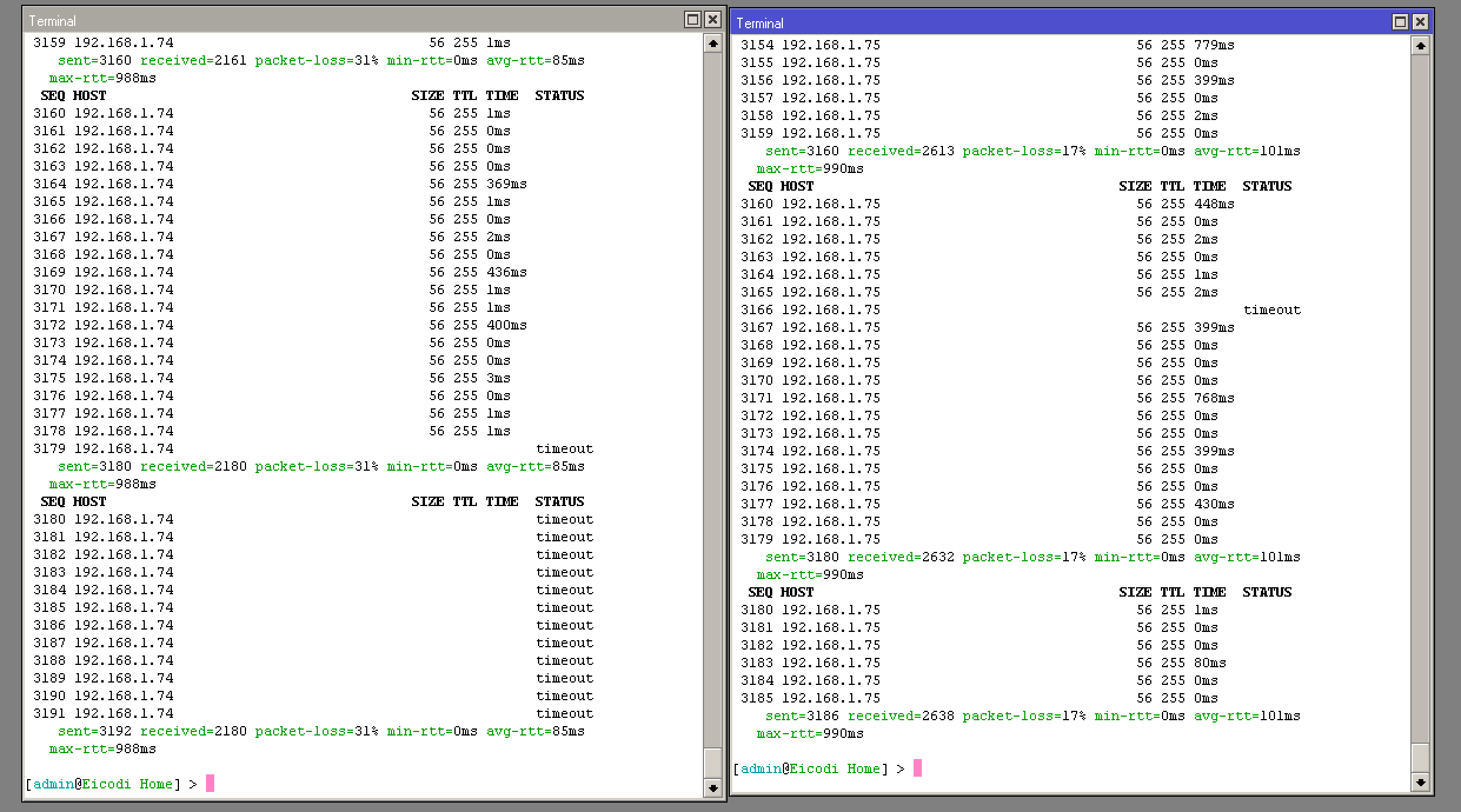

I try to ping from the Router to the both sockets and I LOST about 30% of packages, on the LAN envoriment. I attach a pic about the ping test.
I think is a problem with the CPU of the socket in relation with the firmware
