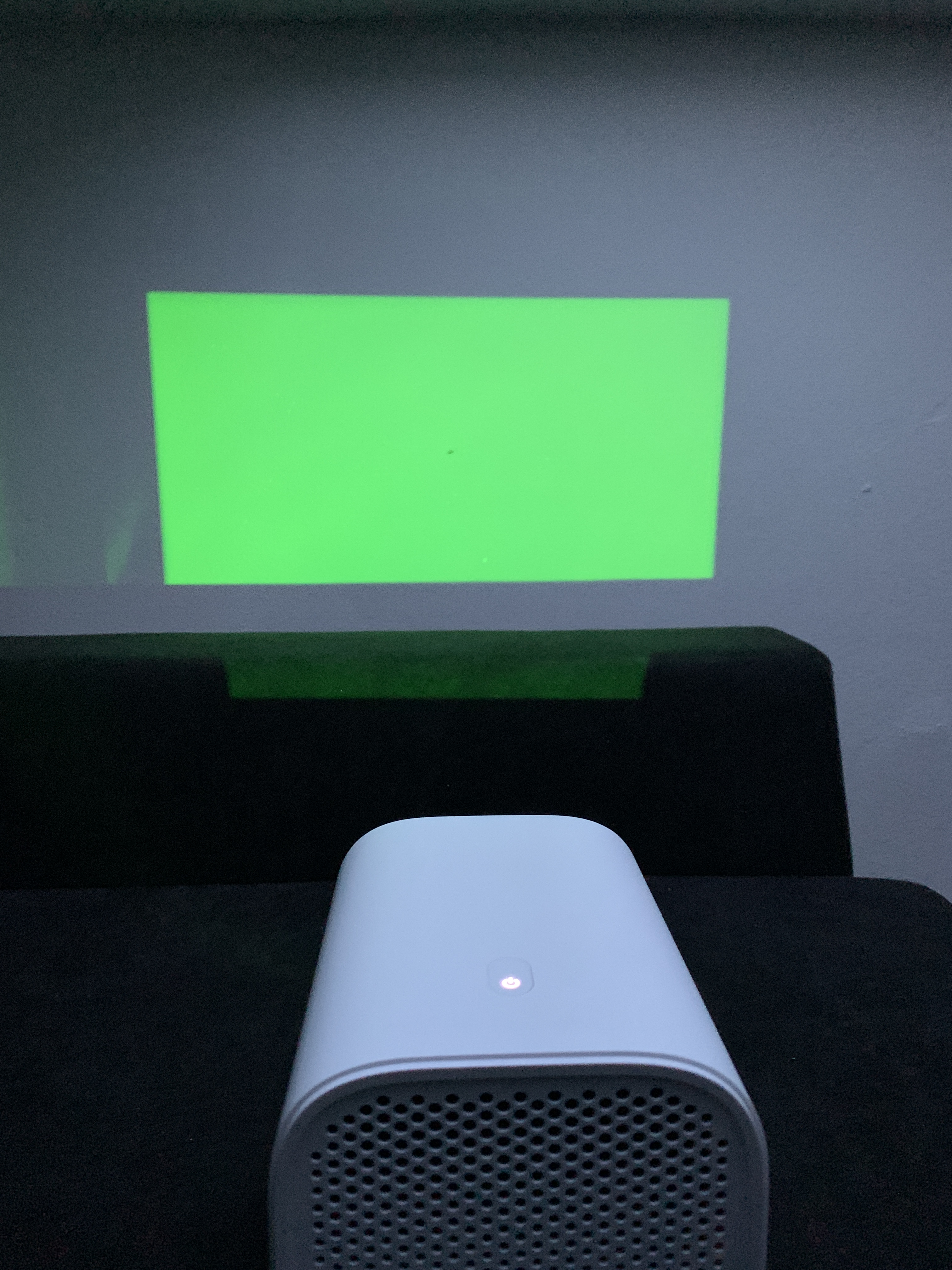

I have a problem with the projector, after turning on, only the green background will be displayed and after 15 seconds the projector will turn off, can you advise me?
Link to video is below:
https://share.icloud.com/photos/0VMsVAafNlXzGHNPIv_XYFIPw
I'm having a similar problem, with the projector's led blinking for a while with no image showing and then shutting down. Turning it on for a second time, it showed the green background and then turned off again.
After a few attempts using the button and also the remote, it finally showed the Mi logo and from that point it started normally.
Yes, I solved the problem. the imaging chip has been damaged, the projector is working properly after replacing the chip. The repair cost approximately € 100.
