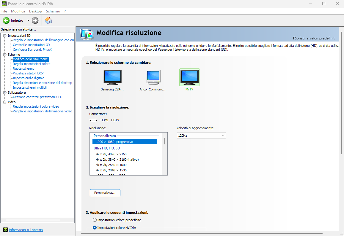

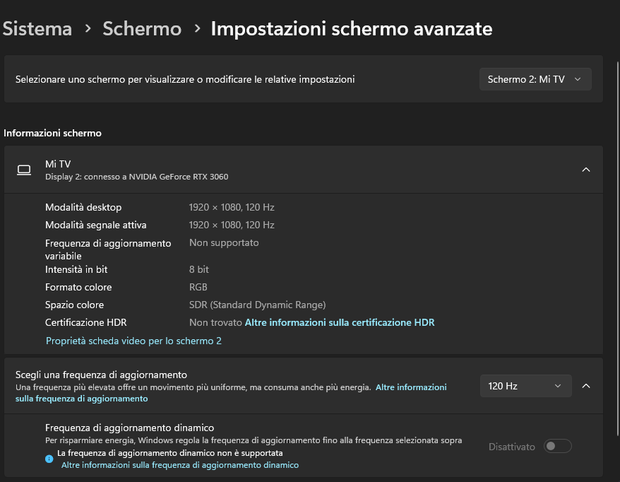

Hi, There is no need to disable, but simply to turn off the notification. (as you do on the phone) If you disable it is obvious that the applications will not work.
Reactions: Fox Andersson
