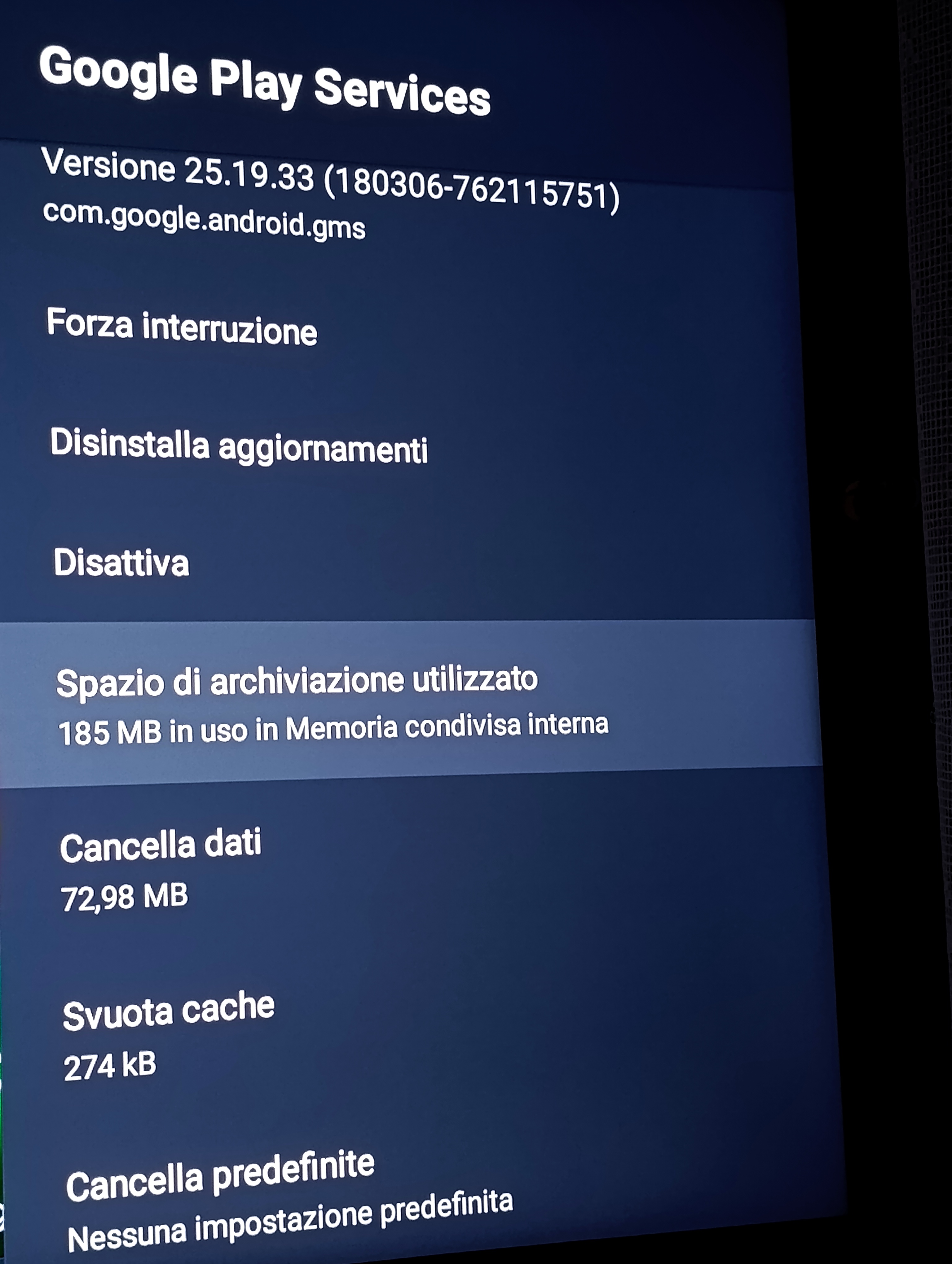

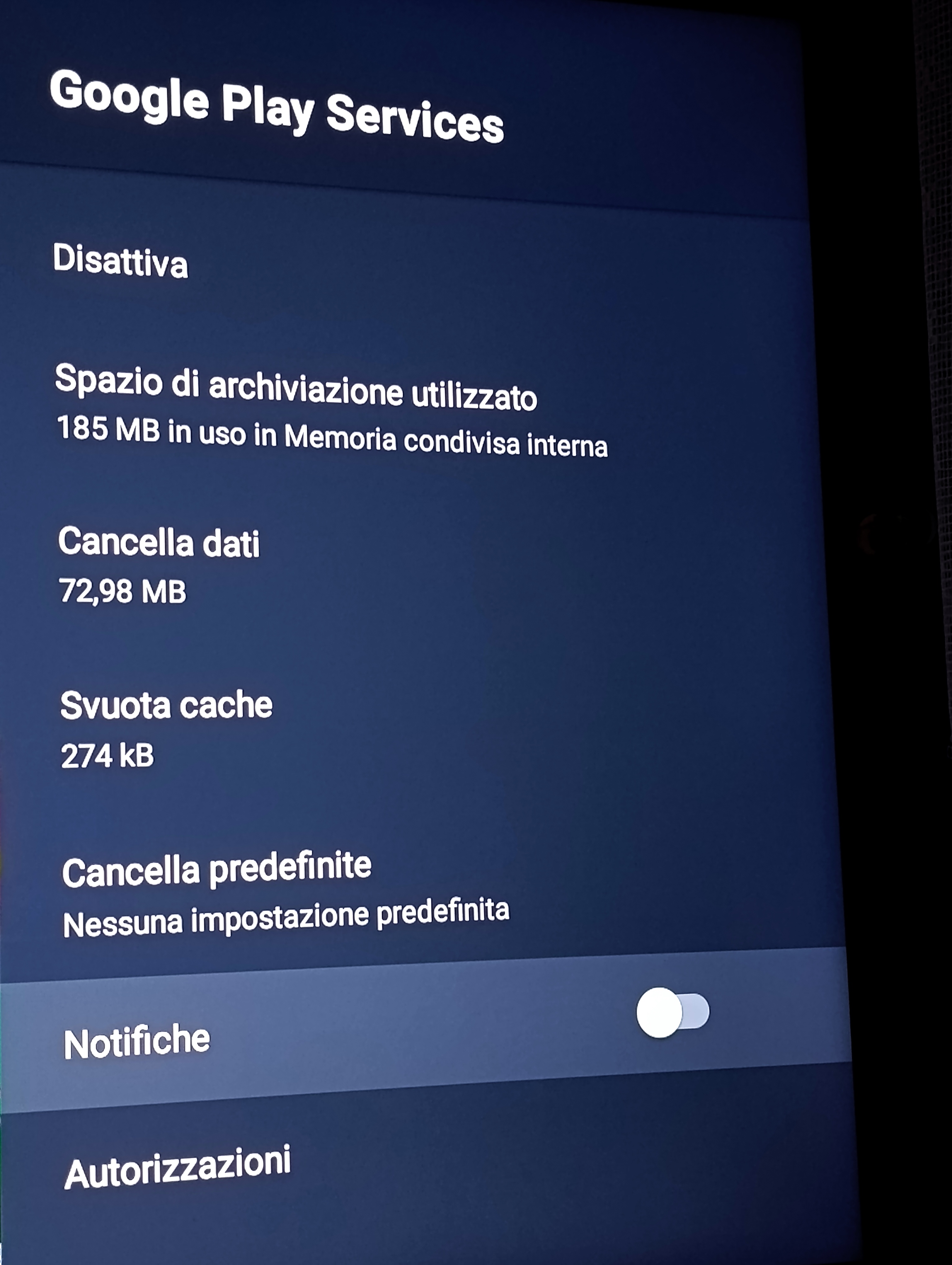

I found a way to turn off the update notification. Select: Settings/Device Preferences/Apps/Show All Apps/Show System Apps (down below). Scroll down (to the middle) until you find Google Play Services, turn off the notification and restart the TV. Enjoy
But,.... then other apps are affected. e.g. Netflix will not work anymore!

You really had the right fix! Unfortunately i cannot disable the google play services as Netflix will not work without it!
Hi, There is no need to disable, but simply to turn off the notification. (as you do on the phone) If you disable it is obvious that the applications will not work.
