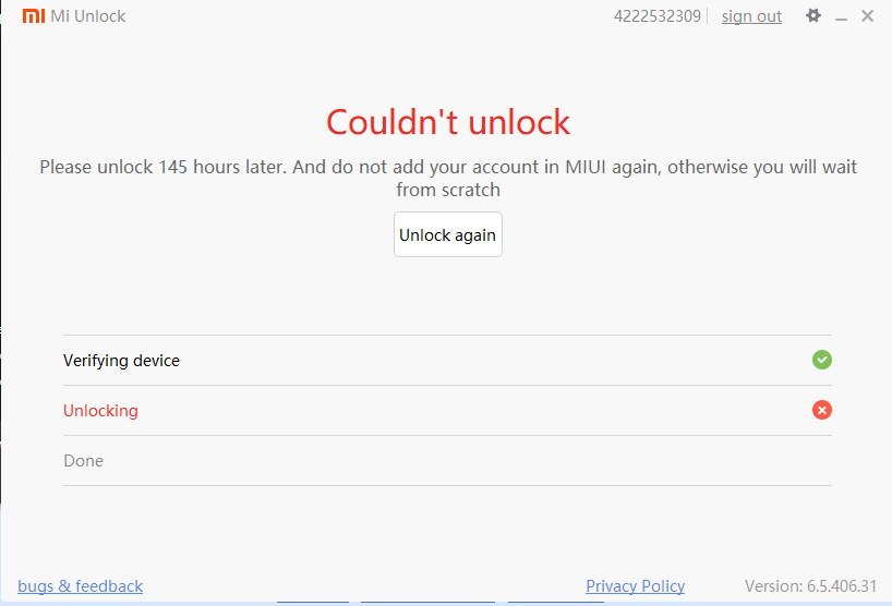

Hi! I had the same error, some russian guys recommended me just try to unlock again with Mi Unlock and it worked! Just don't care abt the error.

Hi! I had the same error, some russian guys recommended me just try to unlock again with Mi Unlock and it worked! Just don't care abt the error.View attachment 46062
So just connect my phone in Fastboot mode again and try unlocking it? I got that 7 days cooldown on the mi unlock app, should i just ignore it? On your screenshot it's showing like it's not done, so should i guess that it's unlocked and just don't care about the cross and couldn't unlock error?
if mi unlock says, that you should wait for some hours (usually it says wait for 7 days), while this you just wait, don't relogin into your mi account on phone, after timer ends you just connect your phone to pc on fastboot and in mi unlock tap on unlock, it will do a factory reset and your bootloader will be unlocked!
