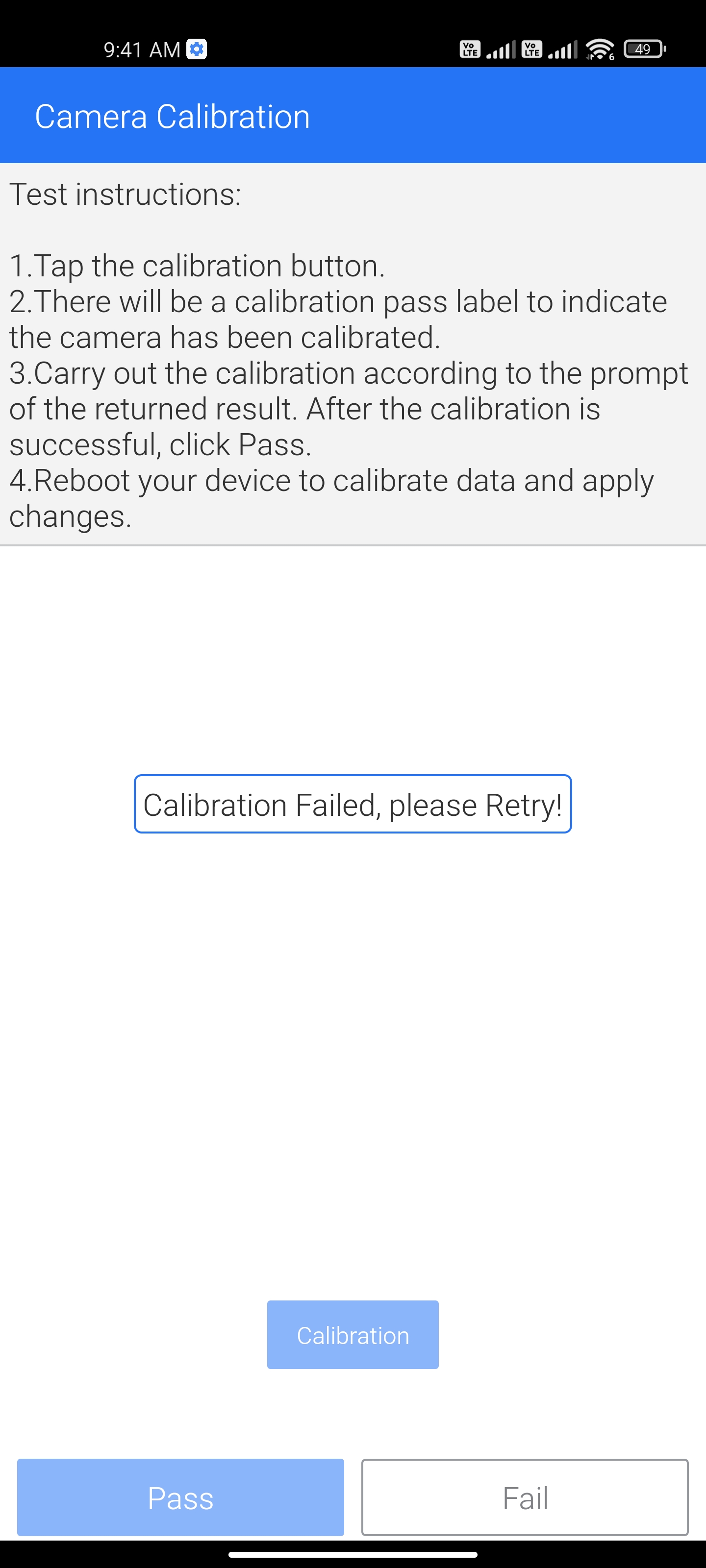

I have treid the extended cit menu camera calibration, with multiple "calibration" pictures (does anybody know which I need to use for it) and it fails every time. If anyone could come up with suggestion that I could try, or any similar issue, comment below, I'm considering it now more and more a hardware failure. I have dropped the phone couple of times but can't remember dropping it around thath time it started having the issue.
