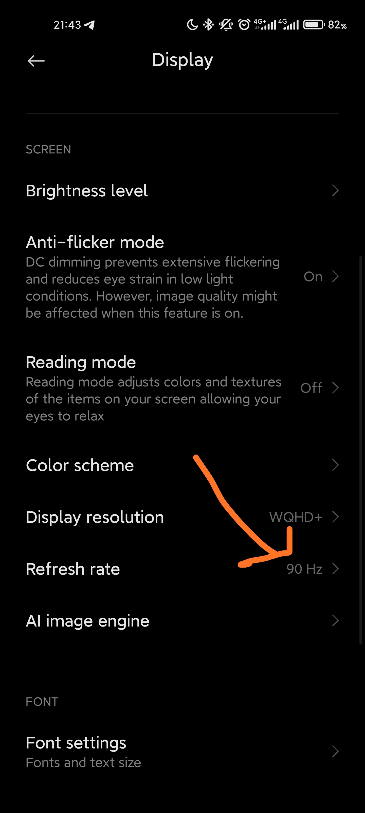

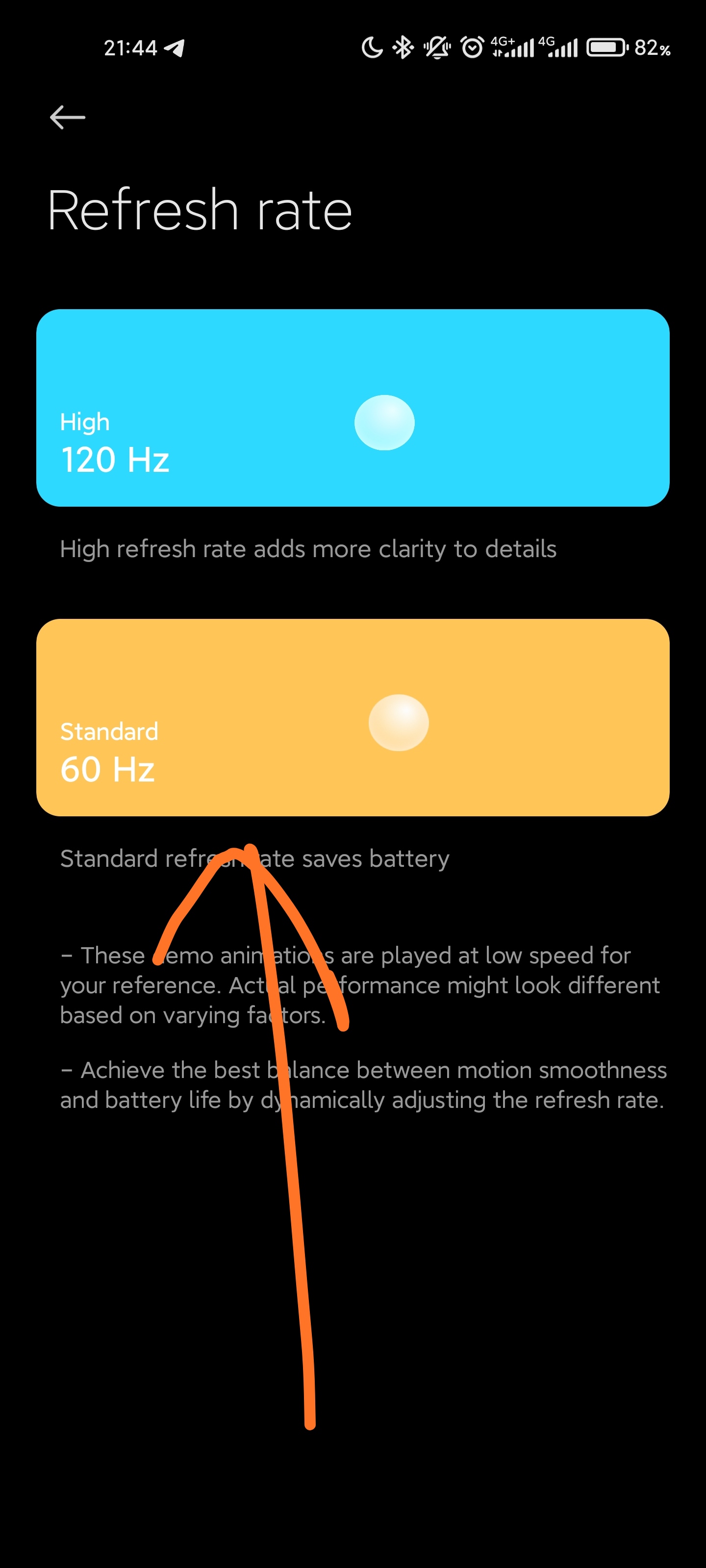

There is a workaround to change the screen to 90hz, working perfectly on my mi 11 ultra. Download an app called SetEdit from play store and install, change the user refresh rate and peak refresh rate to 90hz from whatever you're currently on 60hz or 120hz.
