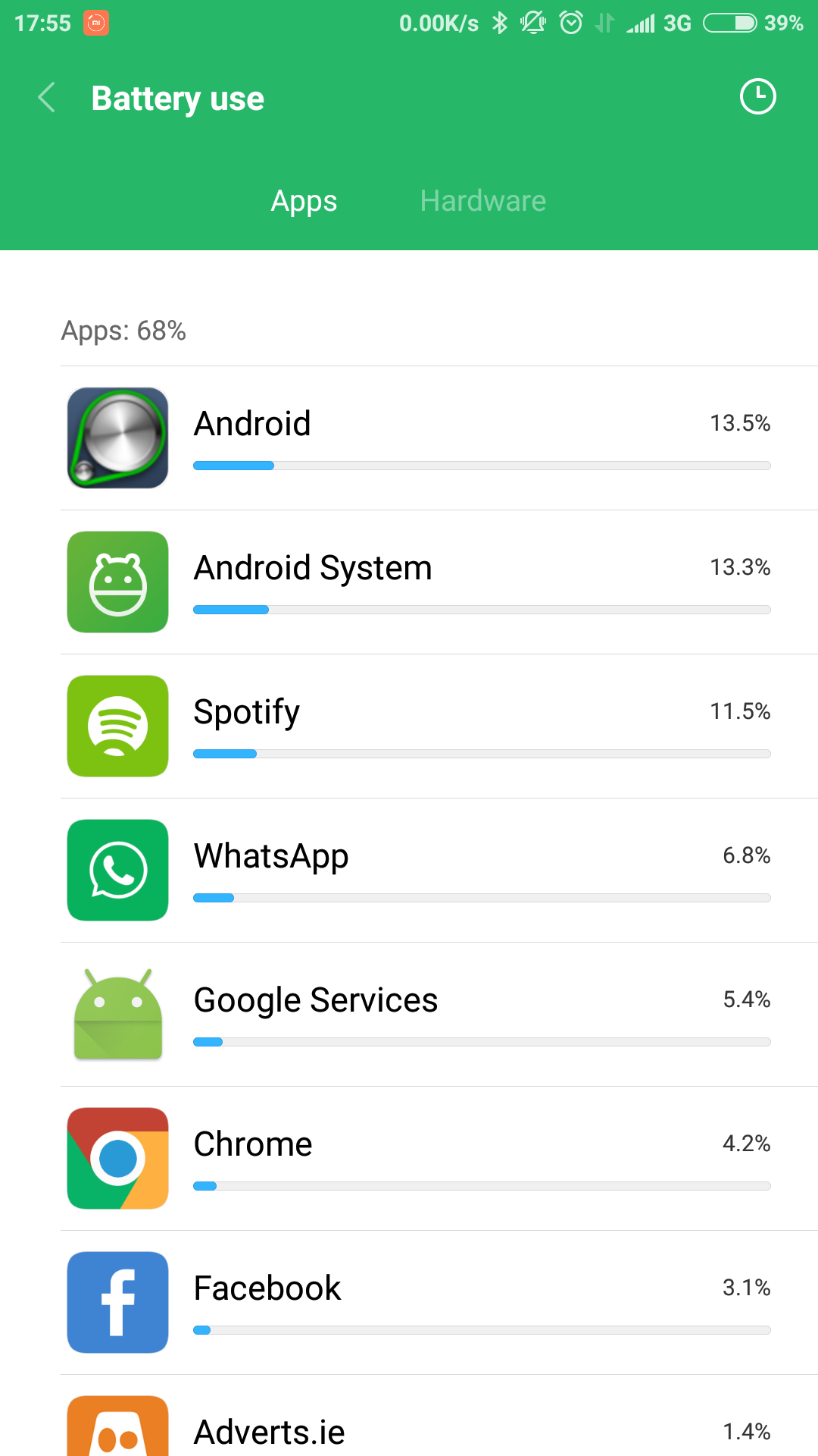

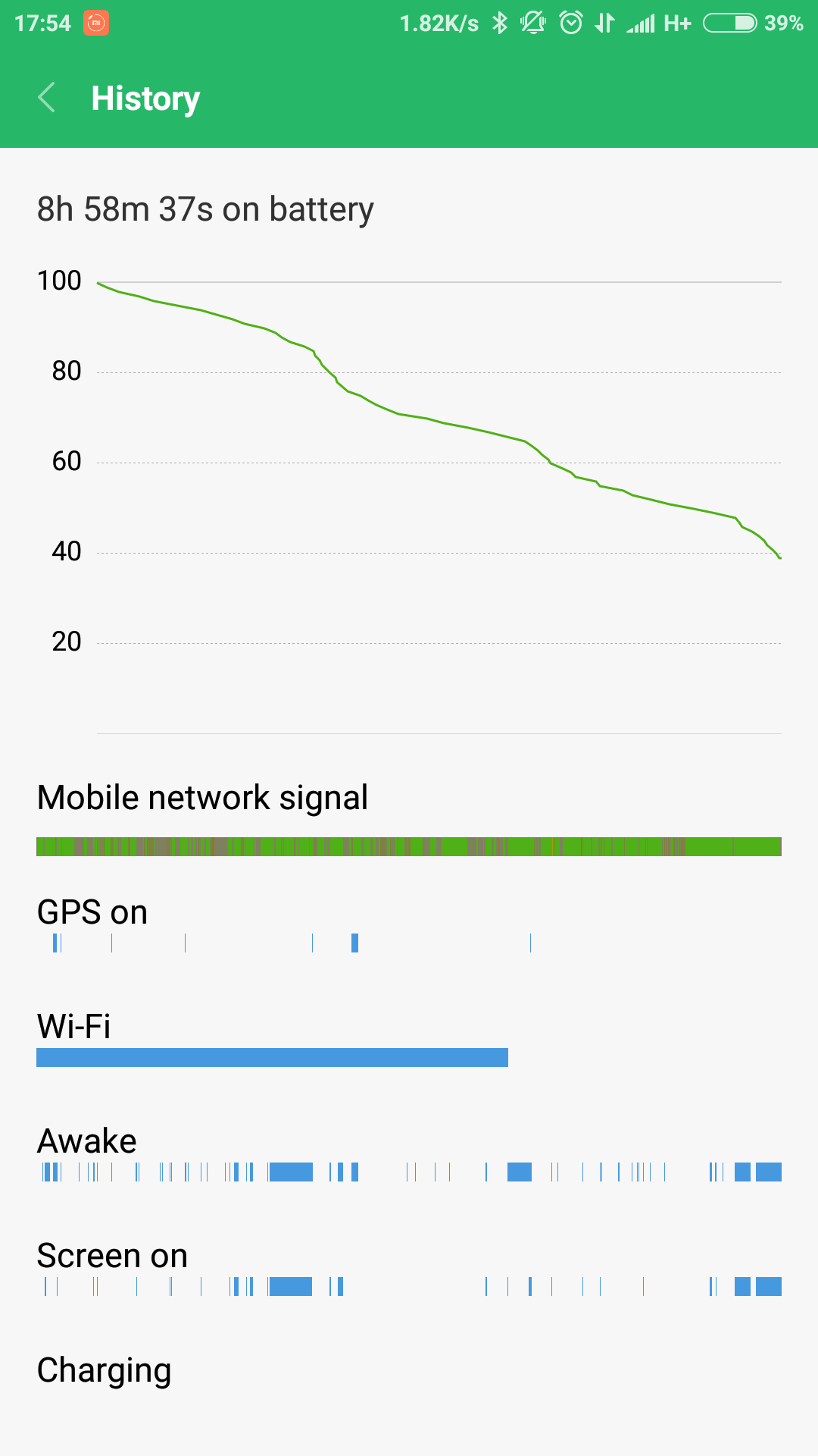

Normal usage ond 60% for only whatsapp and little bit browsing today.
Really bad

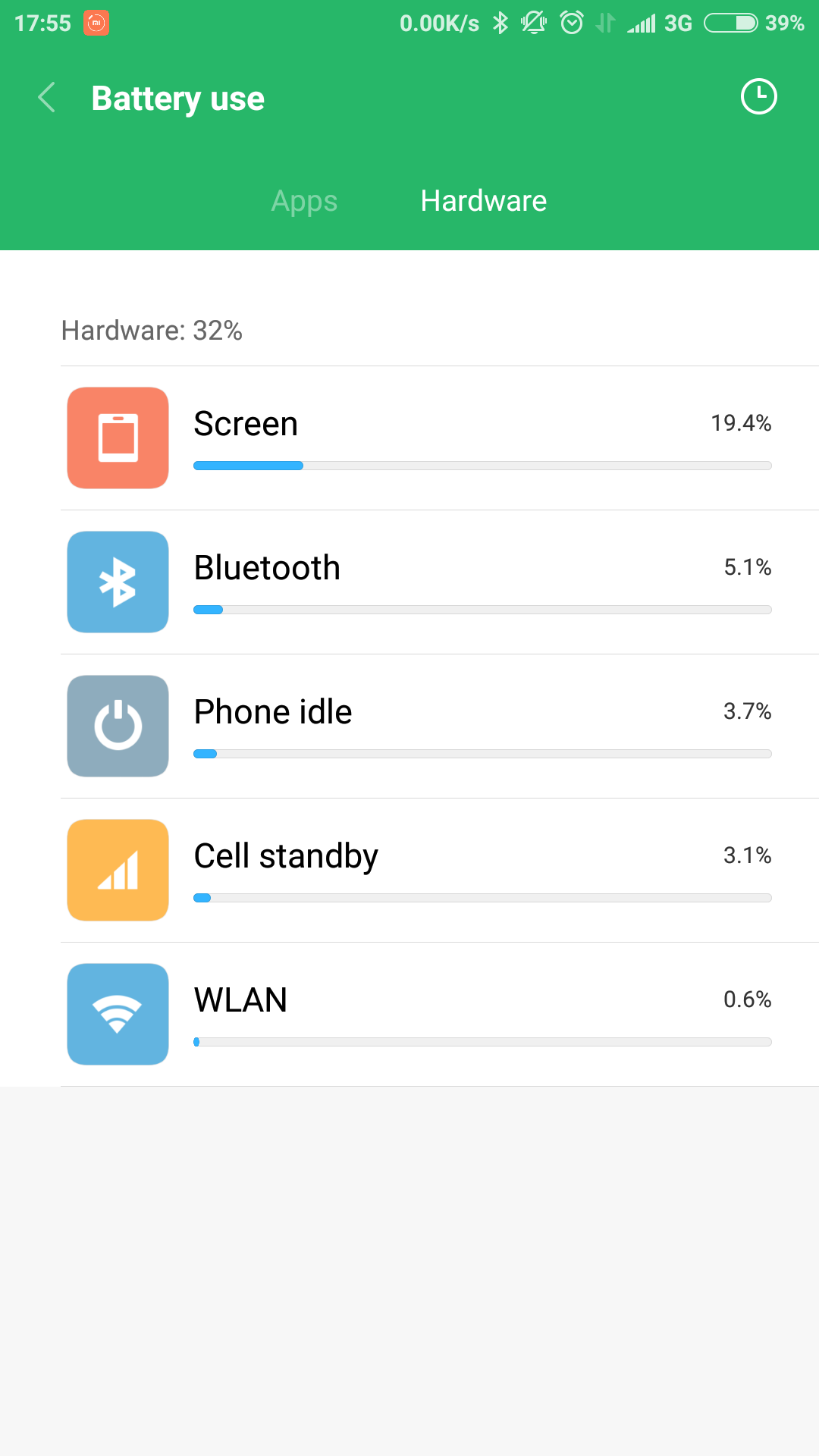

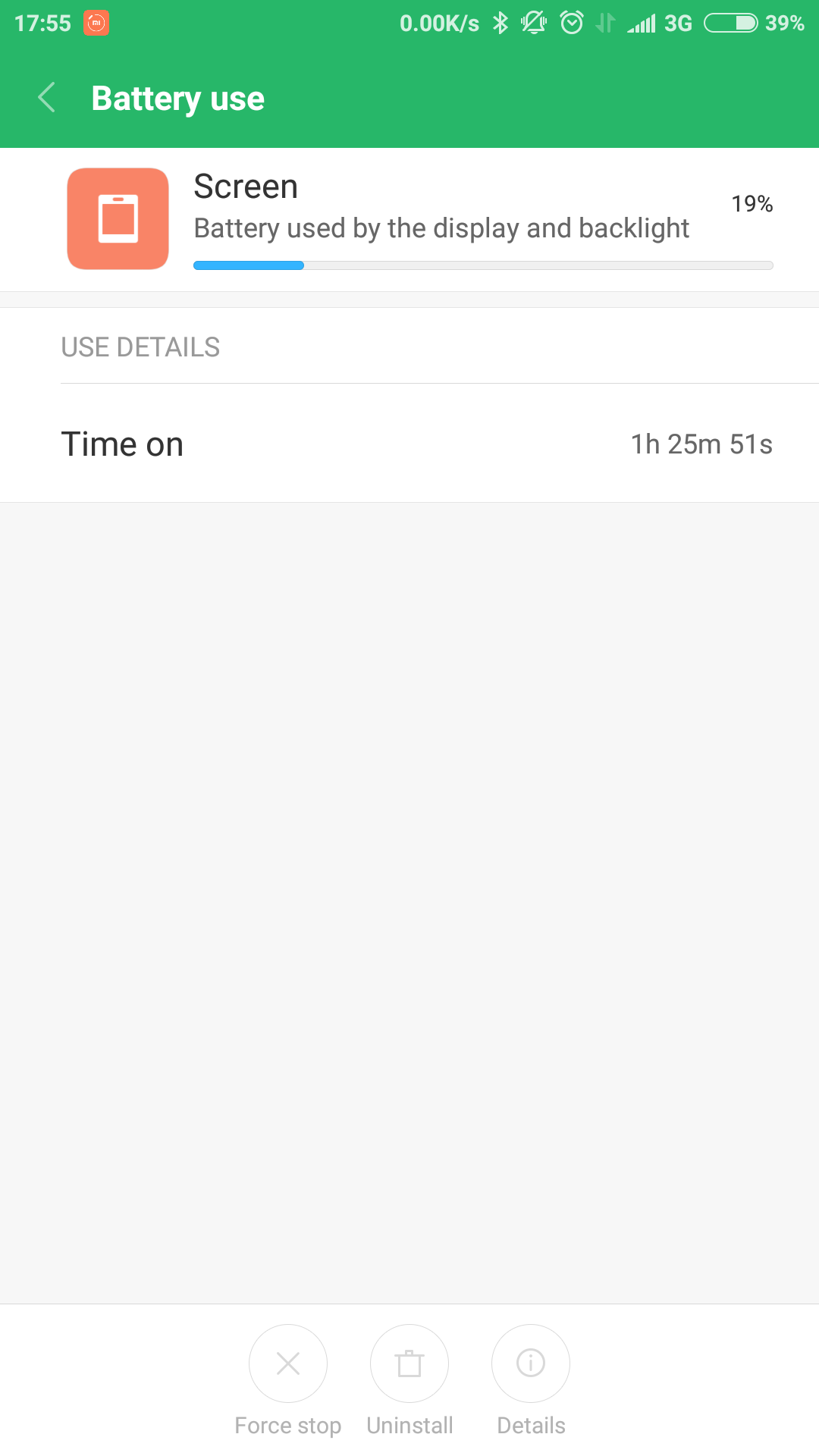

Screenshot_2016-11-30-17-54-52-130_com.miui.securitycenter.png Screenshot_2016-11-30-17-55-00-542_com.miui.securitycenter.png Screenshot_2016-11-30-17-55-05-849_com.miui.securitycenter.png Screenshot_2016-11-30-17-55-11-109_com.miui.securitycenter.png

Have you tried flashing the official ROM instead of EU? maybe it helps. if not, then the only possible answer is hardware issue. there may be some wiring or battery issues.
Phone is only two months old.
I am on last beta.
Really bad
View attachment 14411 View attachment 14412 View attachment 14413 View attachment 14414

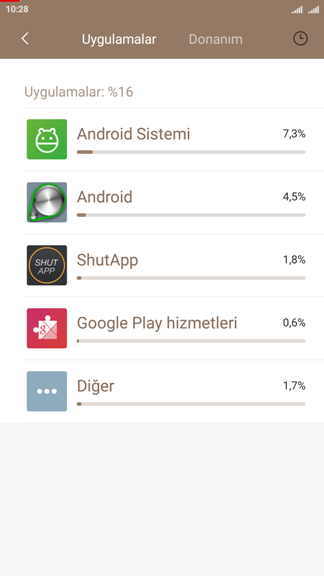

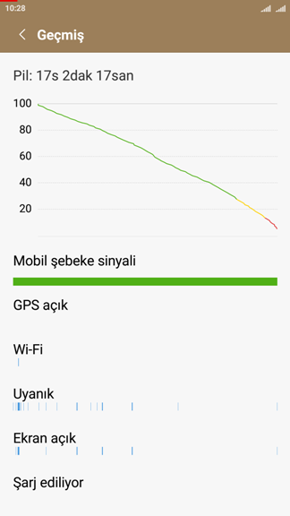

My Mi5 /64 gb w/ rom eu 8.1.3.0. (MPdecision Mod enabled too) battery consumtion can be seen on the pics.
Consumtion without any activity meaning standby consumption is enuf only 17-18 hours.
As seen nothing drains the battery but battery itself or motherboard itself..
Maybe MODEM Radio HW or SW is wrong.??

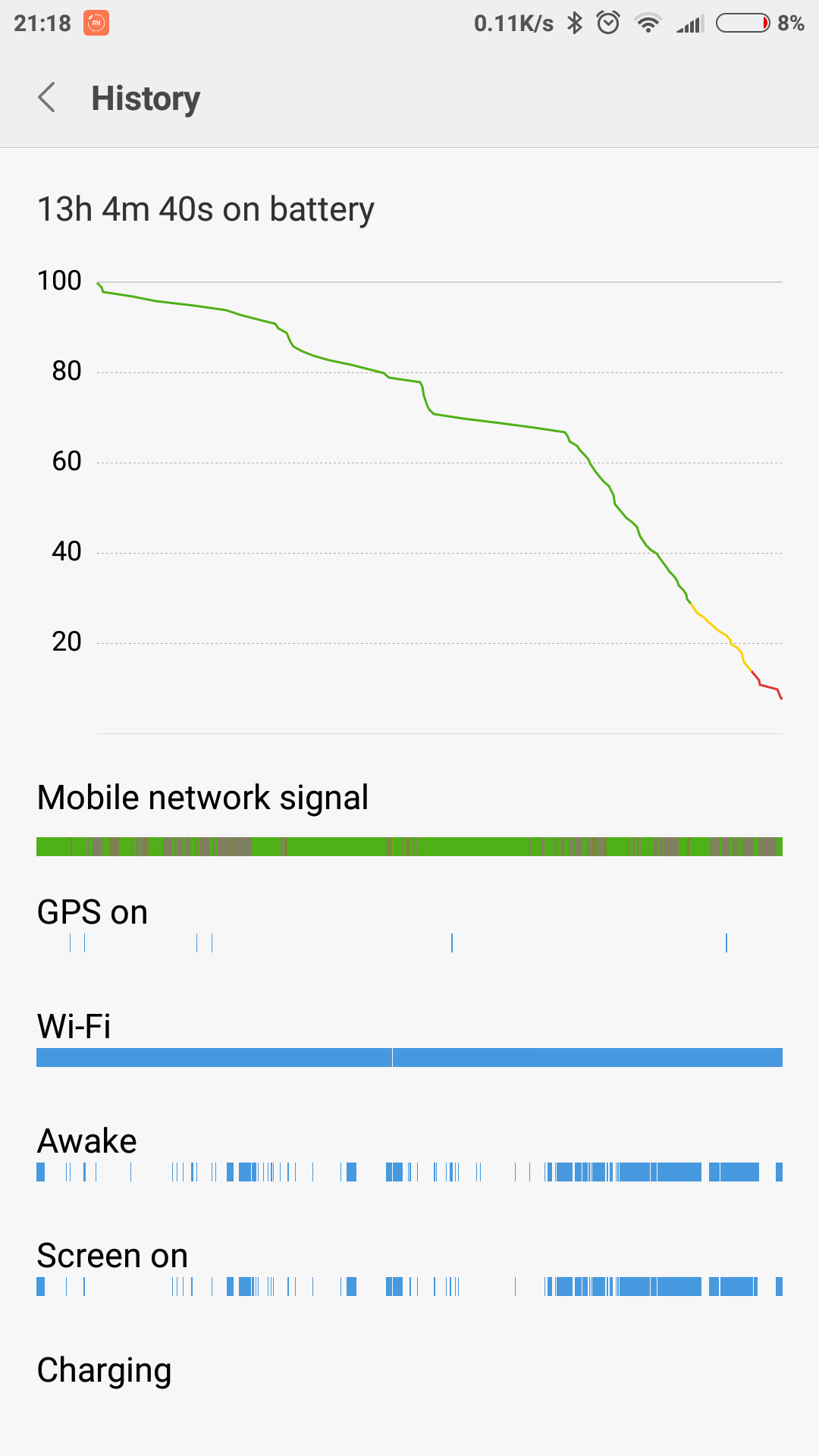

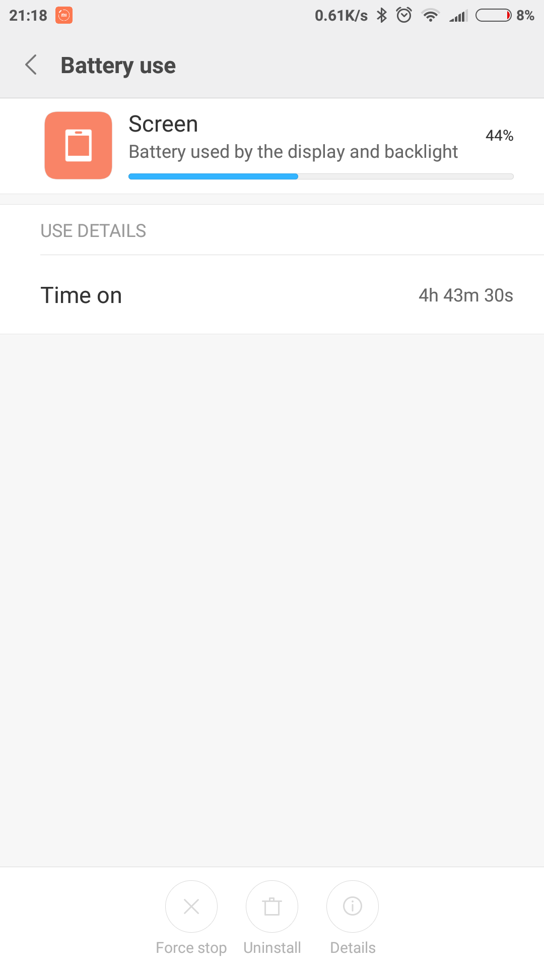

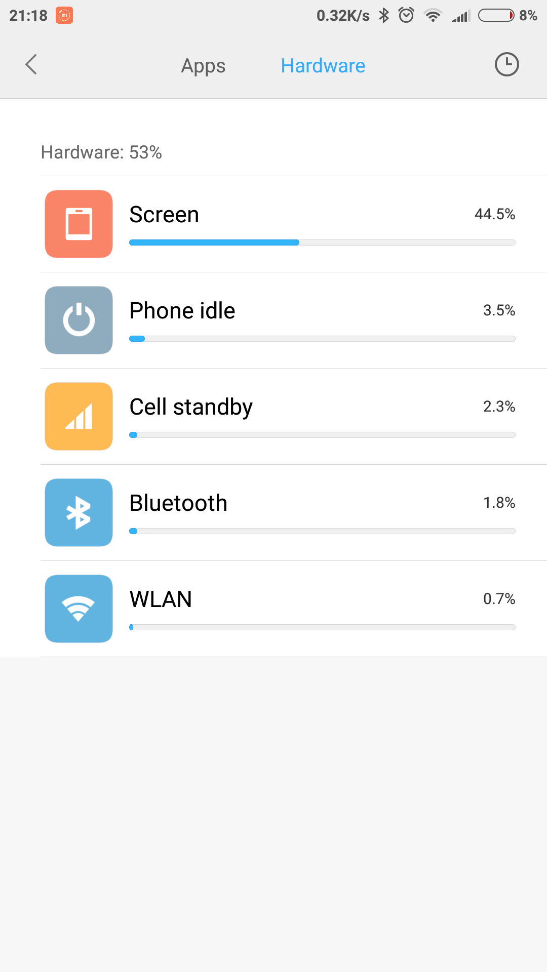

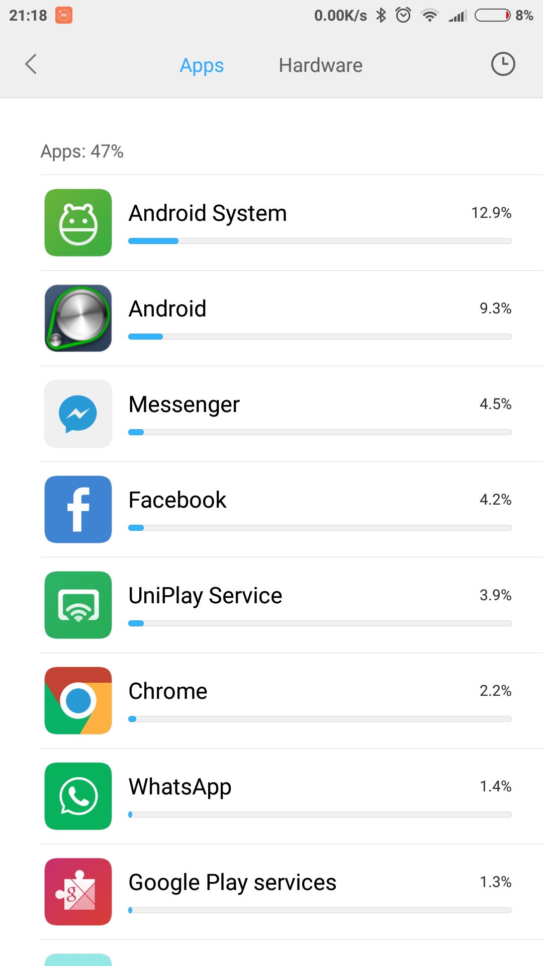

Ok, after flashing 8.1.10 my battery is much better. On developer rom my SOT was avarage 3 hours
Now is much better. See pic
Brightness is max. auto
Screenshot_2016-12-07-21-18-58-460_com.miui.securitycenter.png Screenshot_2016-12-07-21-18-51-925_com.miui.securitycenter.png Screenshot_2016-12-07-21-18-49-029_com.miui.securitycenter.png Screenshot_2016-12-07-21-18-42-320_com.miui.securitycenter.png
