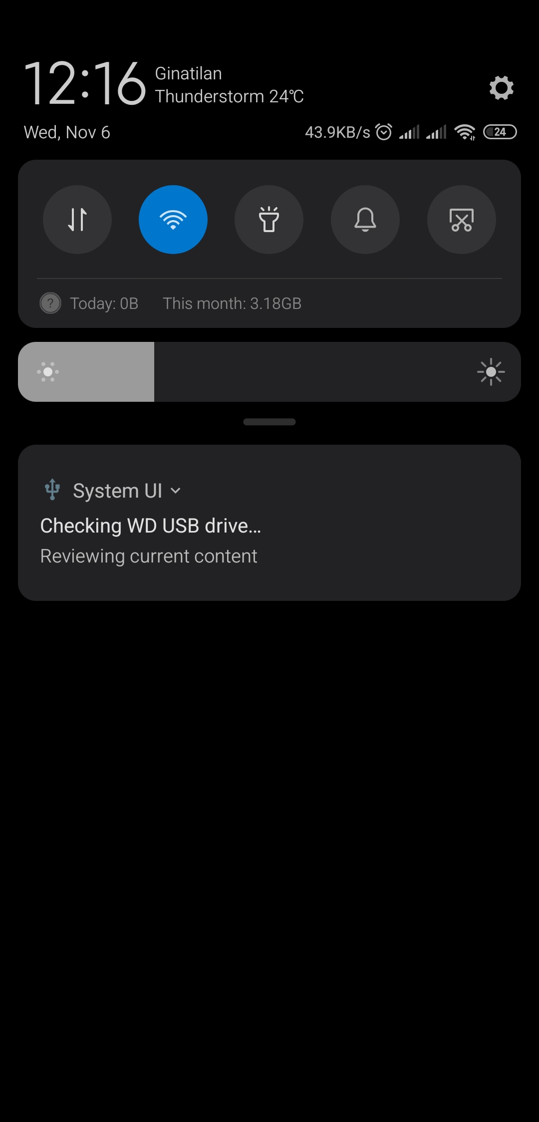

My Mi 8 restarts when using an external hard drive. Using otg with a regular usb stick or a mouse works just fine.
This started on miui 11 android q(haven't tested on miui 11 pie). Works just fine on miui 10.
