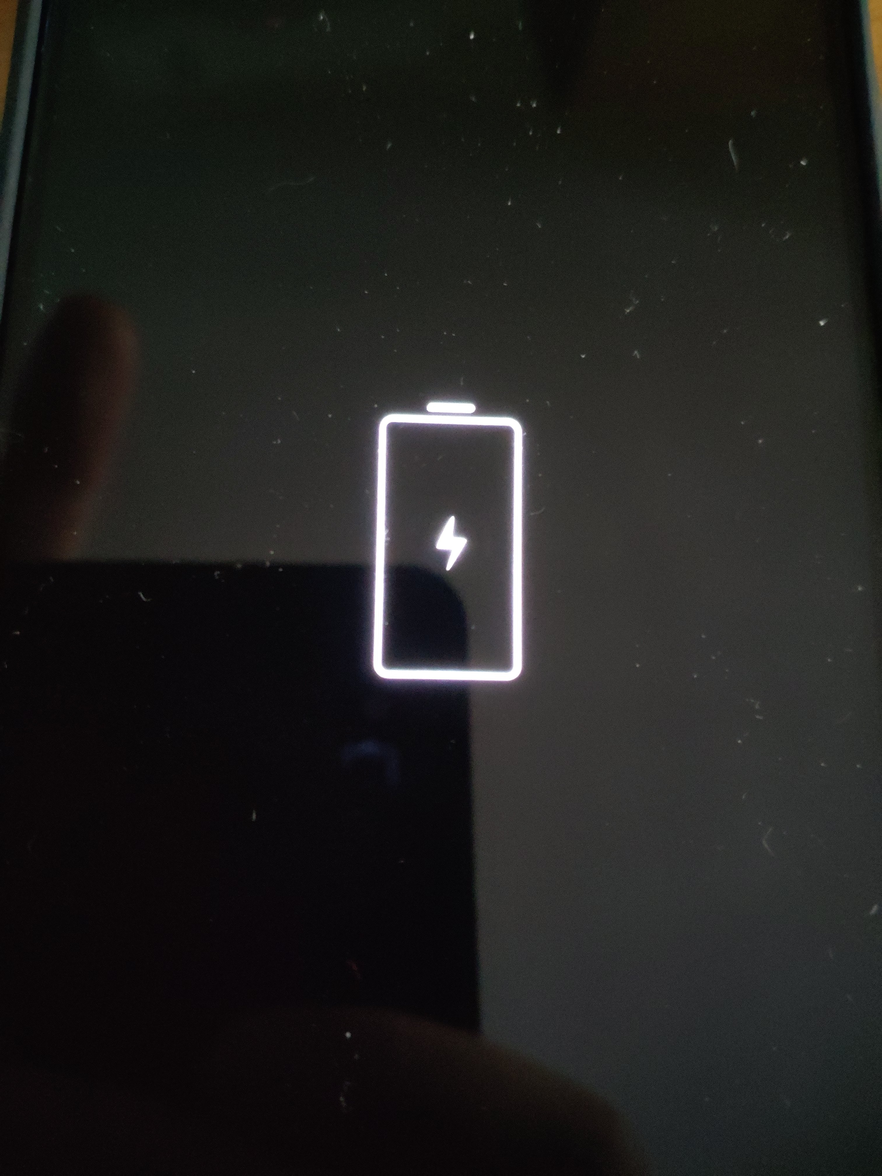

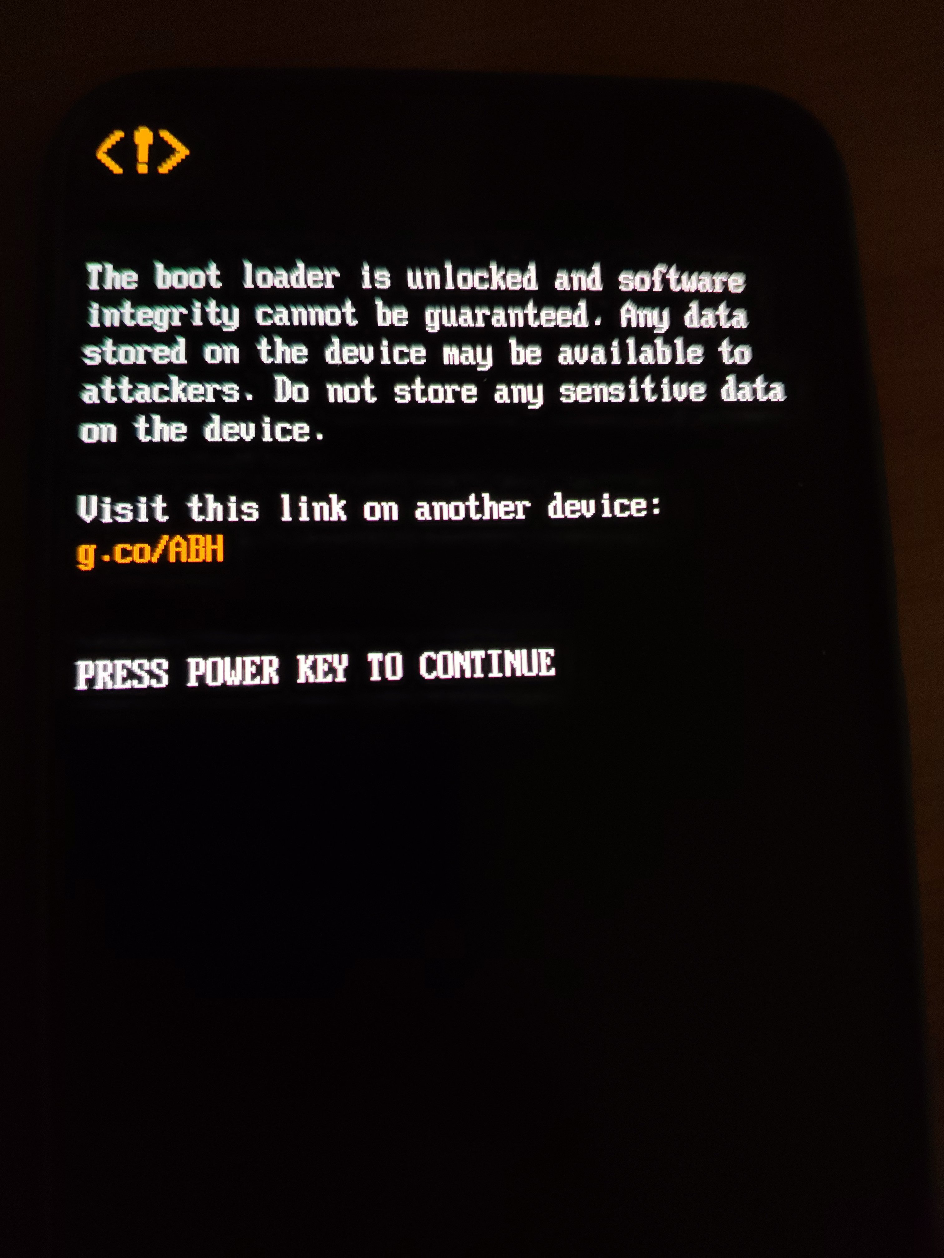

Hi Guys,
I unlocked a Mi8 today, installed the TWRP linked here in the Forum, booted on it and tried to install the Stable ROM after wiping. Somehow the installation was not successful as it appears. Now I get on every booting the notification message attached. So far so bad but do you maybe know how am I entering with this the Bootloader or Fastboot? Whenever I press Power and Volume Up I get this message and Volume down only the battery Symbol (second Picture).
Thanks for your help!

Okay after some trying I figured out wha to do. The Battery symbol is basically the bootloader. So I simply flashed another TWRP over it and then I was able to finally install the image. Nevertheless - if someone knows how to directly enter the Bootloader - I think that's still a good information.
Cheers
Hi, I get the same warning message every time I turn on the Mi8. The battery symbol is shown to me whenever it goes into fastboot mode. Any solution to remove that warning message?

I got my Mi8 today, bootloader was alreadyy unlocked. and this ugly screens needs to be removed ;)
I have tested it, it does work .... BUT only if the official global Rom is flashed,
if you flash the xiaomi.eu rom again, the ugly screen is back.
I think the reason is, that xiaomi.eu is based on china-dev rom and not global rom,
the china-dev rom has an other fastboot image.

- put your Mi8 into fastboot mode (Power + Volume Down) (Battery symbol)
- click refresh and flash ...wait 10min till finished

i think that i can solved it this problem, i dont tried it.. so if you can flash chinesse rom, lock bootloader,after unlock bootloader( wait 15+ days) for unlock and flash iaomi.eu rom maybe solved this problem.i think that chineese guys has weird way unlock bootloader
now we can change the ugly bootloader unlocked screen,
thx to chivomugroso from xda.
https://forum.xda-developers.com/mi-8/themes/bootloader-unlocked-message-t3842388
You need the TWRP 3.2.3-0918-XIAOMI8-CN:
https://xiaomi.eu/community/threads/download-twrp-for-mi8-dipper.46551/post-445428
- Download logo.zip:
https://mega.nz/#!Yw9GQaBB!6Lt-CIBqbrs1Py3cPacFbVPuJeUoW24isbw1rhtWU-I
- unzip logo.zip
- copy logo.img to your Mi8
- start Twrp -> Install -> Install Image -> logo.img -> select Logo
- confirm
- done
