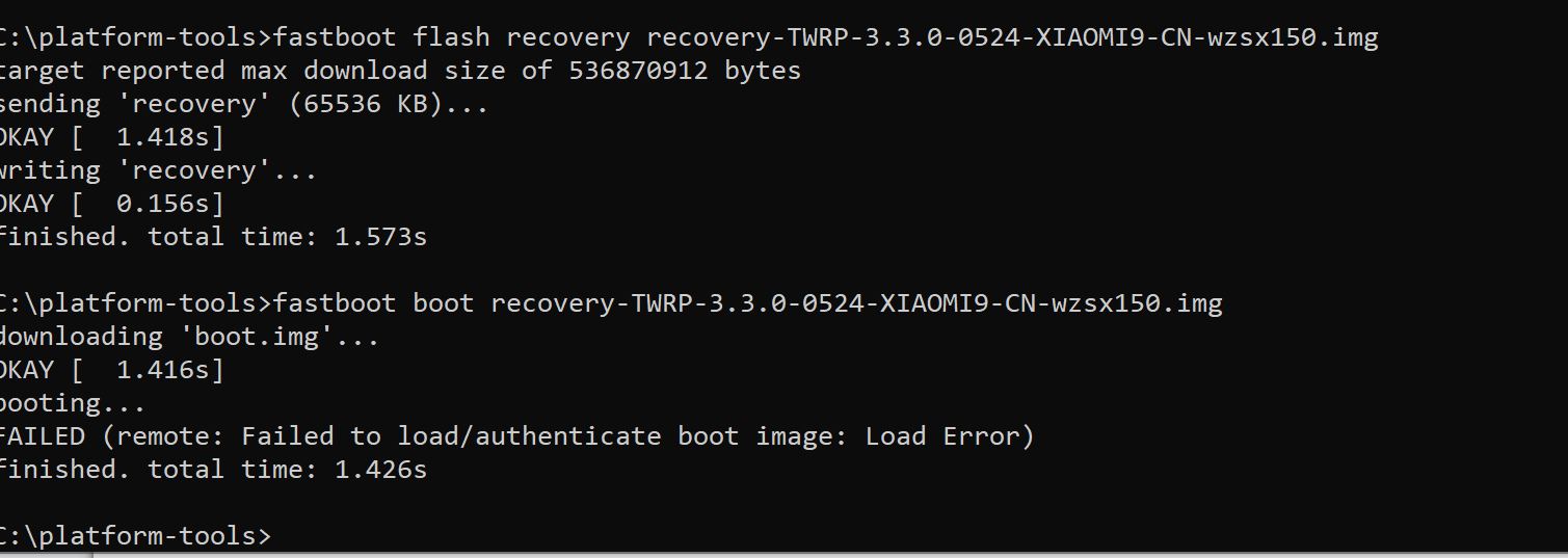

MI9 dosnt go to recovery
ZIMMT.IL
Jun 8, 2019
5
5

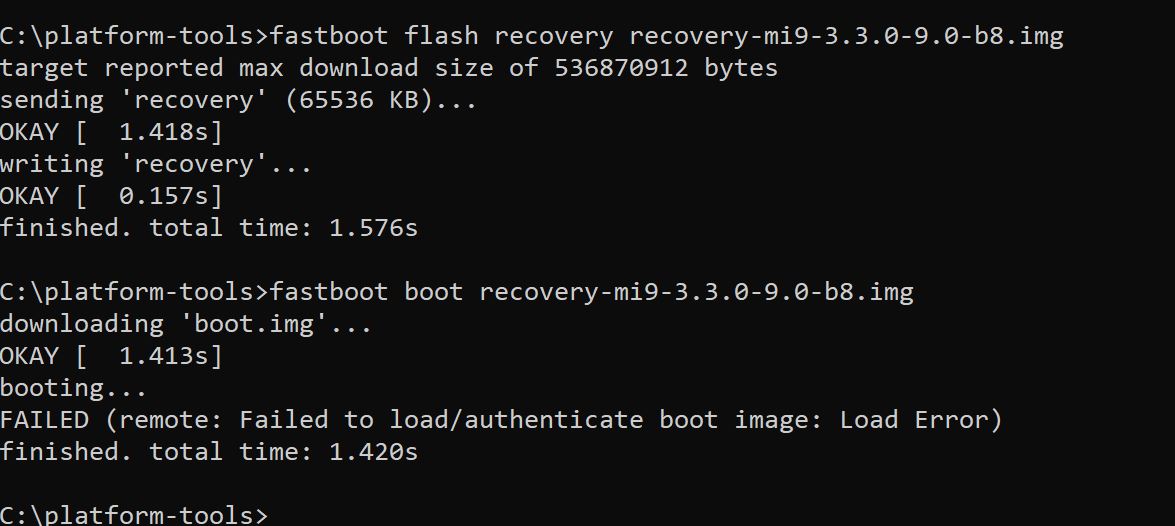

after I flash the recovery I do wipe, after that have some problems and mistakenly Showdown the phone end after that the recovery doesn't enter, try to flash recovery and enter one more time (attach), and also the recovery doesn't enter (I try two versions of the IMG and failed to boot in the recovery mode). How I procede?

Hi. Had the same problem. For me it worked when I restored it using MIFlasher tool. Then following there guys on this thread. https://xiaomi.eu/community/threads/unable-to-boot-into-recovery.50316/
Think there is a problem with some twrp. I tried many of them, but this one worked. Now am currently on the latest weekly update and can enter recovery on mi9.
The installed twrp is in chineese, so google how to change it to english:). And i did factory rester in twrp and advanced wipe. Hope this helps

Thanks, I do this exactly and it's work!
