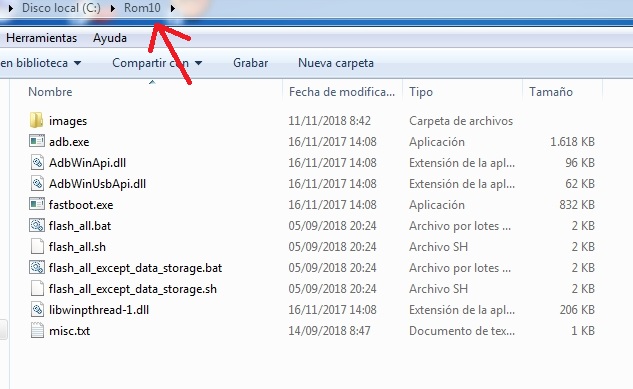

2. Unpack that ROM until you see “images” folder and copy to PC and name it as Rom10 (or any name you want, “123” or whatever, but with no blank spaces)
Your folder must look like this:

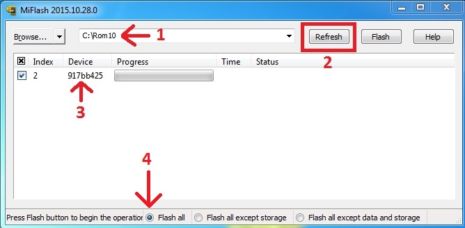

4. Run “MiFlash”(20151028). Browse to ROM folder in "C" and press `Refresh´ if phone doesn’t appear in MiFlash.
5. I chose the option: “Flash all” for a clean install. That’s the one I did (so I don’t know what would be the result if you choose: “Flash all except data and storage” to keep internal storage)
Flashing should take between 4 or 5 minutes.

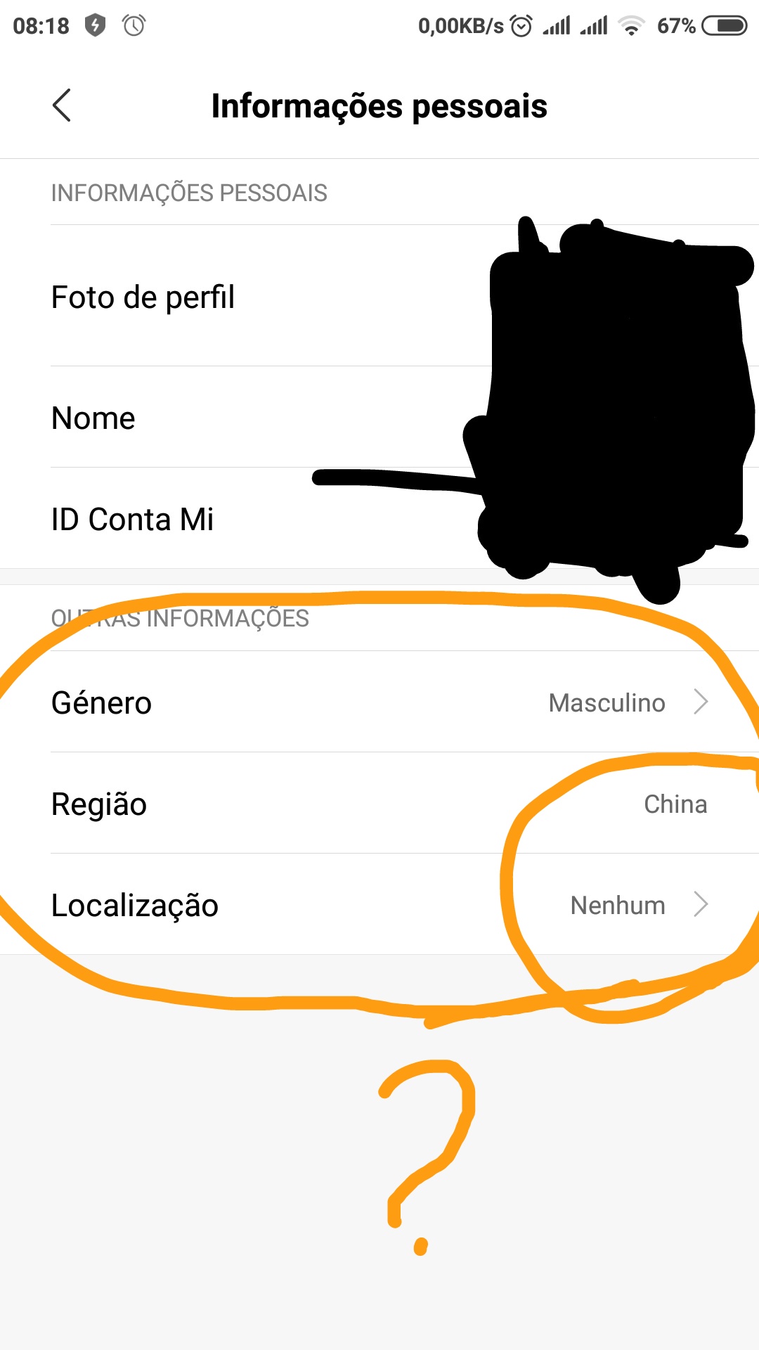

Hello!
My device: region- China.
How can i Change That?
