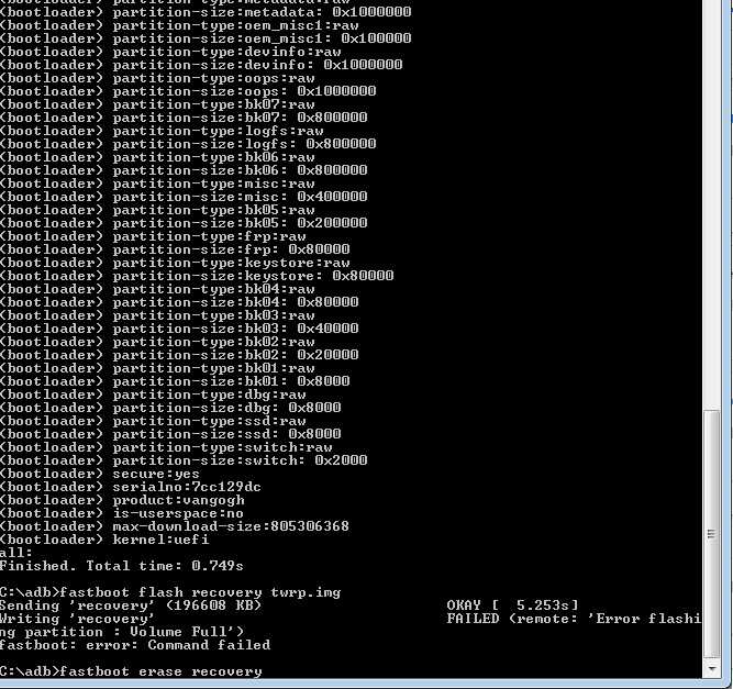

good day!
pls, advise, maybe some one met the same before. what the problem could be, trying to install twrp via fastboot, but writing failed??
attched scrn
device mi 10 lite zoom 6/128
currently in bootloop fastboot

good day!
attched scrn
Don't know where you found that TWRP, but it's not TWRP for your device. There is no recovery partition as large as 196,608 KB.
It looks like a TWRP that's meant to be booted using "fastboot boot twrp.img", but it's definitely not TWRP for your device.
Reactions: karsteghinaev
oh maybe I mistakenly tryied to load another one. and when see it's not loading, erased recovery patrition via fastboot command. and since than moment my device in bootloop to fastboot mode. no any action can bring him to other mod/ only fastboot.
could You, please, advise how to be!? realy question of survival.
if flash previouse TWRP in to recovery via fastboot can it help!?
many thks
good day!
attched scrn
