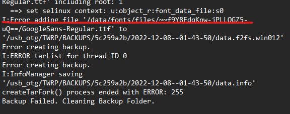

Yeap this is the fix delete the /data/fonts/files and your ready to go
