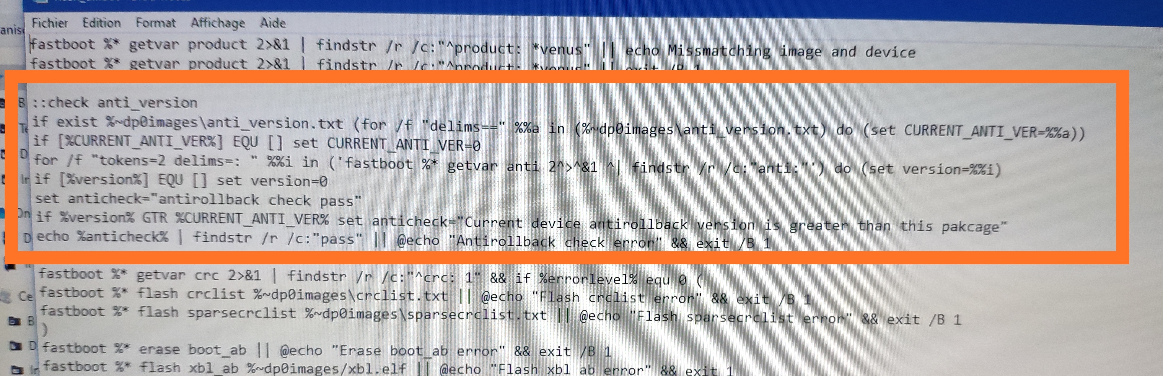

Thank you very much so if I understand correctly I download a rom for example 12.5.11, I unzip it and delete the command line as in the photo and I flash with miflash?

Correct. M'a donné une erreur à la fin quand j'ai bricolé vice versa avec des roms mais il a démarré correctement sur Mi 11. Assurez-vous de ne pas sélectionner le verrouillage sur MiFlash.
yes I saw that there was an error at the end and I was even surprised that the phone went back up anyway!
