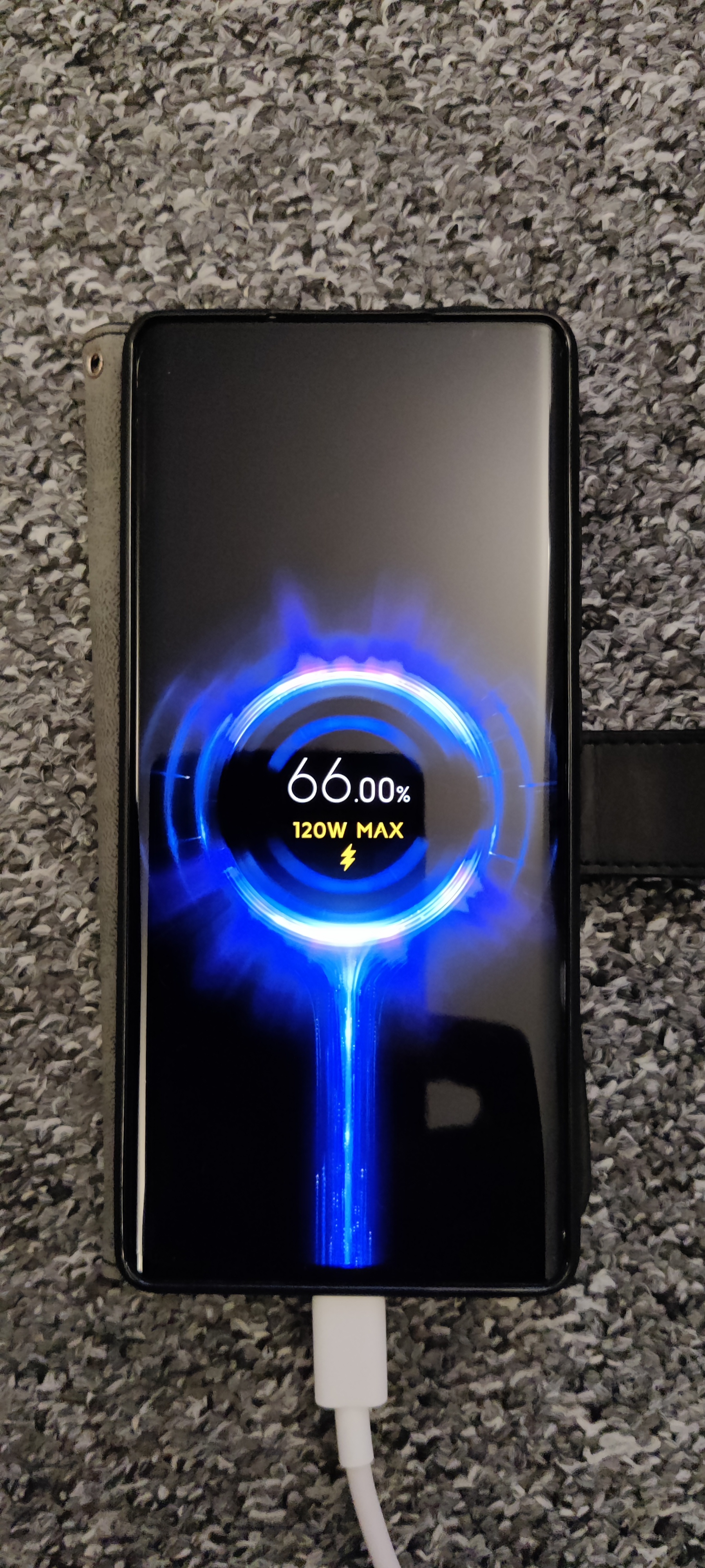

75
Strange my mix 4 is charging fine, 120w 22 mins, although i have lost the boost setting in the charge menu, used to get 17 mins with that, not sure if thats a bug or it was removed for some reason.

Edit: My fast charge works fine! I just noticed that I mixed up my Xiaomi white charging cables and was using the one from my Mix 2S the whole time. So embarrassed. Wasted so much time reading and reflashing. Your results made me reconsider everything.
