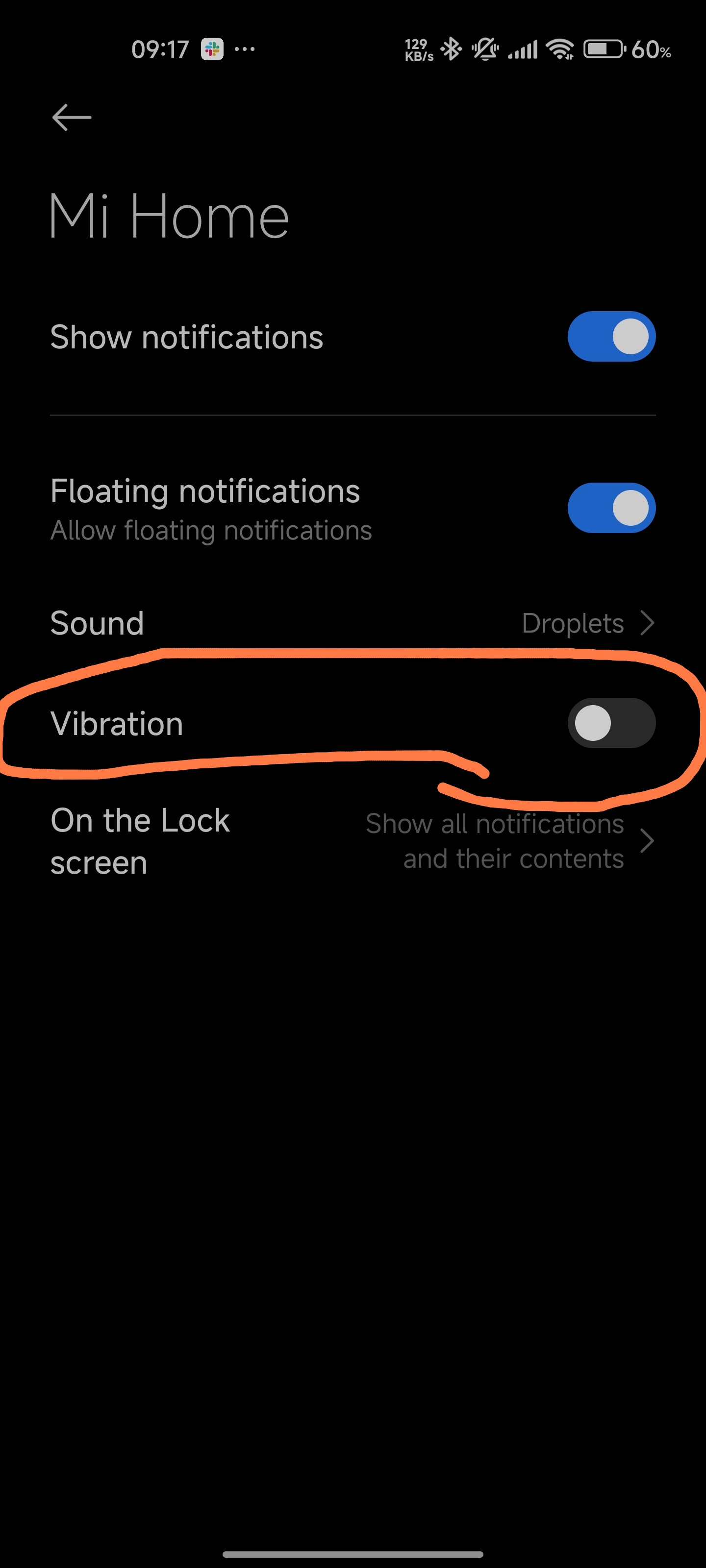

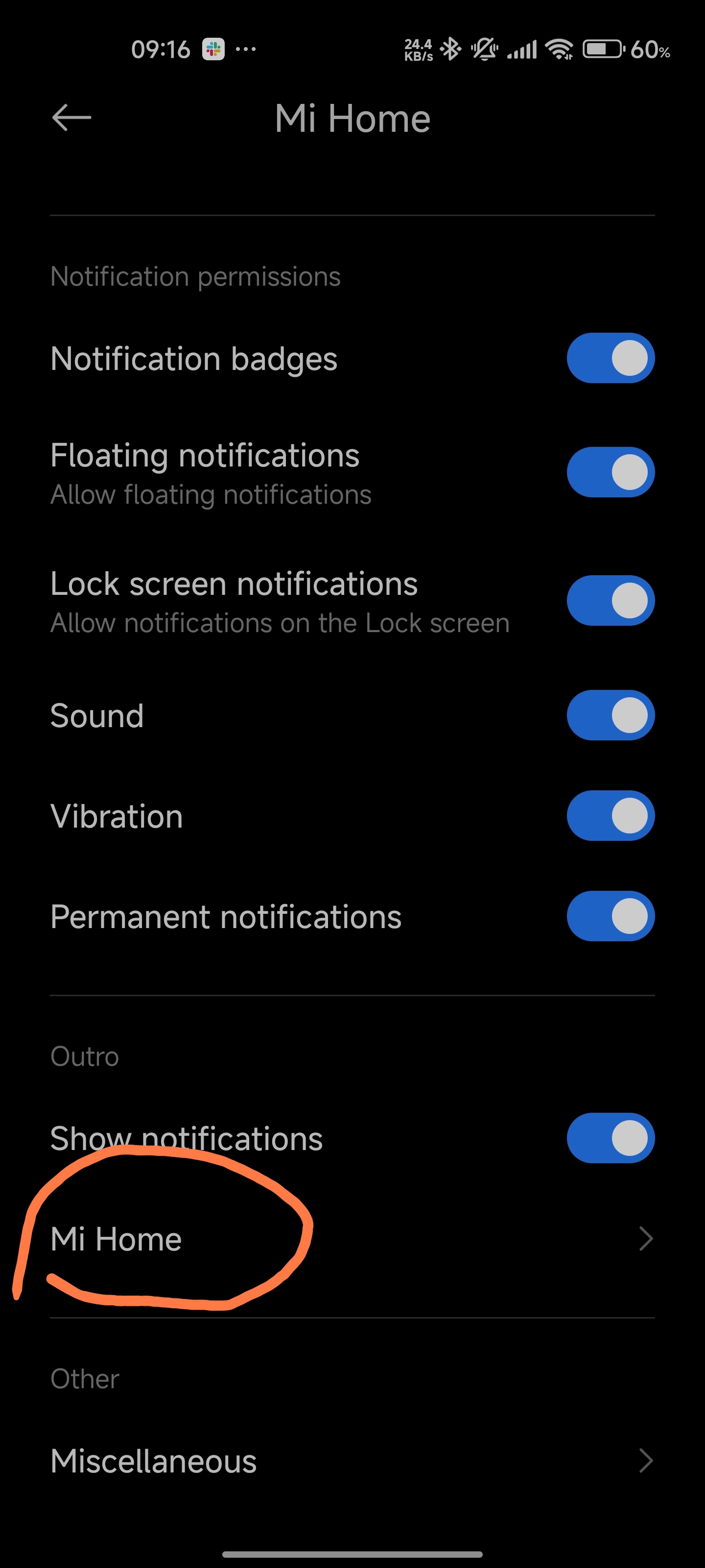

I have a same issue. No sound notification when someone rings. Is there any solution how to sort it out?
Finally I have sorted it out. Go to Settings - Apps - find Xaiomi Home app - than click Notification - Allow playing sound and than at the bottom click - Mi push - there you can choose sound type. Hope you will sort it out. Let me know.
