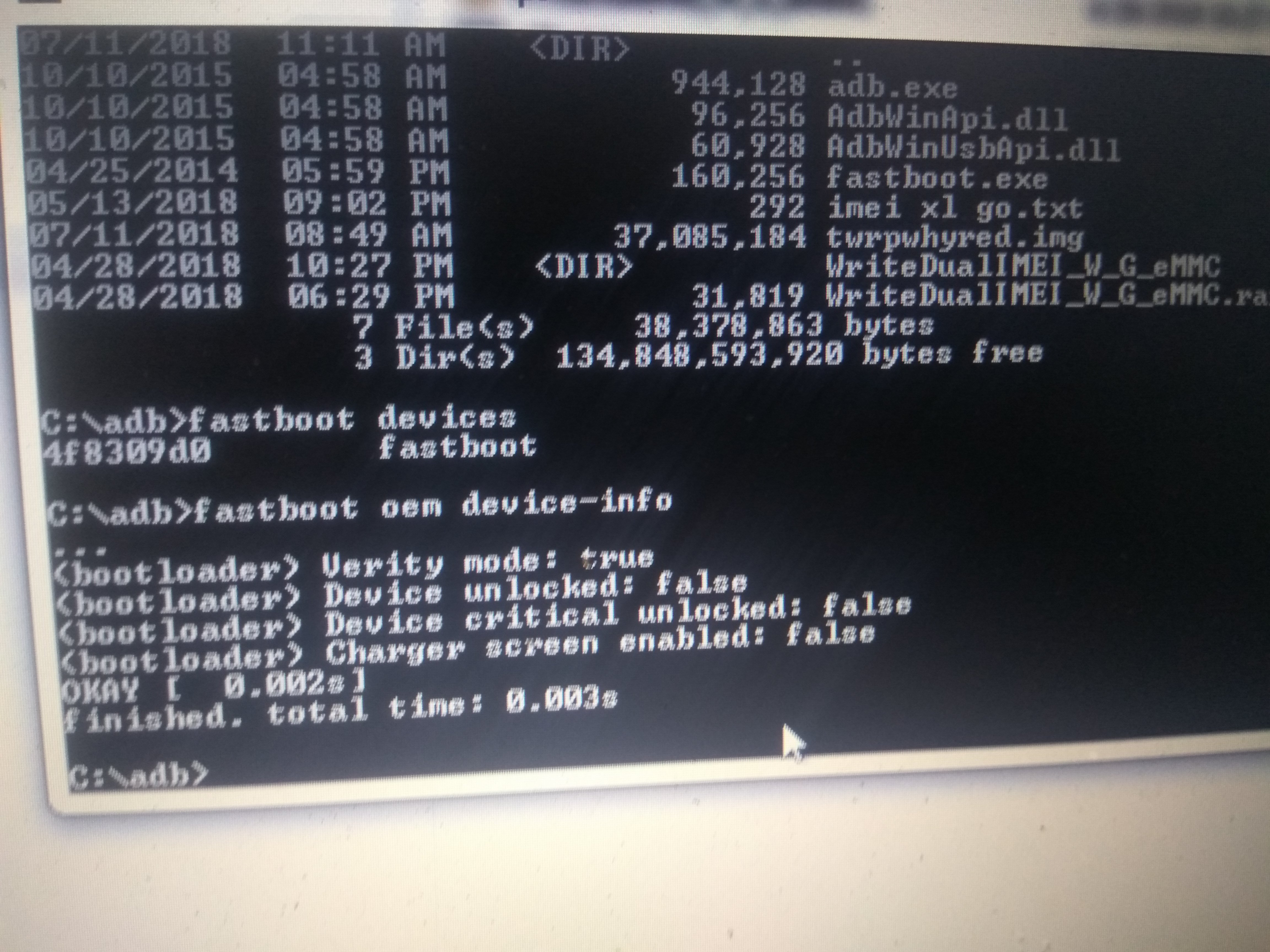

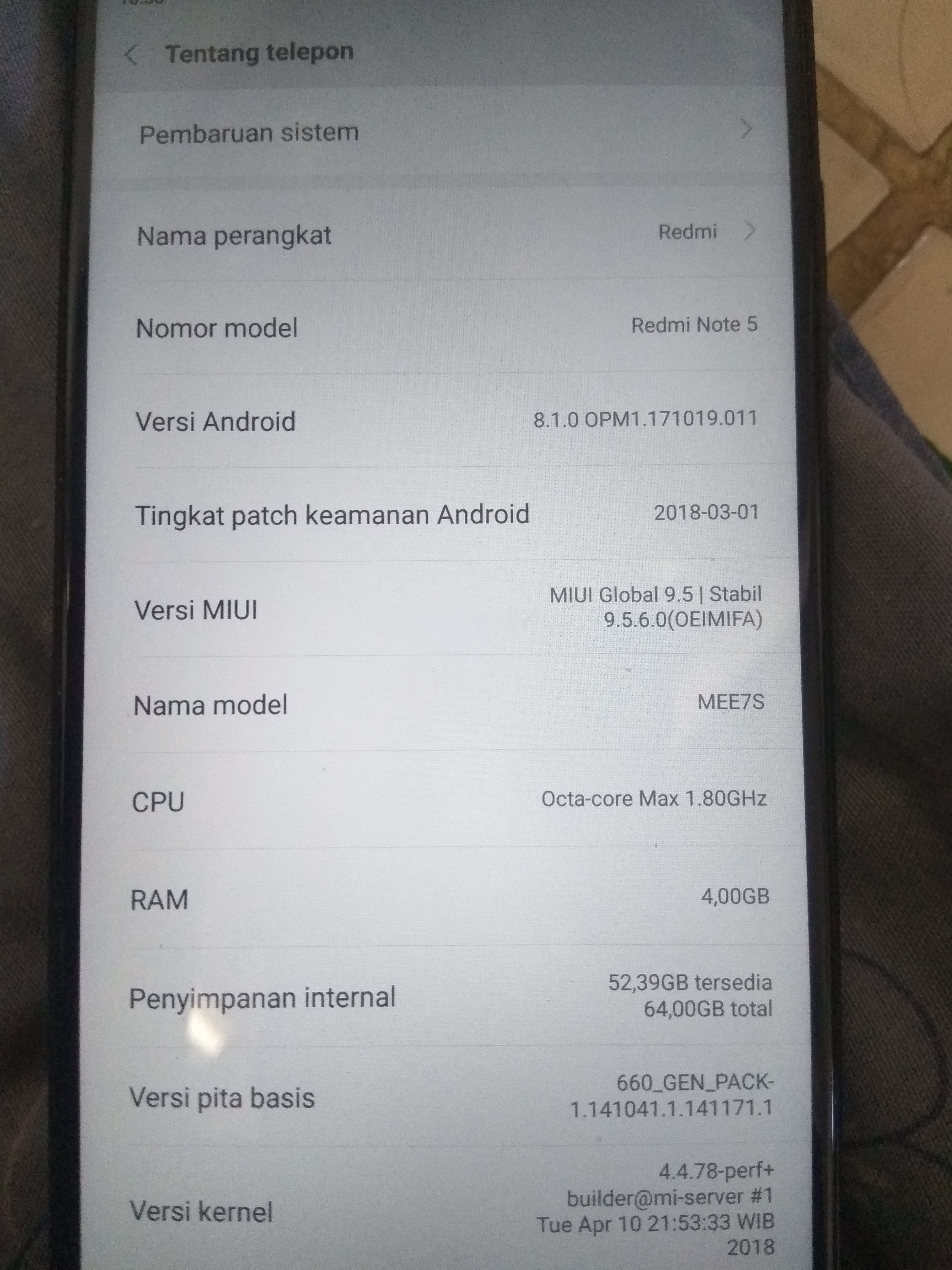

please i need help
i ordered redmi note 5 , but i got chinese version 4/64
my problem is bootloader is lock, i iwas checked on fastboot oem device-info
and then my rom version is
i got update officialy but always stuck in 99%, is not allowed to uodate from xiaomi update

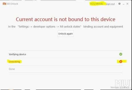

then i tried to unlock via miflash unlock tool,
is show message this account not binding to this devices
Aug 26, 2016
27
1
#44

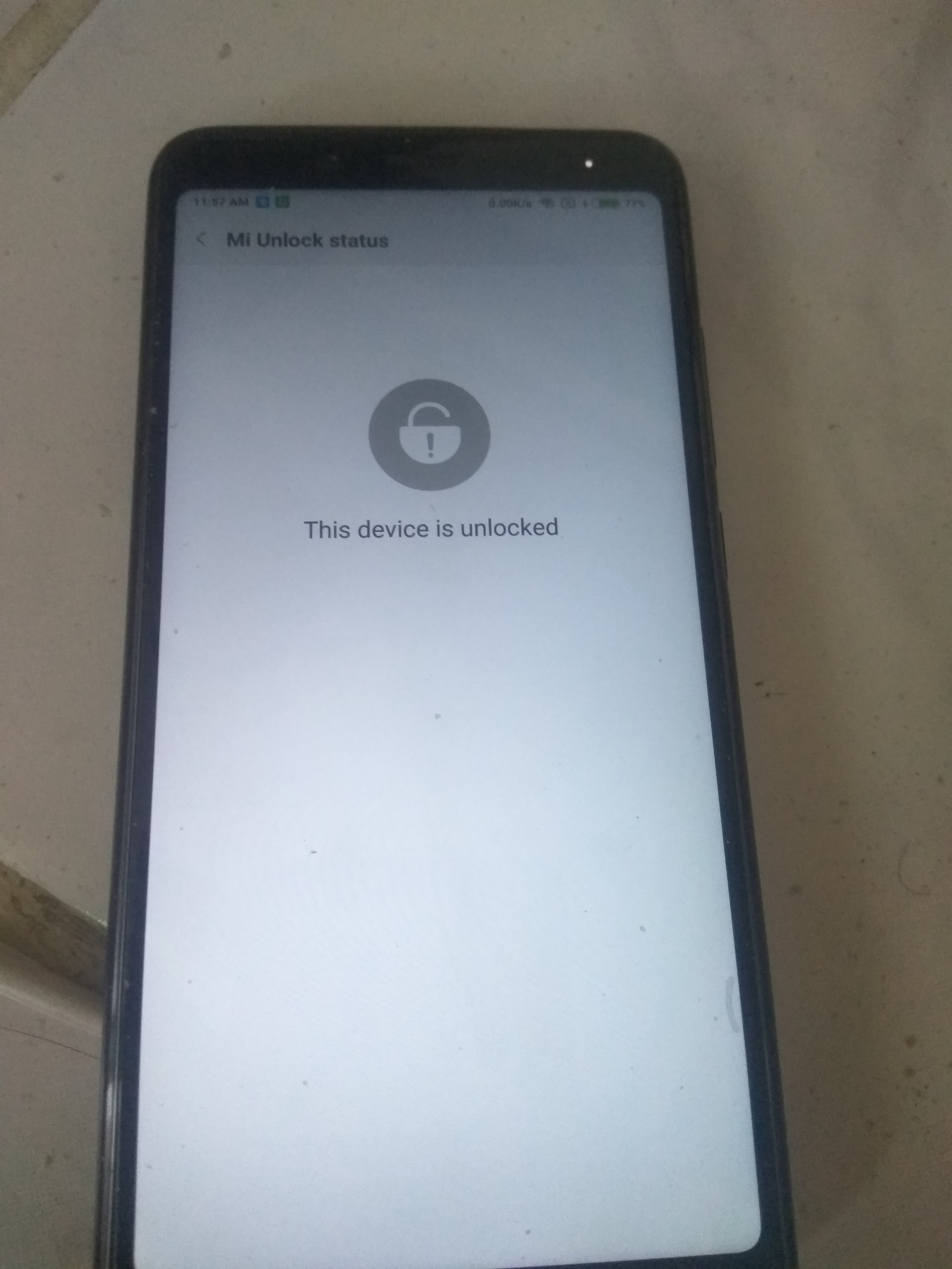

is show i to add account and device in devloper options but, i cannot find to add account
like this
i think i get fake ubl and fake rom
what should i do ??
