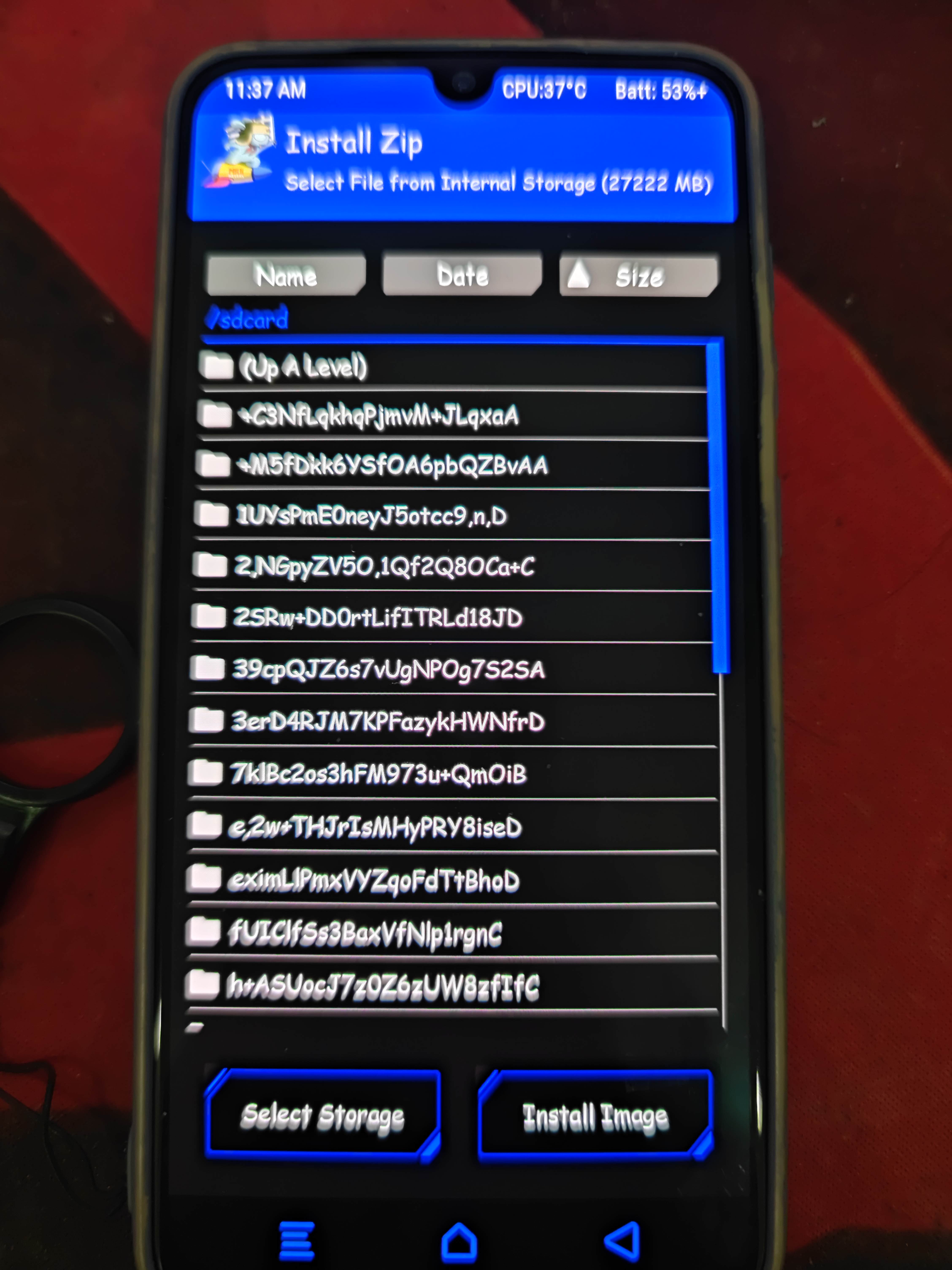

Hi, I am using this version of TWRP 3.5.A9-H-12-02-2021. Anyone knows what's wrong with this /sdcard content?View attachment 36777
Hello what you see is files encryption, used to protect your data. ;)
Your current TWRP doesn't seem to know how to decrypt your data (should ask your PIN/password/pattern used to unlock the screen of your device). What's your current ROM version?
What you can do:
-> Try to set a pattern, instead of a PIN/password, to unlock the screen of your device.
-> If TWRP doesn't ask your pattern, try to use another TWRP:
Latest Official version => twrp-3.5.2_9-0-grus-TeamWin.img -OR- @geoanto555's version => twrp-3.5.A9-grus-geoanto555.img
