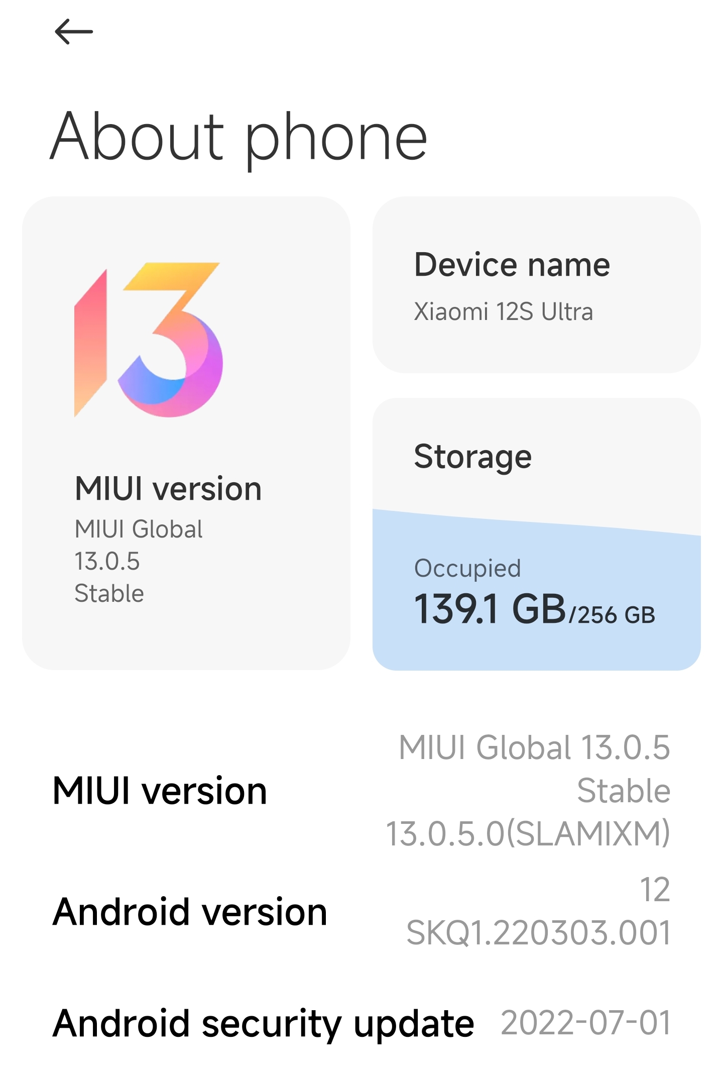

Hallo Guys im new here and im stuck with 13.0.5 stable(SLAMIXM)global and security patched july 2022 last.
My galaxy 4 watch is not supported, is there any new global rom update available?
Please help!!!
Are you sure about your ROM version? There is no Global ROM for this device.
Show us a "device information" screenshot.

If the model number is 2203121C, you have a fake ROM on your device that will not receive any update.
If you have an unlocked bootloader, I recommend installing a custom ROM from xiaomi.eu.

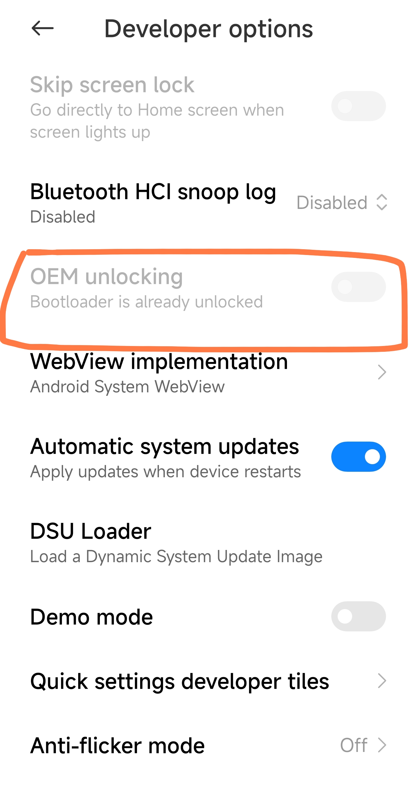

Please help me get the link my bootloader is unlocked

I dont see that on my phone but from developer option it show
