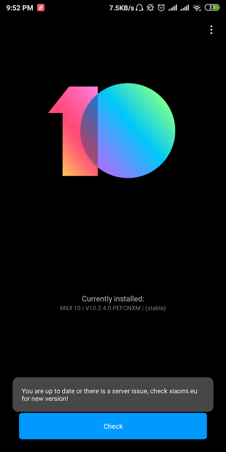

it still doesn't work for me either on Pocophone F1. it hints me that maybe it's a server issue or my phone already up to date.
Sorry for inconvenience, I managed to fix it of course. New stable will include fixed Updater.
For future assistance please PM me cause I do not really follow stable channel, I focus on dev one more.

I used to check Bugs section then turns out users talk about Updater in other sections as well. I wish people mention me posting reports. I use dev rom daily so I never faced the issue. I recently realized (after receiving PM) that at some point we changed download url a bit and it was the problem problem.

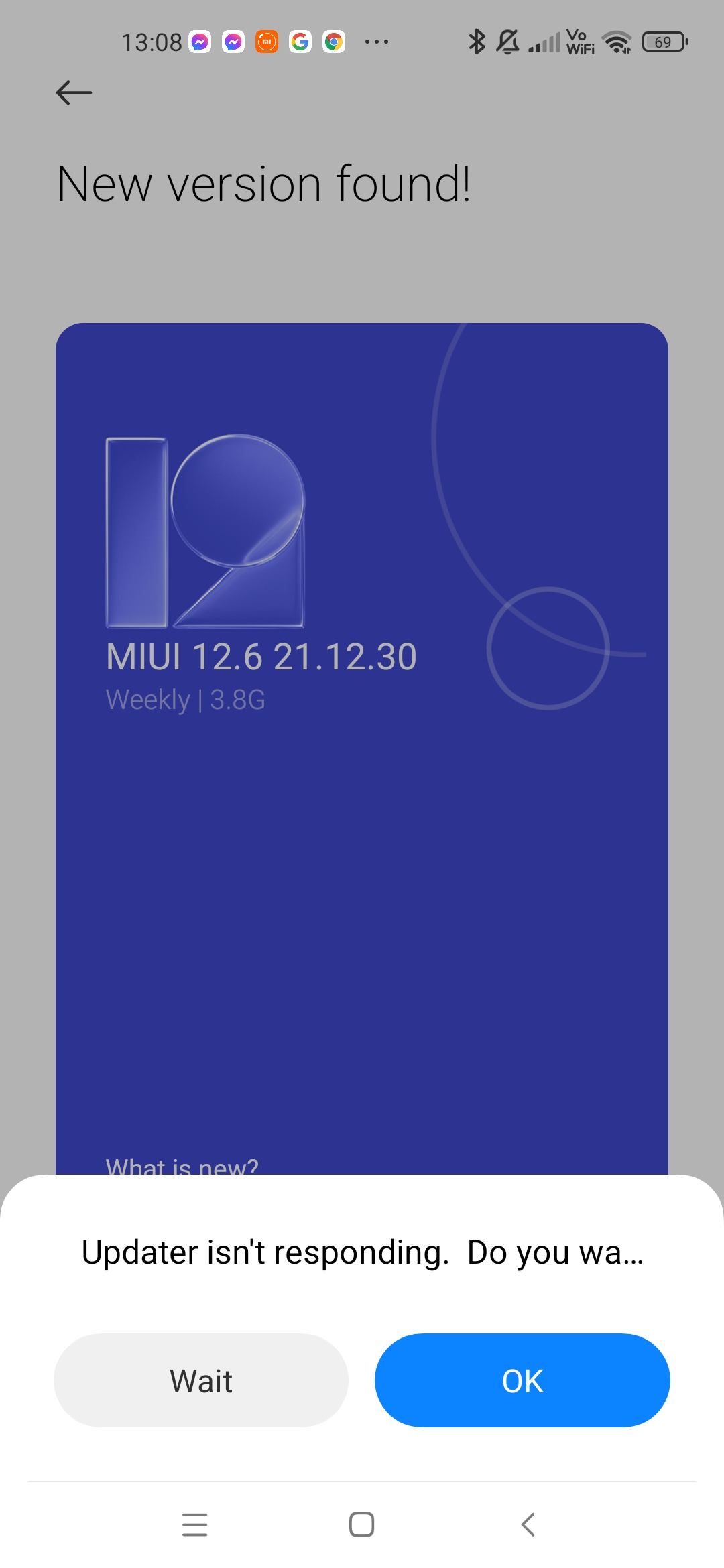

Hello , Happy new year . How to update ? All time show me updater isn't responding .

You didn't write what the model was. If it's an update with android 12 the procedure is as follows.
- Download our ROM zip file
- Unpack downloaded zip file in the PC
- Connect to PC via USB cable
- Run fastboot installation script from unpacked zip according your PC operating system
For Windows OS - windows_fastboot_update_rom.bat
For Linux - linux_fastboot_update_rom.sh
For MacOS - macos_fastboot_update_rom.sh

Xiaomi Mi 10 ultra - EU ROM
