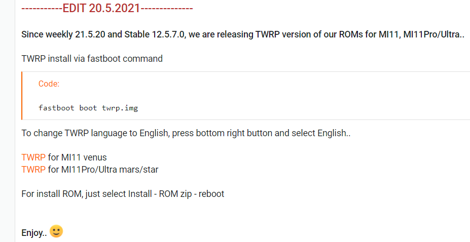

Thanks I just saw your earlier post and managed to get TWRP installed by installing the older driver from MiUnlock, THANKS. However now I can't seem to get into TWRP on the phone by Power+Vol UP... I get Mi logo, a vibrate, blank screen then when I let go, it still defaults back to standard phone login
Did you install the latest Xiaomi.eu ROM? If you don't install the latest Xiaomi.eu ROM, you have to "Inject TWRP" (in TWRP, it's in "Advanced" menu). ;)
You know what.. I am dumb.. just deciphered your keypress instructions... its powerup+vol up, then let go of power key n continue to hold vol up key till twrp stsarts... got it! Thanks

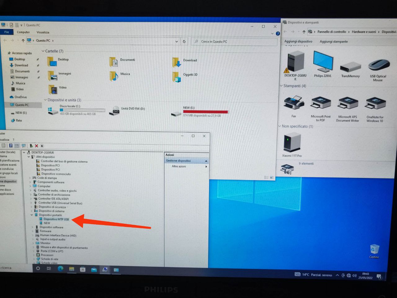

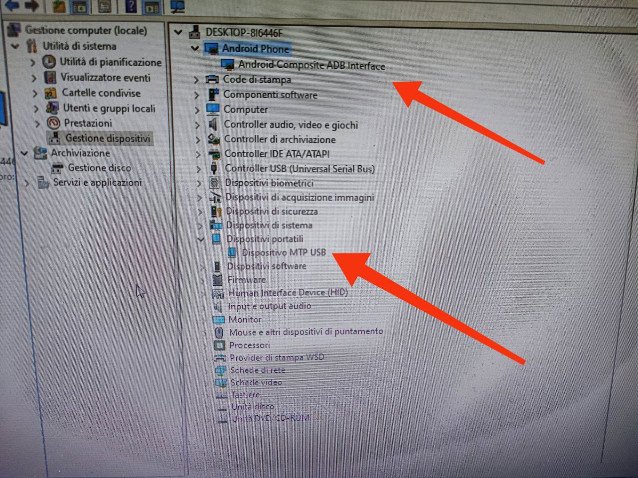

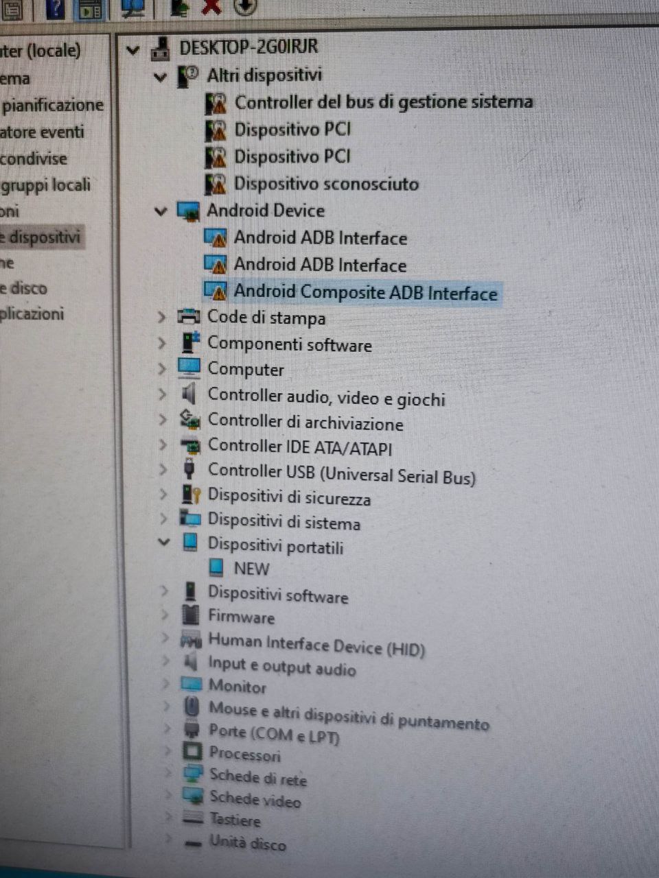

Hi everyone, sorry I wanted to ask for help regarding this problem: I have an 11t pro unlocked, rooted and with the latest stable version of xiaomi.eu. I can not connect it to the pc, in the sense that the pc recognizes it but does not activate the usb debugging to transfer the files. I state that I have installed all idriver in all ways also by means of miflash, I have changed pc, cable, usb ports. Usb debugging is enabled by developer options. I do not know what to do. In my opinion the problem lies in the usb debugging service of the phone. (other xiaomi phones read quietly) Can you help me? thank you
Is there no notification or is there a notification and no MTP available?

    • Install USB drivers
for driver look here…
I have installed the drivers in all ways !! but can I reflect the same rom? do I lose everything?
You can try to search on Windows Update for optional driver updates. I did this (Windows 11) and got updates for Android adb and composite interface, two of them, I don't remember exactly the names.
After that I did reboot the computer and also the Xiaomi device and then it was working. Good luck.
