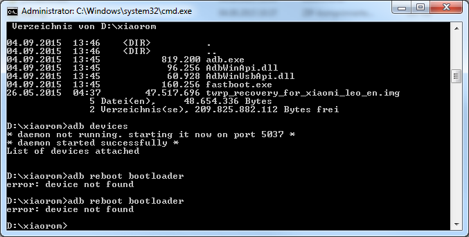

I tried the update step by step. After step 6 I write (as described) adb reboot bootloader
Then I get the following message "error: device not found"
What's wrong?
Thanks for help
Rene

Is the Mi Note Pro connected to the PC? Are the drivers installed? From the message I understand are not.....
Quick answer :)
Phone is connected... on notify screen of the phone I see "USB debugging connected"
Drivers? Did I miss any step?
And I see the Phone in Win Explorer ...
Rene
I got it... Installing this driver
https://drive.google.com/file/d/0B1k7jnFdJrUzajhnMmJaMGZxUE0/edit
Now it works
Rene
Good, you found it yourself! I dont know for the eu rom, but the greek has twrp inside, so now every rom can be installed from there and doesn't need abd. Check if the eu has, otherwise install the greek rom, which is multi, and after that from update-> reboot in recovery, you will be entering to twrp and install the rom without any problem.

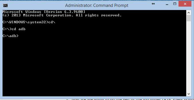

I have been trying for about 10 hours now to root my new Mi note pro. I have tried everything I can find on the internet. every different app, trick, one click solutions and pc programs.
I follow every step of this guide but nothing is working.
When I type in "cd adb" it just says "the system cannot find the path specified." in dos.

Something your are not doing correctly. Set the name of the folder abd. The message you get means that you misspell the name. Also, I don't know for the eu rom, greek rom is root and includes english. But you have to install it the first time using my guide.

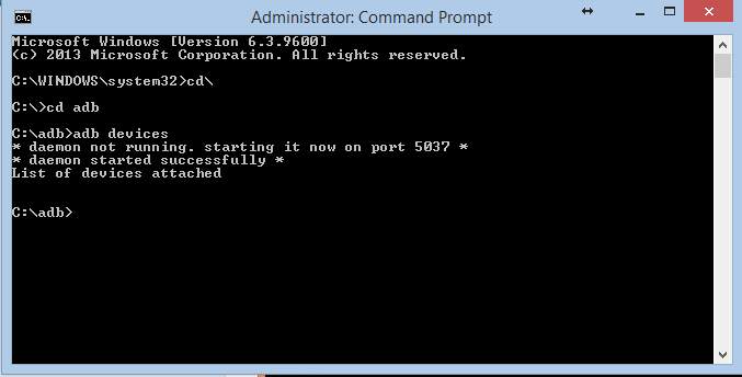

5. Now we are going to do the rest of the job under DOS. Press Windows Key + X . From the menu appeared, choose Coomand Prompt (Admin). When the DOS open, we write cd\ and cd adb as shown.
6. Now We connect our mobile with the pc through USB. At the DOS window we write adb devices

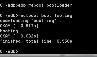

i have typed adb reboot bootloader
And de device reboots in fastboot mode butt i dont see MIUI MITU
And if i type fastboot boot leo.img
i get this
MI-Recovery 2.0.1 appears and i still cannot intall the ROM
What is the problem here?
Regards
René
I'd say you don't have twrp, you are booting into MiRecovery instead of twrp. Check if leo.img is the correct twrp image

The correct for flashing twrp with the use of fastboot is
fastboot flash recovery leo.img
IAfter that we type fastboot boot leo.img
