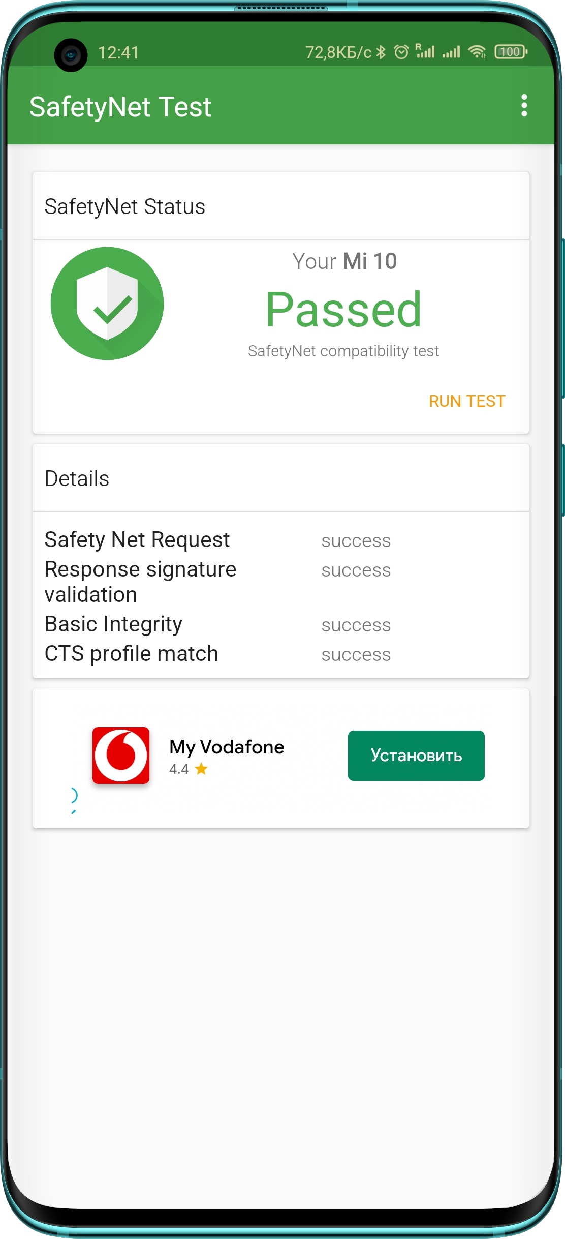

You can use MagiskHide Props Config Module and switch to Mi 10 fingerprint to pass SafetyTest, then GPay and most banking apps work.
