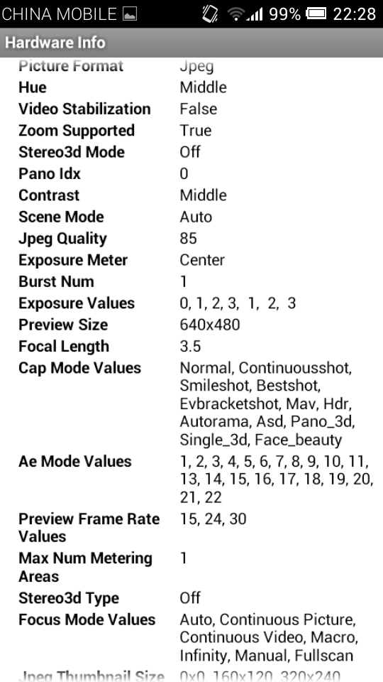

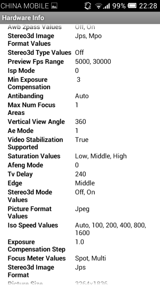

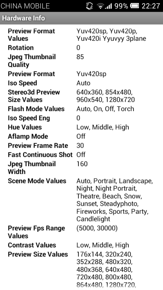

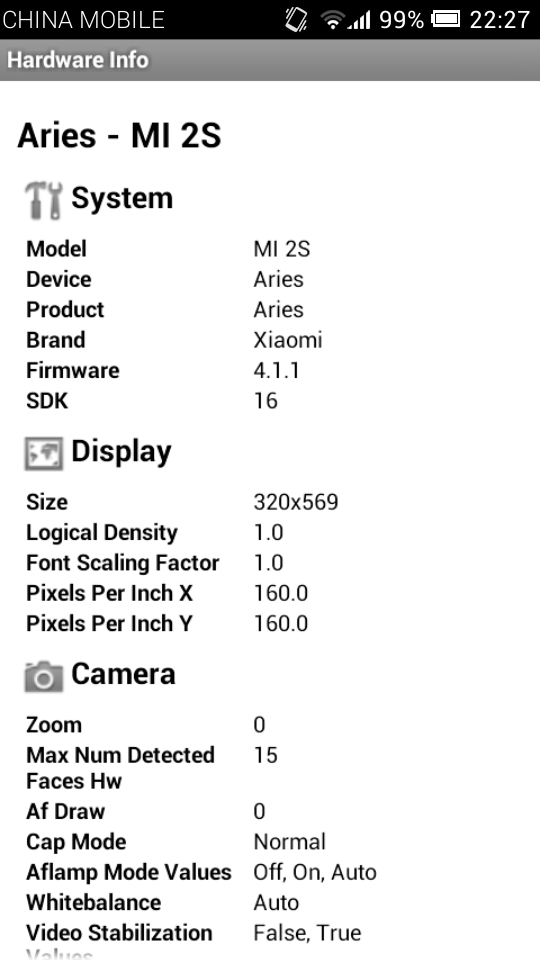

This the screenshots from Hardware Info. Let me know, if you also need the rest of the screenshots (it's 8 in total).

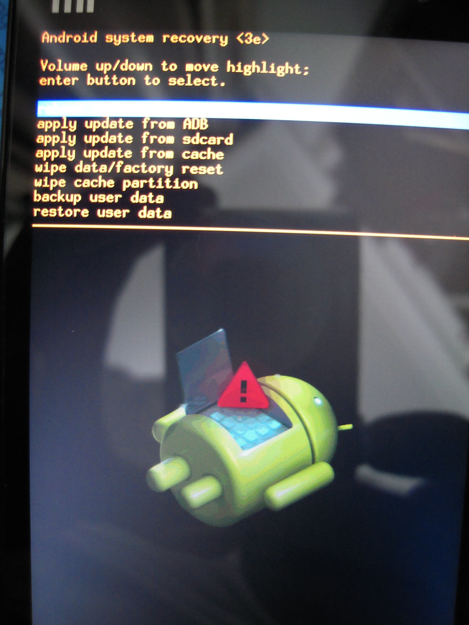

Also please see how the recovery looks like. Can I also do a backup from here (it is shown as an option)? I tried it and it is now visible in the root folder of the device.

Sorry its a fake. The recovery is standard android and not mi recovery.

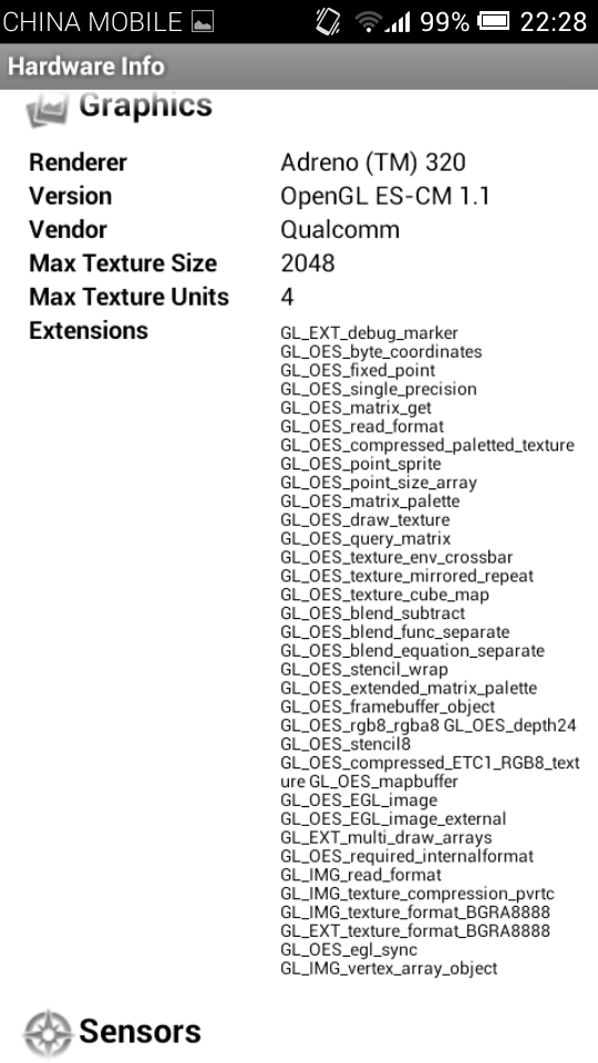

F*ck any other opinions? Cause I have a textual recovery, yes, but at the same time I have a Qualcoom CPU, Adreno GPU and a registered IMEI...
no you don't info showed in the recovery are false, you have a mediatek cpu and a powervr gpu i'm sure there's a thread about it showing a disassembled fake model.
Sorry for your bad luck try to get a refund
This is so weird, cause llok at the Hardware Info screenshot...
Anyway it's interesting how even hardware info isn't reliable to find out real system specs.

No mi recovery means, fake xiaomi phone. Xiaomi phones can have original mi recovery or cwm recovery that can be installed manually (new phones comes always with mi recovery)

The textual android recovery you have proves that is 100% fake, here is some shots of a fake mi 2S
