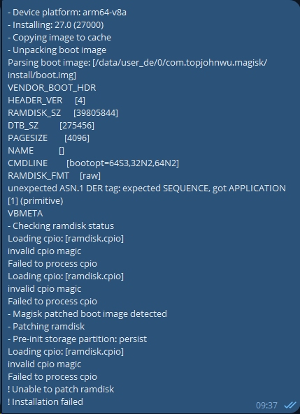

Code:
Unable to sucessfully ROOT :)
Certificate. The device cannot be rooted easily :(
