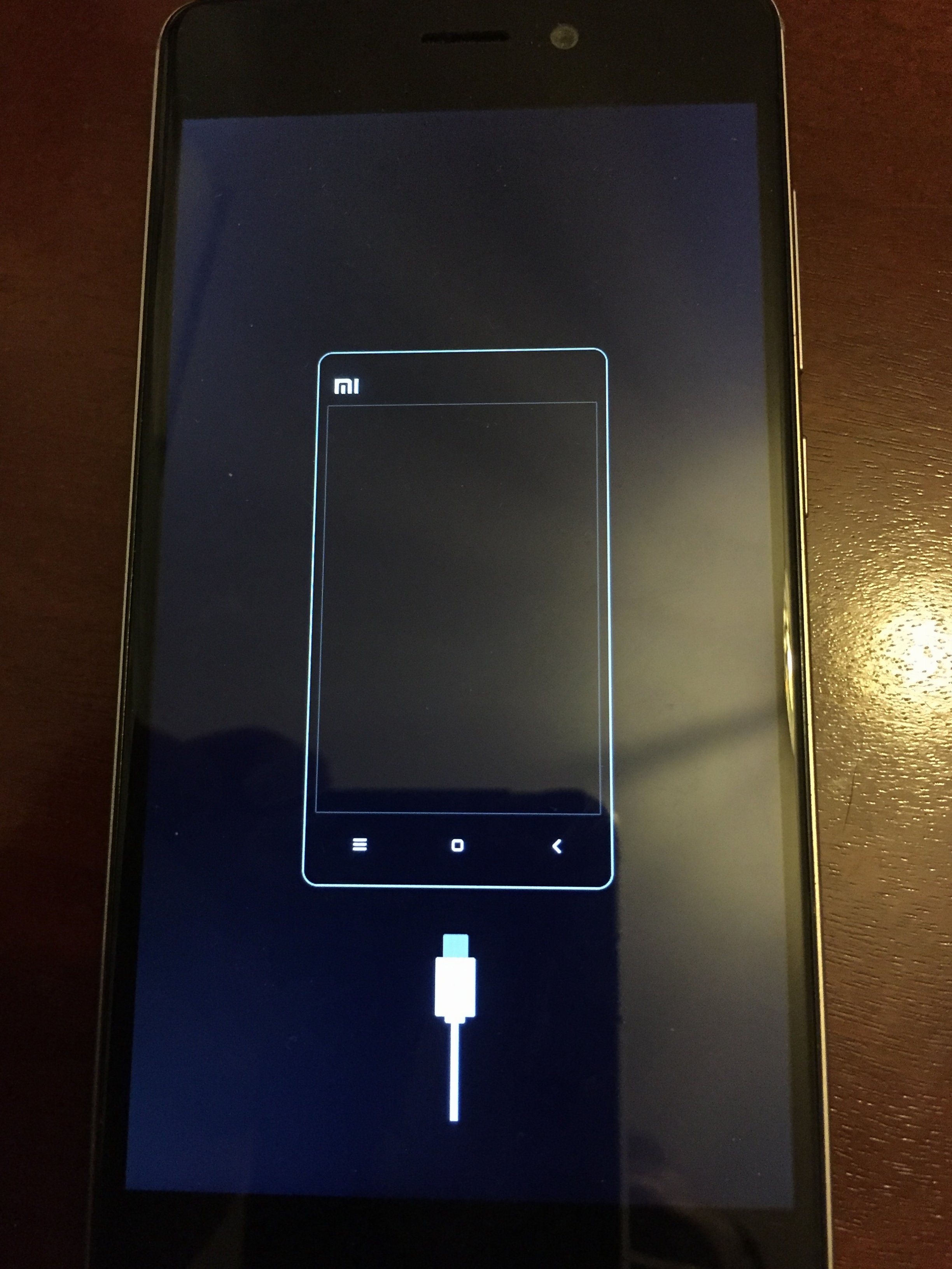

I can boot device using Volume + and Power but as I wrote in first post (vide no. 3) it brings the phone to the state with black screen, white graphics of the phone and plug. In this mode it recognizes being connected to the PC or not, however the PC (especially MiFlash) does not. I cannot simply flash in this mode.

That's weird. You don't get to this screen ?
Are you sure you're pressing only Vol+ and Power and not Vol+, Vol- and Power at the same time?

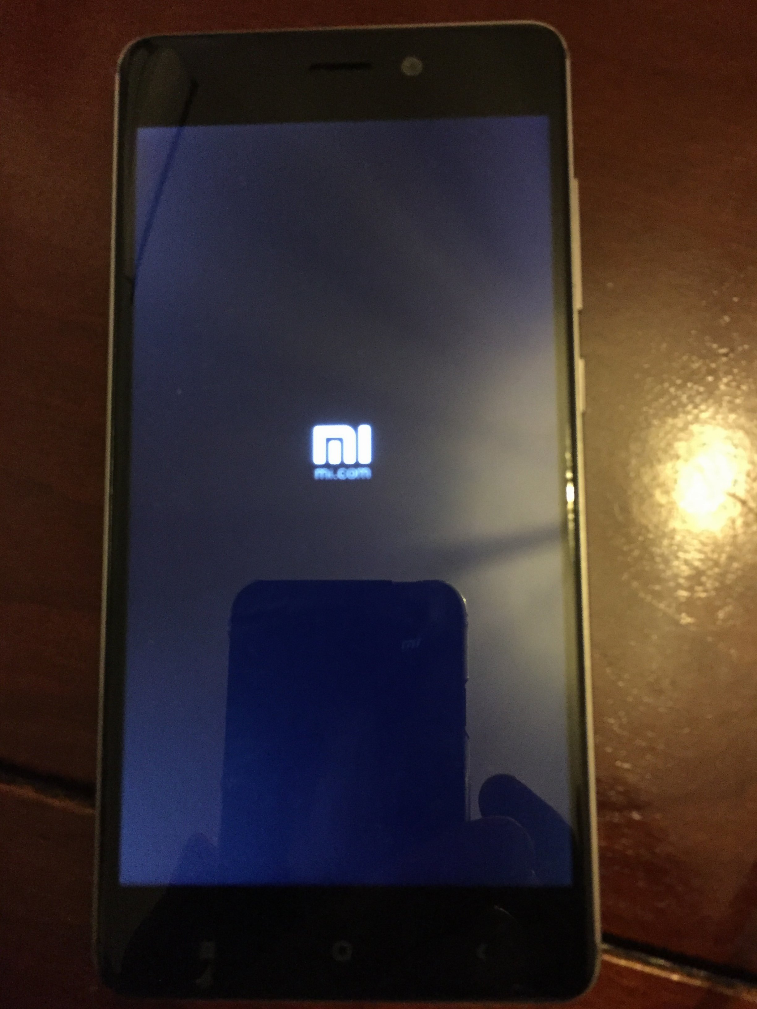

I wish I have this screen - even in Chinese :).
Attached what I get pressing Volume + & Power regardless if I keep pressing Volume + and releasing only Power after Mi logo appears (I've found this somewhere on xiaomi sites) or keep pressing both.
That's why I'm so confused, I do not believe there is no option to hack (overflash) the phone....
Not really :-(.
