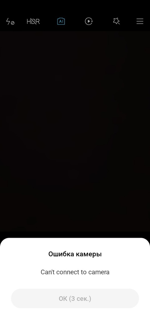

How to fix a selfie camera? or do you need to reinstall the firmware?
My zip broke your selfie camera? Impossible... o_O
Sorry but I really don't know how to help you...
"Can't connect to camera" issue is generally caused by a "broken" persist partition. That's all what I can say... ^^

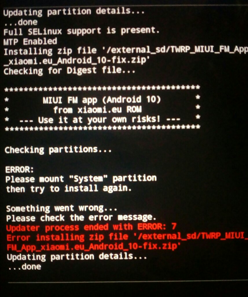

I tried but I got an error: "Please mount 'system' partition then try to install again". On the Mount menu I checked " system" but the error persists.
Sorry for the inconvenience.
What's your TWRP version? Anyway I know how to fix that, I will reupload a new zip version. ;)
The last official version for redmi 8.
3.3.1-1
