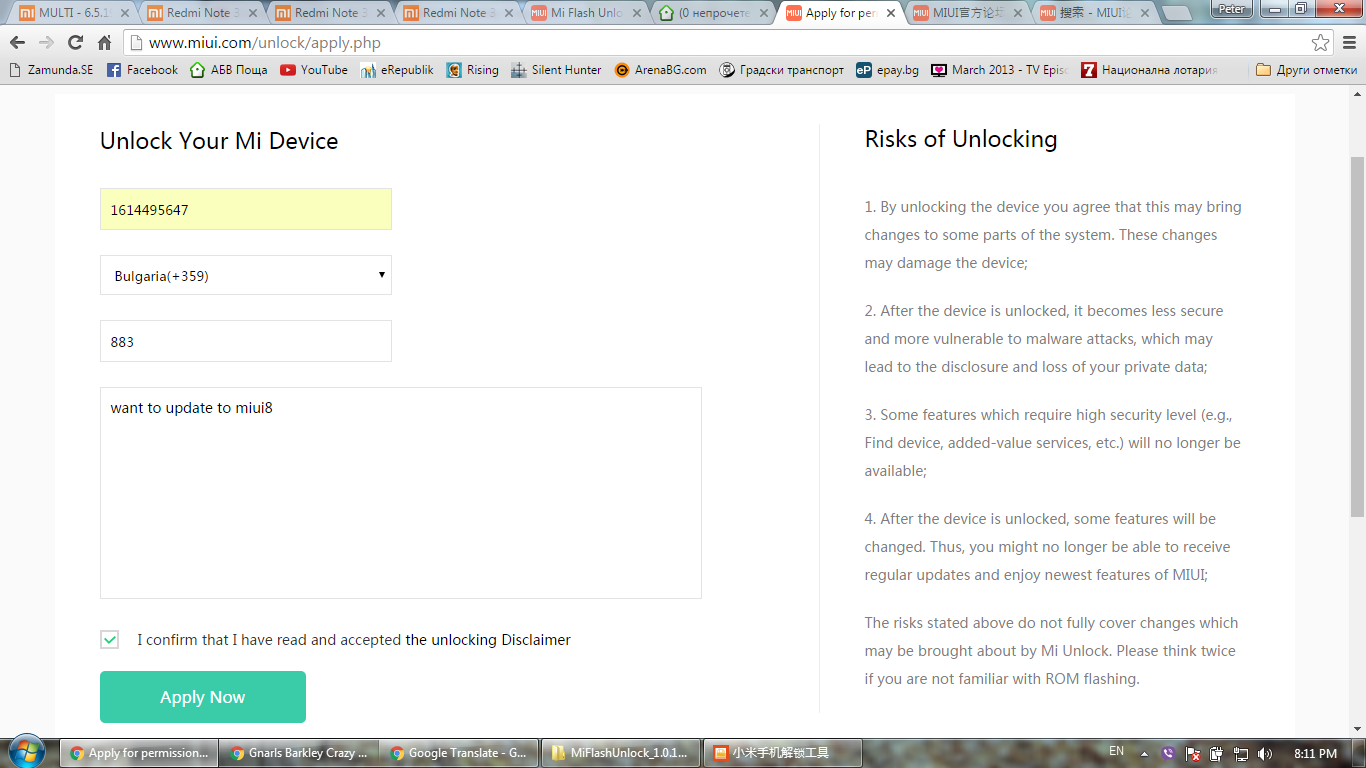

First excuse me for posting here, but problem is related to this topic and i thing that there are no sense to open new one.
I have a problem with unlocking of my Redmi Note 3 pro.
My current version of Miui is:
miui global 7.1 stable
7.1.9.0.0(LHOCNCL)
when i try to unlock it by office site

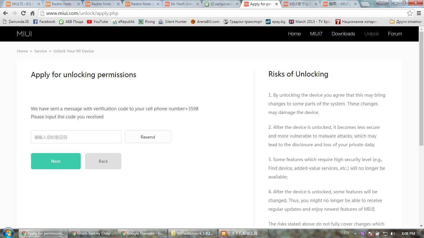

i follow step and fill all requested fields but i do not receive any sms with varification code - as attached file you could see that all field are fill with requested inforamtion - i want to make clarification for screenshot for filed "Your name" i've tried with Mi ID, my name and my e-mail, and result is always the same.
Could any one advice how to resolve this problem?( I want to update system to MIUI 8)
P.S. i've also tried to unlock phone by "Mi Flash Unlock Tool"(V1.0.1225.2)
Thank you in advance.
Best Regards,
Peter Vankov

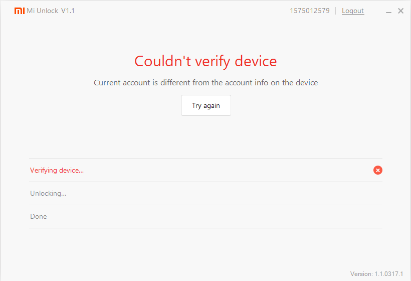

Hi everybody,
I bought a couple of months ago a xiaomi redmi note 3 pro from gearbest and it came with the 7.1.99.99 global stable version of Miui... there seem to be newer versions of this rom (the 7.2 apparently) and even if i have the permissions for unlocking the phone from xiaomi when i try to unlock and flash the phone with the official tool i get an error "the account is different from the one on the phone" obviously this thing do not let me keep going on with the flashing.
Any one got an idea on how to solve this?
thank you
A.
Hi. Perhaps your MI account is not complete. If not already, please confirm your phone number to MI account. Device should be seen under MI account as activated.
Another tip: when you try to seek for newer versions via Updater app in your phone, does it suggest any?
Hi Ivan, thank you for your reply.
I did complete my account infact on the Mi website i can do everything like locate the phone ring it and all them things... i don't know really it seem many people who bought the phone from the same online shop had a similar problem.
The Updater app do not find any other update even though i did find them on the miui website wich is even more perplexing.
any other sudgestions?
this is the message i get
when i do try to flash the phone yes i go on fastboot mode but the official tool keep reporting that error. Just FYI if you do not go on fastboot mode the official miflash tool do not even recognize the phone as connected.
I cannot post links. Please read from attachment carefully, I cannot bear any responsibility. It worked out for me, not sure if it will for you. Maybe you can consult other threads, too.
